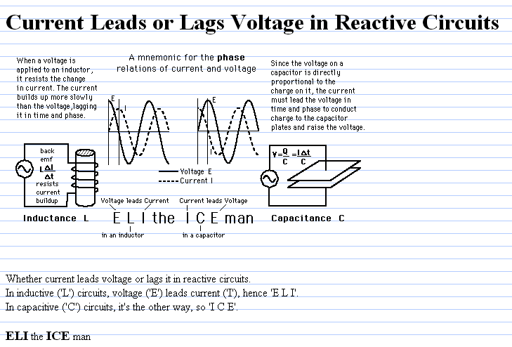

Re: Picked up a Silverface Fender Pro Reverb Head in Pieces
« Reply #41 on: December 31, 2013, 02:54:33 pm »
"So I guess my first question would be, why do we call it impedance instead of resistance?"
Because they are certainly different, and the desire is there to have different terms to accurately describe the situation. A capacitor is not a dead short to AC, it has a frequency-dependent and ufd-dependent resistance to AC. If there were no difference, we could use cheap .01 ufds as filter caps in a power supply. Likewise, we would gain little inserting a choke into a power supply if it did not act to oppose changes both in voltage and current.
We use impedance because inductors and capacitors have a quality differing from pure DC resistance, known as reactance.
Part of what makes this so is the phenomenon of current vs voltage phase angles. In an inductive (L) load, voltage leads current. In a capacitive (C) load, current leads voltage. Were you to combine both L and C in a circuit, you'd have to perform some sort of vector addition to get the equivalent resistance.
One could study this at great length, it gets wooly. Having some idea of what's going on is beneficial but not required, certainly not to NASA-levels. What's good to know is that maximum power is transferred when sources are impedance-matched and roughly level-matched to loads. I'm not going to pretend my understanding of it is anything great. But you already know your guitar cannot directly drive a speaker; a low-Z microphone usually does not drive the line level of an amplifier very well, and vice versa.
