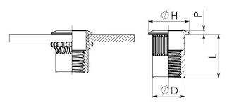

Stripping is easy if you use soft bolts or apply to much pressure
that's why I would go with steel rivet nuts instead of aluminum
#10 look to be about 4.86 mm
I like to use Stainless Truss head bolts

So 10-24 = 5mm
5mm steel rivet nuts are not difficult to pull

« Reply #55 on: September 06, 2014, 12:16:18 am »
Riv-Nuts are prone to spin in the hole.
This is not supposed to happen if the chassis thickness is suitable, and the assembler gets a good snug fit. However I've spin a few on older sheet-metal items.
#10 thread in steel is good for at least 300 pounds pull. The chassis flange will bend all-to-heck before the screw breaks. But ignore that. Four such screws will hold 1,200 pounds. Assume a 30 pound chassis. The screws will not break with a 40 Gee shock/drop.
We might like a 50 Gee rating. (50 Gee is about what a human can survive with full body-straps, such as NASCAR racers; in an amp's life it would be a bad truck-wreck or a head-on fall off a tall stage.) Then four #10 can handle 24 pounds of chassis, which covers a lot of amps. And in fact you hope your amps never get close to 40 or 50 Gee. (Transformers and speakers shear-off.)
The chassis in this thread is essentially an "18 Watt" and probably sits under 24 pounds all-up. Four #10 is ample.
SVT should be using 1/4 bolts (and a much stronger flange).

I ordered these
Material: Steel-Yellow Zinc
Thread Size: 10-24 UNC
Grip Range: .020-.130
The aluminum chassis are .09 " thick so it is well withing the grip range of the rivet nut
They have the knurled edge so they should grip good

I got the 10-24 Rivnuts in today
I installed one in some .09 think aluminum along side a clip nut
I thought I would like the clip nut better, but now I have switched over to liking the rivnut better
The rivnut was harder to install, but it is locked down tight once it was installed
i had to grab the rivnut with a pair of vise grips to keep it from spinning while you crank down on it with a 10-24 bolt
The rivnut needed a 19/64 inch hole
The clip nut needed 11/32 inch hole in order to make it sit flush against the surface
Here's a pic of both, side by side
You probably shouldn't do it that way; even the least little spin will weaken the serrations which prevent spin in use.
EL34 - No, I only grabbed the smooth upper part with a vise grip, not the lower serrated section.
You can see one of the teeth marks
The only only way to keep it from spinning is to use a large levered tool that pulls the bolt head like a pop rivet gun would

I grabbed the upped smooth section only with the vise grip
Here is a close up
You can see the tooth mark where I grabbed it with a vise grip to keep it from spinning while I cranked down on it with a hex head bolt
It collapsed fairly easy once I had a grip on it with the vise grip
The correct tool would only pull the bolt head like a pop rivet gun, but I don't have that tool
Most people that install these will not have the real tool either
« Last Edit: September 13, 2014, 07:19:24 am by EL34 »

I don't think I explained how I installed the rivnut very well
I did use a bolt and washer to compress the rivnut
I only used the vise grips to hold it to keep it from spinning.
You can't turn a wrench without the rivnut wanting to spin
Once the rivnut compresses a tiny bit, you don't need the vise grips any more because the rivnut starts to dig into the metal
Here's a picture showing how I compressed the rivnut
The allen head bolt was fine and the allen wrench had plenty of power
A hex head bolt and wrench or socket would have even more power
