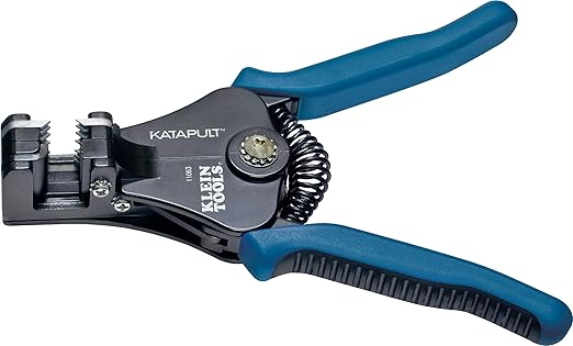

Yes I like to use teflon too. Works really well and you can get the connection right up against the insulation. i built the last amp using teflon. But I had a lot of trouble stripping it. The insulation is realky thin.  How or what tools did you use for stripping. I tried using many variety of wire strippers and ended up using the klein tools katapult stripper.http://ecx.images-amazon.com/images/I/81RoDmzzZRL._SX522_.jpg
But sometimes I noticed the insulation would somewhat shear and only half of the insulation would come off.  But that's not that big an issue since I can carefully cut the other half off.
Otherwise I tried a regular wire stripper for really short wires as the katapult won't be able to grab. So I just nicked the wire a bit and pulled the insulation off with my fingers since whenever I've tried pulling it off with the stripper it nicked the wIre.
so Sluckey,  do you even use teflon for the heater wiring? I tried that once but gave up.  The insulation was waaay to slippery  but I used it for other interconnects.

Those strippers are fine unless you are working short pieces or in tight corners. I use a simple red handled Klein stripper available at Lowes. Sharp is the secret to stripping Teflon. Forget about even trying those "V" notch type strippers!
I use the same red handled Klein stripper. They work great. With the Teflon I cut the insulation, then I slide it off the wire with my fingers. It seems to work easier that way.
I bought a pair that I use ONLY for my amp builds, not for anything else.
I have a pair of the katapult strippers but with the teflon they do leave a little bit of the insulation. They work better for me on PVC covered wire.

Thanks.  Here is the link.http://www.kleintools.com/sites/all/product_assets/catalog_imagery/klein/11063w.jpg
