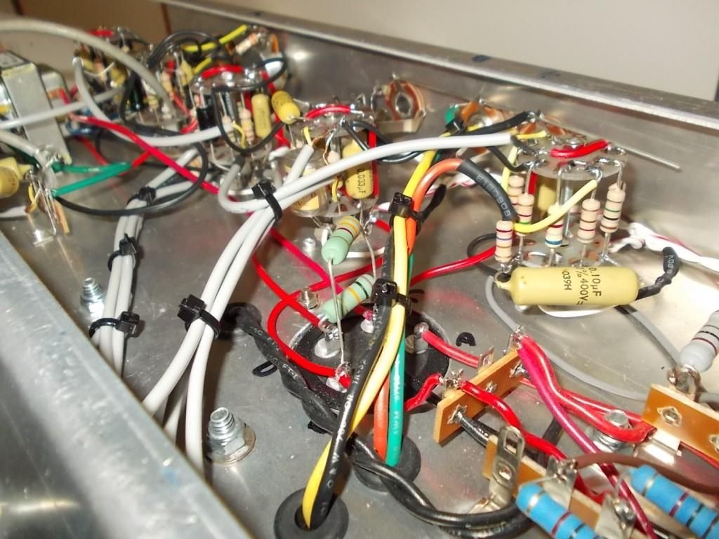

I built a couple copycat Sunns back in the late '60s. They were true point-to-point. All my recent scratch builds have been with a board. Boards are much easier to work with, especially when replacing components or making modifications. True point-to-point is difficult to work on. You run the risk of breaking a tube socket pin every time you replace a component. Reliable connections require the component leads to be wrapped around a tube pin or terminal strip lug. You can't just poke the leads through a terminal lug and then fill it up with solder. Many times you may have to unsolder several component leads just to get to the one you need to replace. You must work carefully and slowly. Very time consuming if done right. That's why so many jake-leg tv shop techs just clip a bad component , leaving enough lead to attach the new component with. That really looks bad and shows a lack of pride in workmanship.
I own several point-to-point amps that I have restored or done major conversions on. I didn't design the overall layout, I just adapted my circuit to work with the existing general layout. My latest project, a Hammond AO-63 conversion, is the most complex conversion I've done. There are major changes in that chassis! Took a long time to clean off the tube sockets and then lay the new circuits in. Take a look...
     http://sluckeyamps.com/hammond_2/hammond2.htm
And here are my other point-to-point conversions or restorations. The Magnatone was just a restoration except that the power supply chassis was stripped and redesigned to incorporate two dual cap cans rather than a single quad can.
     http://sluckeyamps.com/magnatone/magnatone.htm
     http://sluckeyamps.com/rocky/rocky.htm
     http://sluckeyamps.com/PeeWee/peewee.htm
     http://sluckeyamps.com/hammond/hammond.htm
All this stuff has a rat's nest look. But if you look closer and compare the schematic, there is quite a bit of logic behind the layout. One thing you may notice is there are plenty of ground points on the chassis.

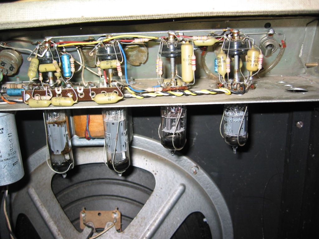

Somewhere is a picture of one of Fender's first amps, 1947?, all P2P like a radio.
Radio circuits are simpler, and you have IF coil lugs to wire off.
I think after that early amp came back for repairs, and was a royal pain to re-work inside, Leo (or White) started thinking about formica and shoe-eyelets and developed the boards we know from the 50s through much of the 60s. Certainly many repairs (crap resistors, e-caps) are quick-n-easy this way.

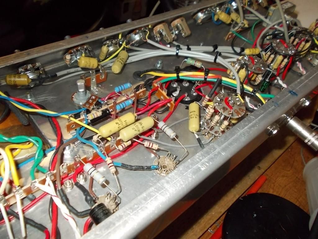

Here is my attempt.  London Power pre-amp and powe-amp.   It is still my practice amp but a bit noisy at high volume.....Perhaps a little too small a package.   .Jim

Not true PTP, but thought I'd share it anyway  :icon_biggrin:
Stereo SE hifi amp I built some time ago.

« Reply #30 on: January 16, 2017, 11:31:12 am »
... the components were soldered directly to the tube socket. ... to minimize lead length.  Just curious if anyone's ever laid out an amp using this methodology?  If so, I'd be curious to see what it looks like.  Seems you could save a lot of space. ...
Not "point-to-point" but here's a space-saving amp.  The chassis is 13.5" x 5" x 2".  During the build, I kept hearing the phrase "ship in a bottle" in my mind... Everything had to go in the chassis in a certain order to fit.  Tube socket are below the components strung between turrets.
I've got some minor debugging to do which I've put off for months because I dread disassembling the whole thing to test a method to solve the issue.  And also because I suspect fixing the issue will require a re-design of one of the channels.  Which then goes back to the gripe against point-to-point:  ease of maintenance/modification.

I remember this DaGeezer build from this forum a while back PTP.

« Reply #35 on: January 19, 2017, 03:07:28 pm »
that or faster assembly time for the soldering ladies.

Here is one that I built. It was a Bogen CHB 100, and I gutted it and used the chassis and transformers. I should have used a better chassis with a better socket arrangement, but I made it work fine. There was a wire up by the tone stack that I had to zip tie in place or the amp would oscillate no matter what else I tried, but it works and sounds great now. It is kind of a pain to work on though!  :icon_biggrin:
Greg

One more pic. The location of the LED's for the front panel in relation to the power tubes ends up blowing out two particular LED's in the string due to heat. I haven't solved that issue yet, but plan to add a fan in there.
Greg

Hi guys, This is true P-2-P OZ style.
It's my take on a "Valve Tree" a method used by amp builders in the 60's by fixing another valve base on top of another to hole the components.

I believe this discussion about settles it for me regarding the "critical aspects of layout" as applied to audio frequency's. If that amp and the other circuits imaged in this topic are able to function with low noise and no oscillations, my belief in the Mojo of "Layout" is shattered beyond repair... I've suspected this for some time but what can I say. "A picture is worth a thousand words"... Don't get me wrong. I'm all for a nice neat build, as well as not violating an obvious rule-  And that is what I strive for aside from a research project where components are ad-lib until a design is worked out.

Look at the pic in post 38,(which I'm assuming works just fine), built it exactly like the pic, when it squeals n howls like a stuck pig, you might re-think the mojo :icon_biggrin:
I'm with you though, I have built successful amps like post 38, then I mod it and it becomes a useless failure because I let the mojo out :BangHead:

Despite how messy the true point to point stuff looks, if you study the connections and look closely, you can usually see that they still follow good layout practices. The one I posted looks messy but when you look closely you can see that grounding is done to a buss with each stage grounded in order, there are grid stop resistors on each stage, grid runs are as short as possible and/or using shielded cables, etc. I also added in some extras like adjustable bias, tip pin jacks, lifted heater center taps, power scaling, and this amp uses a voltage doubler power supply also, which means more caps to clutter things up. I should have used a designed for this project chassis and layout, but I opted to use the Bogen chassis and socket layout, and it isn't ideal. The only issue I had was the oscillation that occurred until I found the optimum spot for a shielded cable up by the tone controls and zip tied it in place. The amp has been perfectly stable and working fine for 5 years now in that configuration. The only current issue is that some of the LED's burn up because they are too close to the power tubes. I'll be adding a small fan to resolve that.
Most of the vintage stuff that had PTP was lower gain also. This amp that I built goes up to around AC/DC levels of gain and does clean ok but the cleans are never as nice as a blackface fender or an AC30 or something. Its about 55 watts RMS too. I would guess that if you tried to get Dual Rectifier levels of gain this type of layout would be very hard to make work ok.
Greg
