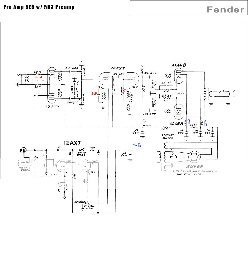

I'm working on my 5E5 Pro build and last night as I was looking at the schematic it occurred to me to wonder why you couldn't put in a switch to bypass V2A. Here's a schem that shows the two preamp tubes on this series of amps:
(Just disregard the red changes, etc. The relevant part is accurate. And I realize that I screwed up which side of the first tube gets the tone control, LOL. I just haven't updated the schematic. This mod would also necessitate a different trem circuit, I guess one of the power tube bias circuits - probably the early Tremolux)
Now, I have an old '55 Tweed Deluxe but it is a 5D3 - totally different setup. But I've played 5E3s and I do know that the most common complaint with them is the lack of headroom. My 5D3 has good low volume clean tones, but the phrase "low volume" is the key - it gets dirty pretty fast, too. Is there a reason why this mod never seems to pop up in discussions of the 5E series? I have a Weber DPTDT relay just sitting here that I could use to do the switching and there is a nice little hole in the chassis already, just waiting for something to occupy it. :) Seems like it would give you an entirely different amp with the flip of the switch.

V2A is needed to amplify the signal enough to drive the 6L6s to a reasonable power level.

An alternative consideration. You might be able to use the switching on a 5E3 with 6V6's, but I personally would not do it that way.  I'd rather switch something that gives it a clearer tone without a gain/volume drop.
You can easily parallel (or use series) with resistors and/or caps to change the tone & headroom.

Well, you guys probably know best. But I'm going to try it (without the switch) once the amp is together just to see what happens with just the single stage. So the PI in the 5E series must require a lot more input than the 5D series, I guess.
Yes.
The 5D3 uses a paraphase inverter. Each triode in V2 is actually part of the PI. And each triode provides gain.
The 5E5 uses a split load PI that consists of only one triode in V2. This type PI has a gain of only 1 and that is not enough to drive the output tubes. V2A is an amplifier stage just prior to the PI and it provides the gain needed to drive the output tubes. Many people consider the V2A amp to be a necessary part of the PI. I just think of it as a gain stage. The net results are the same.
No, I guess a gain of 1 wouldn't quite be enough.  :laugh: I didn't realize it was so low; Thanks.
Tubenit, thanks for the schematic of the "more headroom" version. Coupling caps, coupling caps, coupling caps. I always seem to end up using lower values than stock Fender so your idea fits right in with what I like.

If you're looking for more 'headroom' in the schematic at the start of this thread, how about replacing the driver/cathodyne altogether with a LTP? (You could even go to fixed bias as well)
Since this is very similar to a 5E3 preamp and we are talking about more 'headroom', I'll ask the same question that I asked elsewhere today:
-Has anyone seen on a scope (or know by other observations) which breaks up first in a 5E3, the driver before the cathodyne or the power tubes? (Seems like it wouldn't be the input preamp or cathodyne???)
Without knowing this I'm not sure how to get a "more headroom option" in a 5E3 that I'm about to build.
