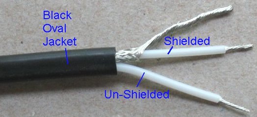

Hi Jack,
I would say yes, the reverb fsw needs to be shielded. It's going to/coming from the grid of 1/2 of v2. So when it leaves the shielding of the chassis it acts like an antenna, plus it's long. Fenders are the same and need shielded wire for the fsw because their grounding the grid to kill the verb.

I'm beginning to wonder if part or all of the footswitch cable needs to be shielded.  Is there something like a co-ax 3/C cable that has individually shielded leads?
BINGO! Doug has what you need. That reverb circuit needs the shield. Trem circuit doesn't. You could also just get a standard Fender two button FS. Doug has that too.

So, I can use the cable shield as my ground  for each?  I only ever used a cable shield as just a shield.  And, the shielded conductors as the signal wires.  I don't think that I've ever tied a shield to something on both ends.  This will be a new experience for me.  I just placed an order for the Fender 2-button footswitch.

So, I can use the cable shield as my ground  for each? ...  I don't think that I've ever tied a shield to something on both ends. ...
Yes. It's connected to ground inside the amp, and acts as the ground point for both trem and reverb footswitches inside the footswitch box.

Ok.  Took the time to install the footswitch (thanks, Doug).  I unsoldered the plugs from the ends of the wires, and soldered them to the appropriate points.  Warmed the amp up, and tested the switches.  Hum is still there, though I think it is a bit lower.  Still disappears when the Reverb is grounded by the switch.  Tremolo is still very hum free.  Still sounding good.  Reverb still sounds very good, when on.  Amp sounds really nice.  So, back to the schematic for more troubleshooting.  I'll walk away from this one, until next week.  Need a little thinking time.  The footswitch is a keeper.  It goes very well with the amp.  I'll report back on my next de-hum attempt.
