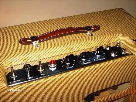

My next amp is the 5E3 Deluxe
I found this on the net
http://online.physics.uiuc.edu/courses/phys498pom/student_projects/fall04/james_milsk_gabe_jacome/james_milsk_gabe_jacome_modified_5e3_deluxe.pdf
They modify the circuit  [ James Milsk and Gabe Jacome ] Dec 7 2004
Add resisters do a feedback and remove a grid capacitor
Use a 12AX7 for a 6v6
and a stand by switch
Is this a good step

Offline supro66
  • Posts: 525
Re: Modified a 5E3
« Reply #3 on: November 15, 2010, 07:34:01 am »
That is why I am asking the PROS
I think the standby switch is a good idea ??????

Offline supro66
  • Posts: 525
Re: Modified a 5E3
« Reply #9 on: November 15, 2010, 09:33:34 am »
Is this a good step
You may also consider more modern board designs. Doug's version is fine, you may modify it as you wish, but when used in an original tweed chassis, the B+ bus comes much too close to the input jacks for my liking.
You'll find below a pix of my own EVO version, with all the bells and whistles, in the same form factor as the original.
I picked up this at tubedepot
http://www.tubedepot.com/pcb-5e3-err.html
And the Chassis from you know who
Right here at HIS store
Doug has a ground switch
this has a standby switch
« Last Edit: November 15, 2010, 09:49:01 am by supro66 »

I can't remember who's design it was, but I like the clean look of it.
« Last Edit: November 16, 2010, 08:02:19 am by topbrent »
Offline FYL
  • Posts: 2313
Re: Modified a 5E3
« Reply #26 on: November 16, 2010, 08:26:30 am »
Barry "Loverocker" Plows at Ampmaker (UK).
http://www.ampmaker.com/
Offline supro66
  • Posts: 525
Re: Modified a 5E3
« Reply #27 on: November 19, 2010, 05:10:47 am »
It look like I won it  :grin:
http://cgi.ebay.com/ws/eBayISAPI.dll?ViewItem&item=180586372052&ssPageName=ADME:B:BCA:US:1123
I now have two to build
O happy retirement  :laugh:
I am getting to old to carry
I am building two heads and two speaker cabinets
cut the weight in half   :undecided:
« Last Edit: November 19, 2010, 05:28:40 am by supro66 »

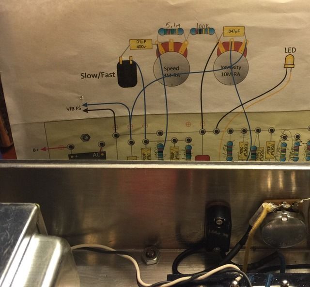

FYL - that layout is outstanding IMHO!
Thank you. Here is the template as well as a drilled board. Cap values are indicative, you may - and should - play with them in order to voice the amp.
Add a 330K stopper in the cathodyne gain stage
Can you explain where the grid stopper goes in the circuit and what it does?
The cathodyne is quite farty at high levels, with some nasty disto when overdriven. The wise old men in white with pocket protectors knew that, but didn't care as the amps were gently used by gentle players. Today is different, with full disto and overdriven amps...
Merlin was the first to suggest adding a grid stopper resistor between the gain stage and the PI itself. I did a few tests, and, yes, this trick is very effective.
"The much greater problem with the cathodyne occurs when it is itself overdriven. Because it has such a large cathode resistor only a little grid current is required to 'jack up' the cathode voltage. When driven very hard this can cause an inverted copy of the cathode signal to appear at the anode, effectively creating a sort of full-wave rectified or frequency doubled signal at the anode. This is shown in the lower photograph, and it is usually this which causes the ugly 'blatting', 'swirling' or 'grainy' sounds sometimes heard in amps using this kind of phase inverter. Fortunately, the cure is simple. We add a large grid stopper to the cathodyne, to keep this grid current in check. A value of 100k to 1Meg is usually necessary. Before you worry, this will not affect the treble response though, because the cathodyne only has unity gain! Therefore it's input capacitance is extremely low, at about 2*Cga + Cgk, which is only 4.8pF for the ECC83! This is the real 'secret' to obtaining a smooth, consistent sound from the cathodyne, no matter what kind it is. If you are using a cathodyne always give it a nice big grid-stopper. The tonal reward is startling!!! Yes I know Leo Fender didn't use any, but he wasn't designing amps to be overdriven, and this is the 21st century."
