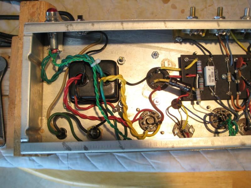

OK guys,   I have a question that is inrush current related  I'm working on 65 style Fender SE Champs & Vibro Champs.  I'm using Classic Tone PTs and I find in these builds I have some resulting audible 120hz hum . So I'd like to add some filtering capacity to the PS. I've got a factory Fender VC Schematic that shows 40uf on the first filter node off the rectifier. But I've read that exceeding the published recommended capacitance of the PS filtering is not good for the life of the tube rectifier. So I'm thinking of using some resistance between the rectifier and the first PS filter cap. I've used a 10 ohm 5 watt sand cast resister on a VC I built ins series with the first node 40uf cap and it seems to work rather well. This seems to quiet the hum a little and also tightens up the low freqs. My question is;  Is this an effective way to minimize some of the increased initial charging current?

« Reply #1 on: January 10, 2015, 05:42:17 pm »
> tube rectifier.
Which tube rectifier?
> I've used a 10 ohm
I'm not sure 10 Ohms does anything at all on a Champ.
5V4 data shows like 100 ohms per plate, way up from your 10 Ohms.
> audible 120hz hum
Champish plans should generally have an added R-C filter, unless you are building for mass profit.
  • Posts: 3226
Re: In Rush current related
« Reply #2 on: January 10, 2015, 06:30:48 pm »
Hi PRR - It's a 5Y3GT which is the stock tube rectifier for this amp. Its got around 394 volts on it.  Attached schematic. I've already built a bunch of these and currently working on two and a Champ version. I'm pretty much sticking to the schemo with some slight variations. But for some reason these last ones have a lot of 120hz hum. I'm trying to eliminate it or reduce it, and increased filtering is effective. But I am worried about using too much capacitance on the first PS filter node, and the harmful effects of charging current on the tube rectifier over the long run. So what I'm asking is, is a series resistance between the rectifier and the first 40uf filter capacitor effective in limiting the initial charging current (when amplifier is turned on) ?
I should note that convention seems to be a 20uf first capacitor. I'm doubling it and also upping the capacitance on the following nodes.

Courtesy of PRR (I saved this to my Scrapbook folder)
This should help. I've done this on my last couple, and they're very very quiet.
Do like PRR wrote.    :icon_biggrin:
A number of guys here have run into the same problem on a Champ type build and solved it this way.
The deep theory guys have explained it a number of times before.
When the tube sheets say max capacitance for a given rectifier tube it also depends on any/all resistance in the PT's B+ wind, which is not always known. More resistance limits the B+ current inrush.
I don't think it's as much how much charging current a given rect. tube can handle as much as it is the inrush current that at turn on can kill a rect. tube, but I could be wrong.
Adding series resistance, like you brought up will slow down/limit the inrush current, but a pi filter will work better.
Cap/resistor (or a choke)/cap and you've added both resistance and capacitance. 20uf/some R value (40ohms to 100ohms? or a choke)/20uF will be a better filter then 40uf alone. You could go 40uf/R-choke/20uF. Or 40uF/R-choke/40uF. The main thing is enough added resistance between the uF's to slow down the B+ inrush. A choke large enough to handle all the amps B+ current, not just the screens and preamp plates, will slow it down too.

I implemented the Pi filter and the amp is really quiet now. Works great. 6V6 plate volts are now at 359v and seems more in tune with the blackface AA764 circuit which is really want I'm looking for. The amp sounds nice when playing through it with a lot of the Champ tone.

What Willabe is really getting at is several folks on this forum built Champ-style amps, but realized that even ~4w of power through big 12-inch speakers (or a couple of them) makes a sufficiently-big racket.
Then they noticed hum, even though the amp was perfectly-assembled according to the original schematic. We eventually figured out the bigger speakers had deeper low-end response, and they were hearing hum for the first time that's present in all Champs, but which a puny 8" speaker and tiny cabinet naturally attenuate.
The answer has almost universally been to add a stage of filtering before the filter cap where the output tube plate & OT take power (in other words, the PRR sketch that John posted).
You'll generally get much better filtering of hum by adding a C & R as in the sketch, rather than making the first filter cap several times bigger. This is because a series resistor and the following cap form a divider which cuts a.c. ripple (hum) while leaving d.c. mostly-unchanged. A choke does better than a resistor at preserving d.c. voltage, but space, weight and cost may argue against using the choke.
