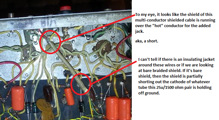

I'm going to try to add some pics
This amp has clearly been through the ringer and has had lots of work done to it over the years, but that is part of its charm ;)

Overview of chassis, notable changes (not mine):
1:  New (small to my eyes?) wires to the plates and screens, with terminal strips.  (to allow easier servicing?)
2:  Extra speaker jack, banana type
3:  Extra wires ?!  going from added 1/4 jacks (one with "VIB" in sharpie) on the back panel to the spots marked X and Y on the ab763 schematic - any idea what this mod is/does?
4:  Hum balance pot simply removed from the circuit, no pots at all in the bias supply.
Those two jacks are connected to the output of the NOR and VIB preamps just before they are mixed together and sent to the power amp. Probably simply used for preamp outputs to send to an external power amp or maybe for recording or line out purposes. Or, they could also be used to connect an external preamp into the twins power amp. None of this should have anything to do with your problem.

You mention these added jacks to "pick off" the preamp signal(s)
Jacks can, depending upon whether their built-in switching capability is used and how it is used, DEFEAT the preamp signal going forward into the power amp---or simply serve as a "pick off" or "insertion point". When you insert a 1/4" plug into your "preamp out" jack, does the amp go quiet, in other words, does that jack DEFEAT passing the signal to the power amp?
If so, then passage of your preamp signal to the power amp (eg; the "stock" configuration) is dependent upon a nice clean switch connection being made when a plug is NOT inserted into your "preamp out" jack. It's very common for that switch to get a little funky over time and require some VERY GENTLE abrasion to start working well. I would test for this condition by running a steady-state signal (could be an oscillator or a radio signal---ideally NOT you strumming a guitar) through the amp and repeatedly sticking a 1/4" plug into those jacks.
You don't really know what nominal, stock, unmodified voltage levels are on those "X" and "Y" points that are brought out to those external "preamp out" jacks. And I don't, either. As a matter of elimination of possible causes, I would strongly consider disconnecting those external preamp jacks. Shouldn't be any big deal, you have the pic you took above, make a sketch, take some notes. Should be two solder joints >>>UNLESS <<< inserting a plug into those jacks DEFEATS the signal moving forward into the amp's power section. The difference is important. If those jacks DEFEAT signal passage, everything in the signal path is suspect. If they are simply "pickoff" points, then it should not matter.
Re: Twin Reverb loss of volume and B+ voltage after faceplate replacement ?!?
« Reply #15 on: September 28, 2014, 12:03:14 pm »
DC voltage is zero. Signal voltage is zero to probably a max of 1V RMS. The jacks appear to be wired parallel to the signal path to simply pick off the signal, not to interrupt the signal. Breaking the signal path would require more wires.

Thanks guys, yes, that wire is insulated..  I don't think that particular mod is causing a problem, but I will check the jacks.

divide and conquer.
discharge caps & take resistance measurements from each PS node to ground. should be several K ohms at each filter cap.
how do you blow the OT just changing the face-plate? seems this is coincidental, but i doubt it's the OT. are the guide pins of one or more of the 6L6 you removed broken? if yes, is it possible you installed a 6L6 incorrectly?
perhaps you bumped or broke something. are/were any of the tubes red-plating? sockets OK? what's the B+ without power tubes installed and standby switch in play mode? it should be four hundred-ninety-something still, if not, it's a filter cap gone bye-bye or a short.
are you getting -54V at all pin 5 of the 6L6 sockets?
are the 470ohm screen resistors OK?
how about the 1.5K grid-stoppers on the 6L6 sockets?
So in backward order:
1:  I replaced the 1.5k grid stoppers and 470 screen resistors with Doug's parts at the time of last cap job about 10 years ago and they have held up great, haven't drifted much (all 470 read 461 and all 1.5k read 1.491k)
2:  I am getting -53 at all pin 5.  **One thing that I noticed - I get 344 at both the plate (pin3) and the screen grid (pin4) - this is not normal I don't think?
3:  I am getting 491v on the plates with no tubes, and also 491 on the screen grid!!  uggh, are they shorted together somewhere?
4:  6L6 guide pins are all good
5:  I checked the doghouse cap spots for resistance to ground earlier on but I will revisit this.
Sooo...   Safe to say screen grid voltage should not always be the same as plate voltage, right?  Must be shorted together somewhere?
with no tubes resistance between pin 3 and pin 4 of all 4 sockets is 590 ohms
This is all perfectly normal for that amp. Voltage and resistance readings are normal. The only thing separating the plate from the screen is one half of the OT primary and the choke. Both are low resistance as far as dc ohms is concerned.

If you are tired of taking shots in the dark, you can always take an empirical approach.  F'instance, start at the PT/rectifier and move on down the line if they are OK.  The PT/rectifier is real suspect anyways, with such a large voltage draw-down without blowing the fuse or melting the PT.  Disconnect a wire from the standby switch and connect a 1 ohm resistor between the switch and the wire.  Now do whatever you do to get 343V on the plates.  These transformers can put out 450 ma while barely breaking a sweat, so it would take something way in excess of 450 ma to draw the voltage down over 100V and it would also indicate that the PT/rectifier is OK.
If, instead, the current is way lower than expected, you may have a defective PT or, more likely, a rectifier that is half-wave instead of full-wave.  You're going to replace the diodes if you are at this point, so take them out and see what AC voltage is coming out of the PT relative to ground -- should be 330V to 350V on each side.  If it is significantly different, you need to devise further tests to ascertain why.  If they are normal, put new IN4007's in (don't get them hot when soldering) and see what current it puts out now.
« Reply #34 on: October 02, 2014, 12:20:48 pm »
"Lol indeed, I'm honestly stumped.  Maybe I'll do the 1x 12ax7 test again, seems like there must be a component shorted or slightly shorted to ground?  Probably something that carries pretty good voltage?  Around the PI?"
I think I would re-try this, myself, more in an effort to reset my brain. Maybe you dropped a locknut or a blob of solder somewhere where it's making a partial short. I think that is farfetched, but stranger things have happened. It's even possible that a wire cut-off stub left over from when the amp was manufactured is stuck in there, somewhere.
Maybe you need to unscrew the screws that hold the parts board to the chassis, see if you can pry the parts board a teeny bit up off the chassis --- including separating the parts board from the insulating board underneath----and see if there's a random piece of metal or the stub of a wire under there.
Does installing the 12AX7 in the very first preamp tube socket (normal channel first preamp tube which I will call "V1")  have the same effect on the whole B+, including the B+ fed to the power tubes as:
installing the tube in V3, reverb driver?
installing the tube in V6 PI?
