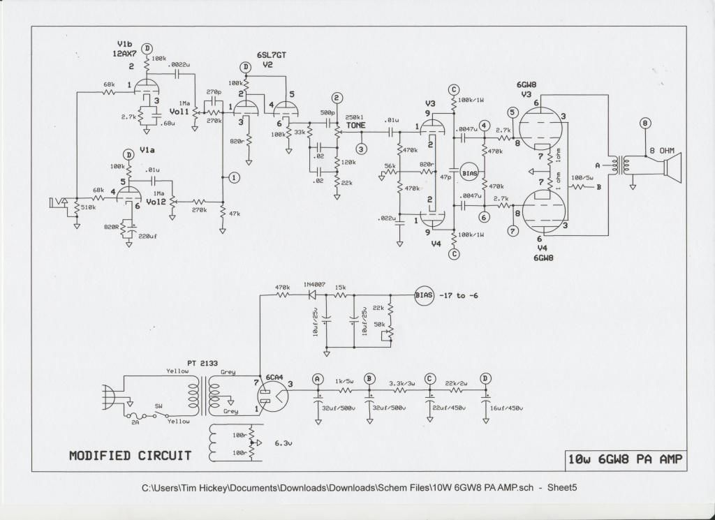

« Reply #4 on: November 07, 2016, 02:42:57 am »

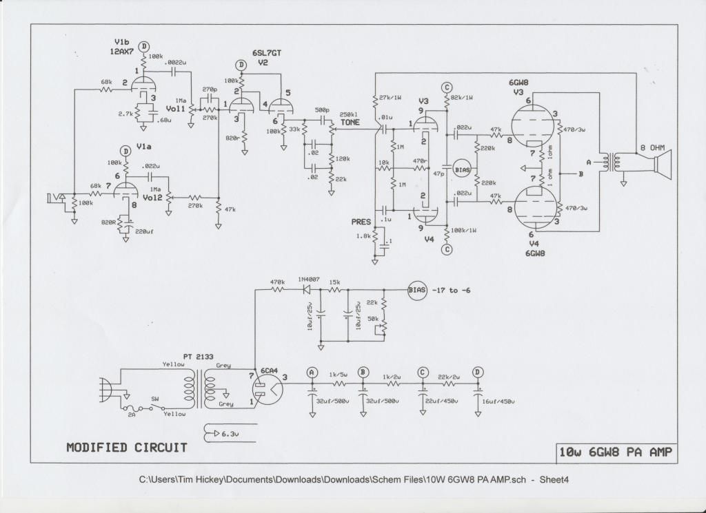

Thanks sluckey, Updated schem to be similar to your 6V6 plexi.
I've got a couple of options for the BIAS supply..
One of the old Diason amp I have uses the heater supply but its grounded on one leg, so I could use a small transformer.
OR, adapt a marshall style bias supply, but need to get down to around -10v.
  • Posts: 2928

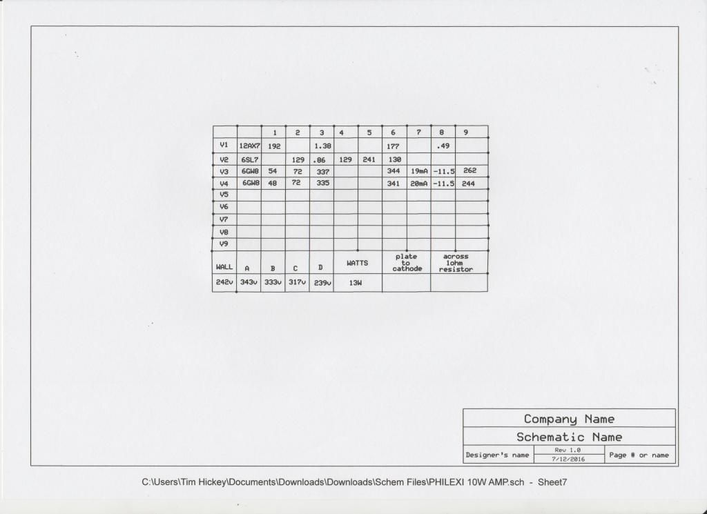

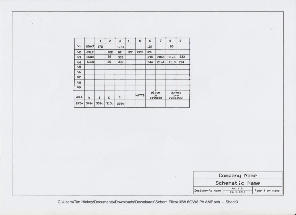

  • Posts: 2928
Re: 12AX7 - 8 pin sub
« Reply #10 on: November 13, 2016, 04:09:38 am »
hi guys, wiring finished and fired up well with only one problem.
The "TONE" isn't really working.
With the knob at "0" all is good with some good bass, but when turning up it gets a kinda blocking distortion.
Also sluckey mention that the plate and cathode resistors of the 6SL7 may need some adjustment.

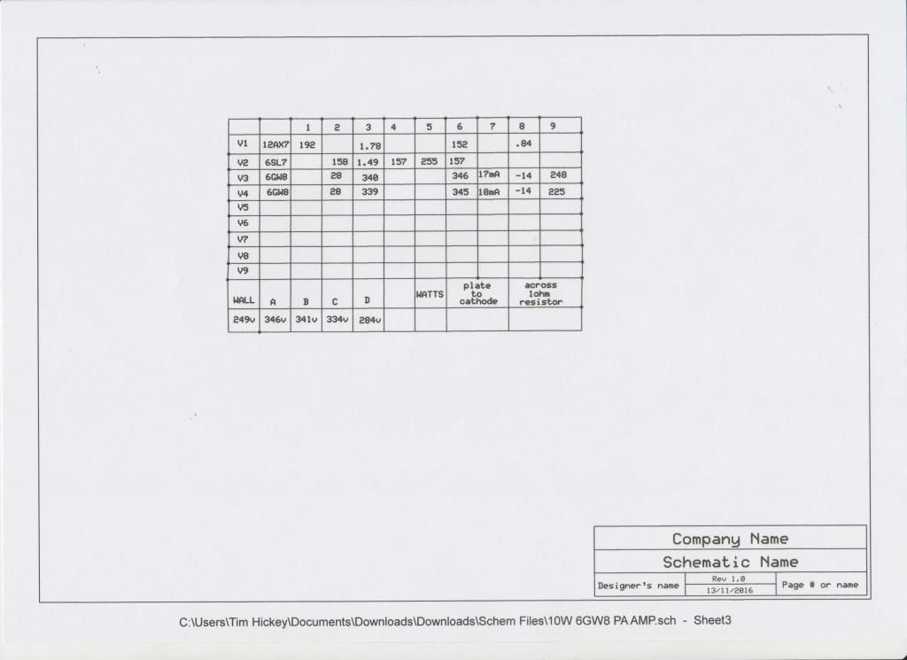

Missed voltage Pin 9 V3 - 248
                      Pin 9 V4 - 255
« Last Edit: November 13, 2016, 04:27:51 am by TIMBO »
« Reply #11 on: November 13, 2016, 07:17:13 am »
I think you need a grid stopper on your PI ... V3-1.

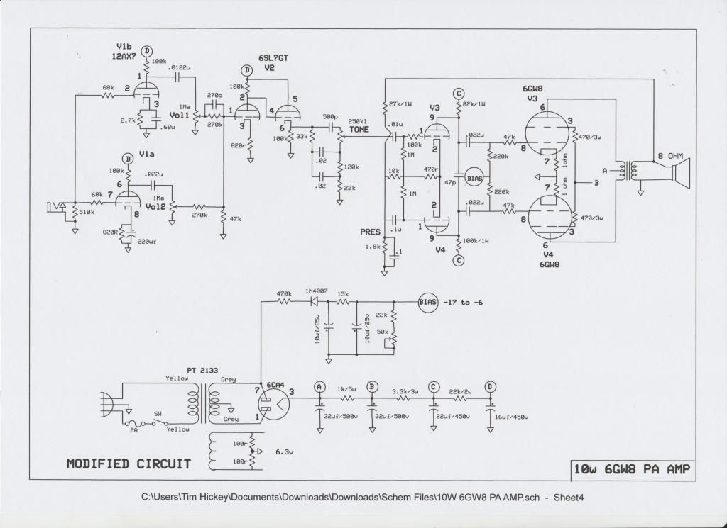

Hi guys, a bit more tweaking.
I found a schematic at diy audio, http://www.diyaudio.com/forums/instruments-amps/255890-could-use-second-opinion.html
Seems all he did was change the cathode resistor from 820 to 1.5k.
All seems to sound great, except when turning the tone pot to half way it get ugly but gets better when turned up full. :dontknow:
« Reply #14 on: November 14, 2016, 10:04:53 am »
Hmm. On DaGeezer's SoHo, coming off the cathode follower he had a 470K || with a .01 (? I think) I believe that was for frequency/tone shaping, but blocking distortion is just the audio signal getting chopped off, or something like that.  :laugh:  Merlin does an excellent job of explaining it. I'm guessing the tone pot is reacting with capacitance in some way, but I'm not nearly smart enough to explain why (or probably understand it when someone else does)
Something to try is increasing that 47k grid stop to 220k, just to see if it helps. Also, I usually put larger grid stoppers on my power tubes, anywhere from 47k to 82k. FWIW.
  • Posts: 11562
« Reply #15 on: November 14, 2016, 01:22:04 pm »
A WAG, halve, or double the 15K to ground in the TS and see if that "moves" the problem up or down the dial :dontknow:

« Reply #19 on: November 15, 2016, 02:48:10 pm »
That cap is necessary to prevent the tonestack from interfering with the bias on the LTP PI. There's a healthyb voltage on the grids of V3 and V4.
I wonder if you are just overdriving the 6GW8s?

Hey sluckey, I think you have hit the nail on the head.
I changed the cathode resistor on the 6SL7 back to 820r and this seemed to fix the tone pot problem.
Now that I have done that I'm getting the blocking distortion when I increase the volume on the amp, but I am able to increase the amp volume if I decrease the volume on the guitar.
So I have added a few bleed resistors to reduce the signal strength.
The dark channel is worse as you would expect.
I have the 6GW8s bias to 14w.
I'm thinking of increasing the 6gw8 screen resistors to 2.2k as the plates and screens are close in voltages.
I may drop the Node "D" voltage to see if that helps or even add another RC filter.

« Reply #23 on: November 16, 2016, 08:17:50 am »
Timbo, give this a try... Put a 100K resistor between V3 pin 1 and the junction of that .01µF and 1M resistor.

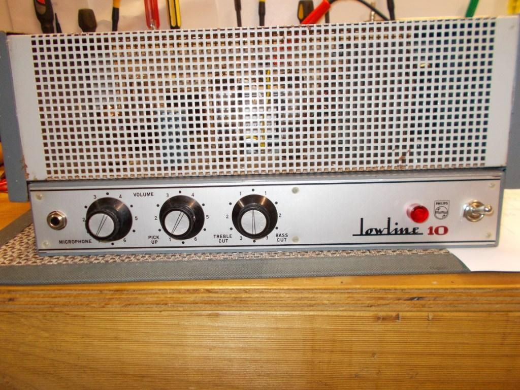

« Reply #24 on: November 18, 2016, 04:31:55 am »

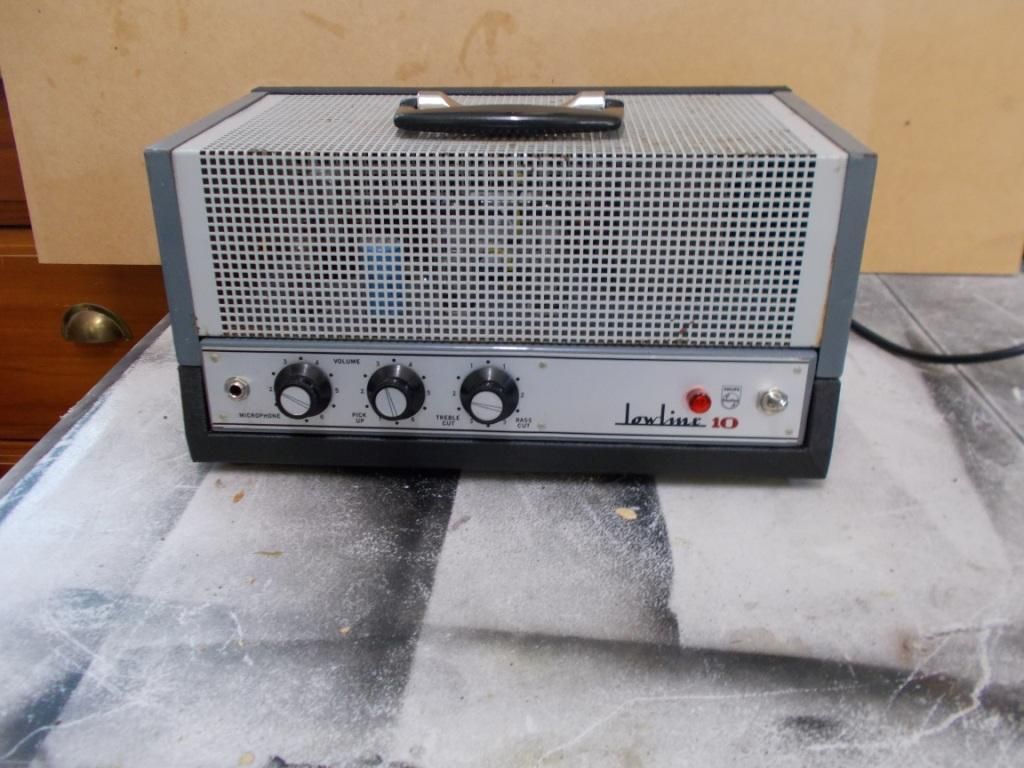

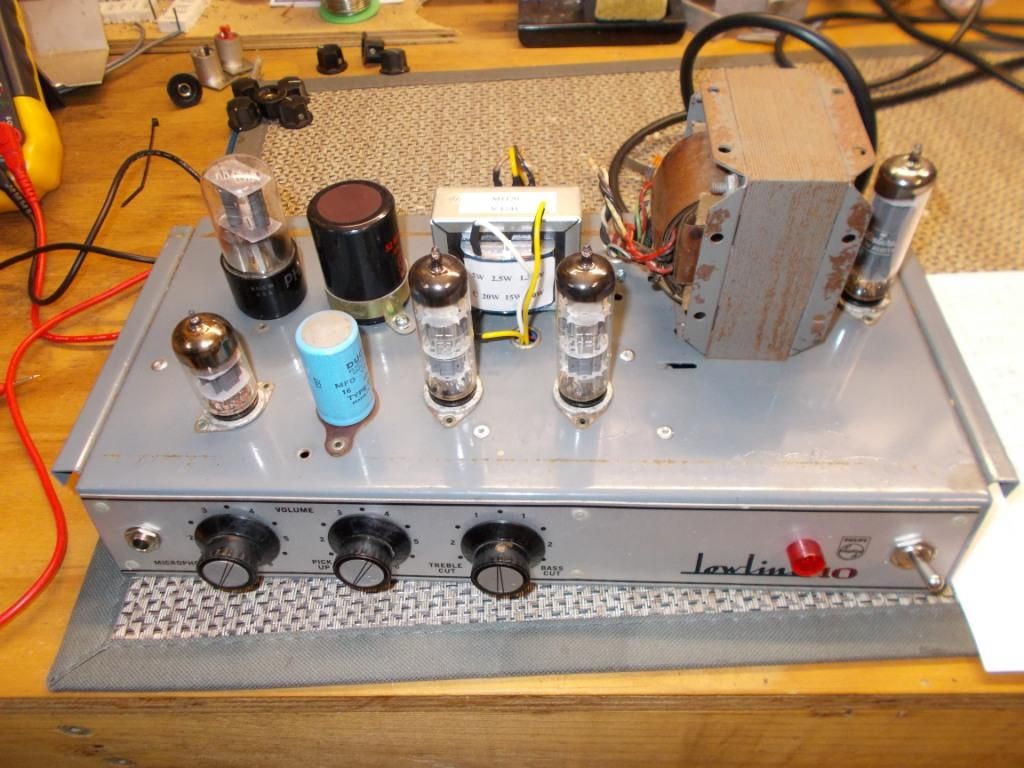

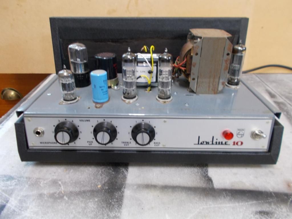

A few pics of this monster.

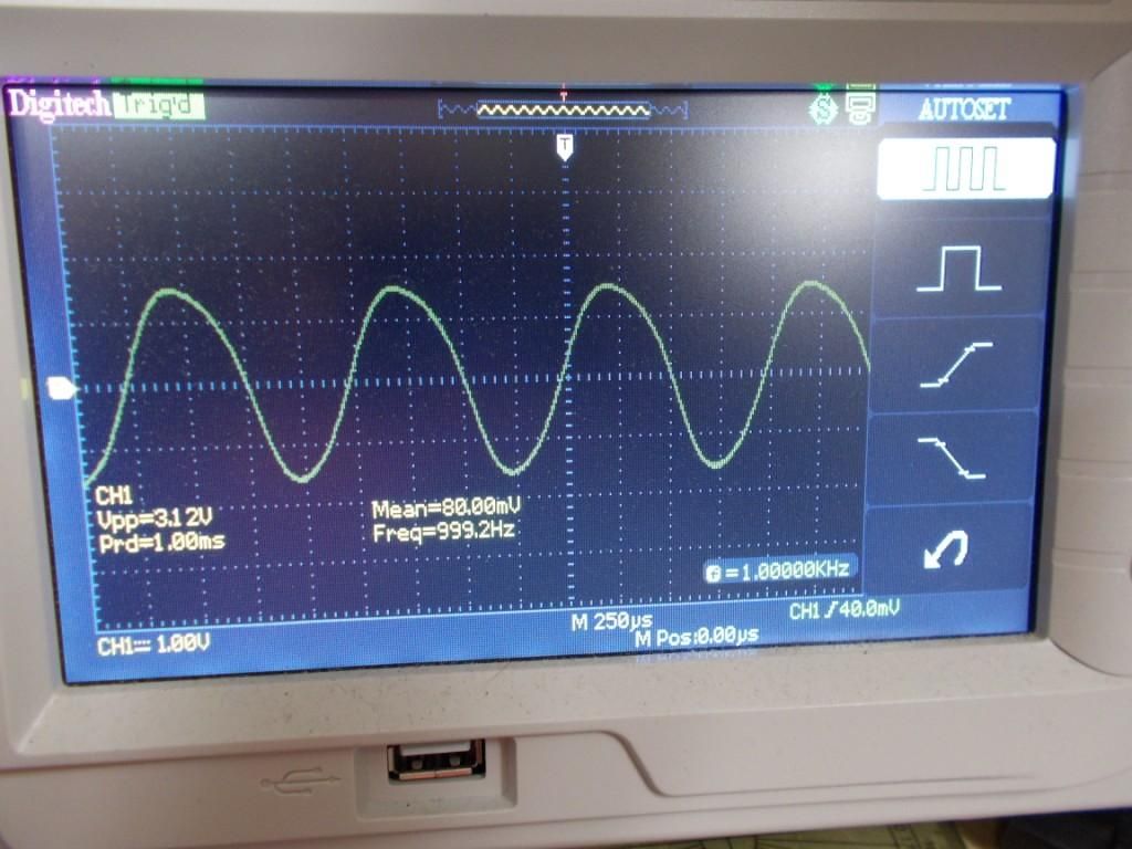

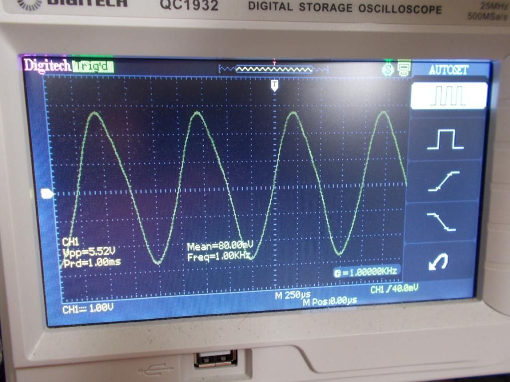

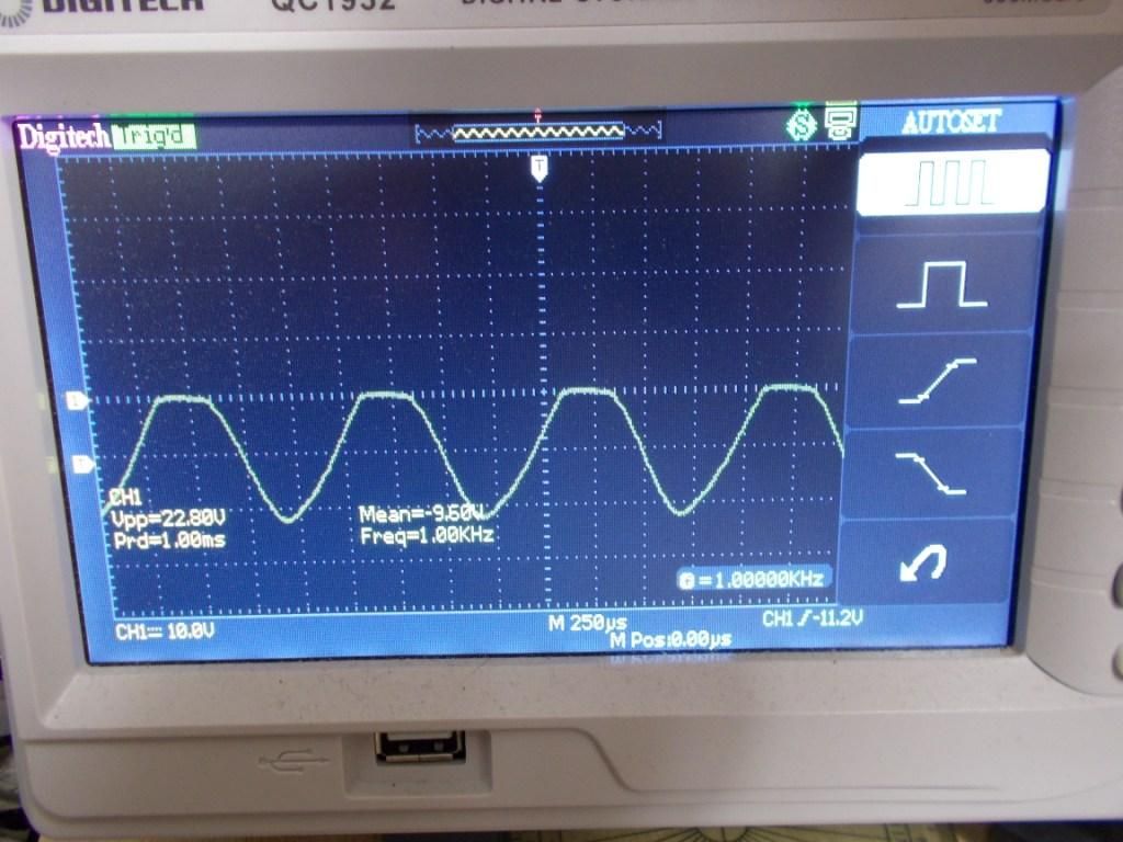

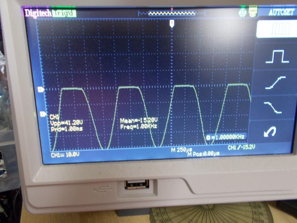

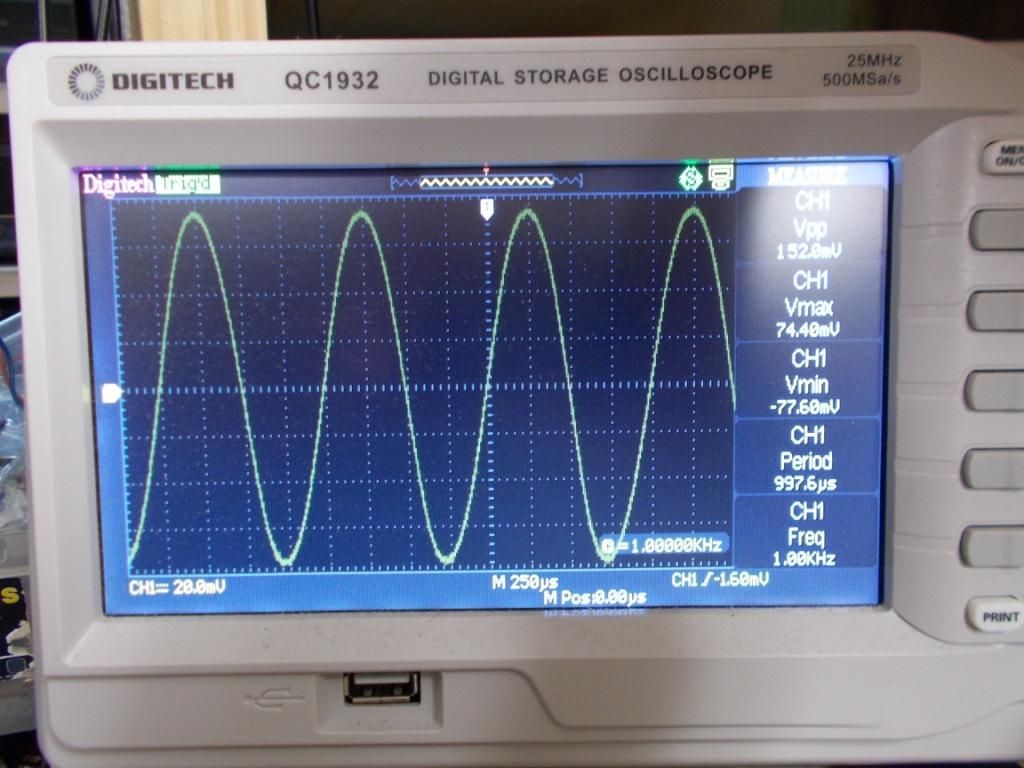

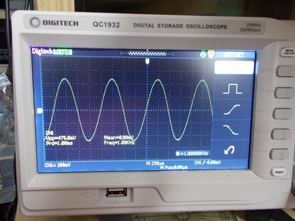

This is where I'm at...........
I measured the output with the scope and found the point that with wave starts to clip at the OT output.
This is about 2 on the volume for each channel.
Tone pot set at mid point of the pot.
TP1
TP2
TP3
TP4
TP5
TP6
TP7
TP8
Dark volume off
Bright Volume OFF

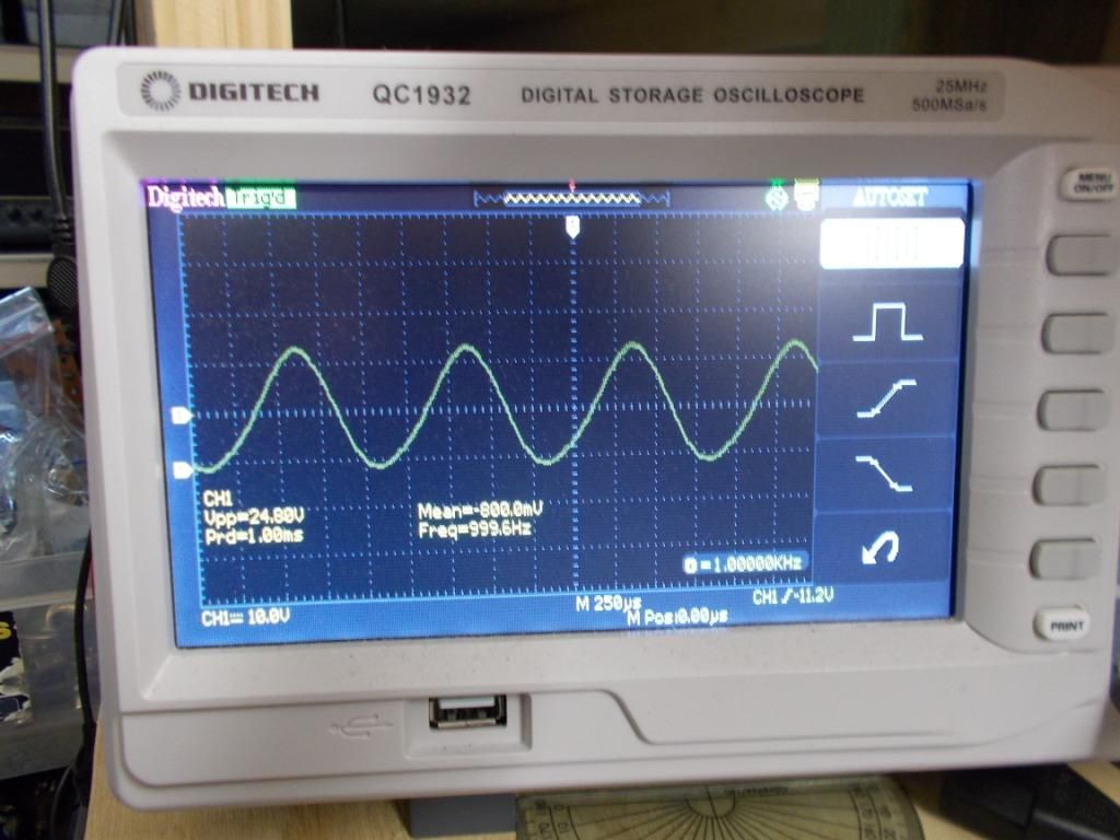

  • Posts: 11562
« Reply #31 on: November 20, 2016, 08:31:06 am »
looks like all the scope shots were from the OT?  If so walk it back, I'd start at V2 pin 2.  You might need to use/change voltage divider to "tame" the pre-amp drive.  I try on my builds to get clean pre-out til I hit around 6-7 on gain pot.
EDIT:, your PA bias tap shows -6 to -17, anything bigger than the actual bias will start bending the PA tubes,  I believe.
« Last Edit: November 20, 2016, 08:34:24 am by shooter »

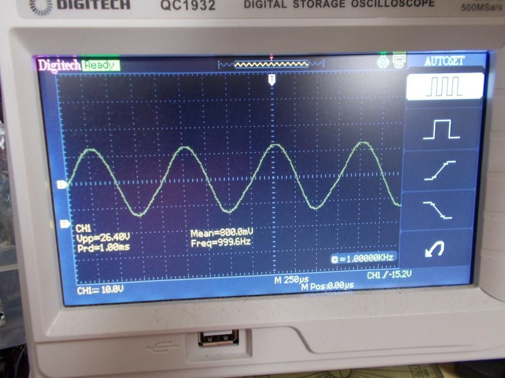

  • Posts: 2928
« Reply #32 on: November 23, 2016, 03:26:17 am »

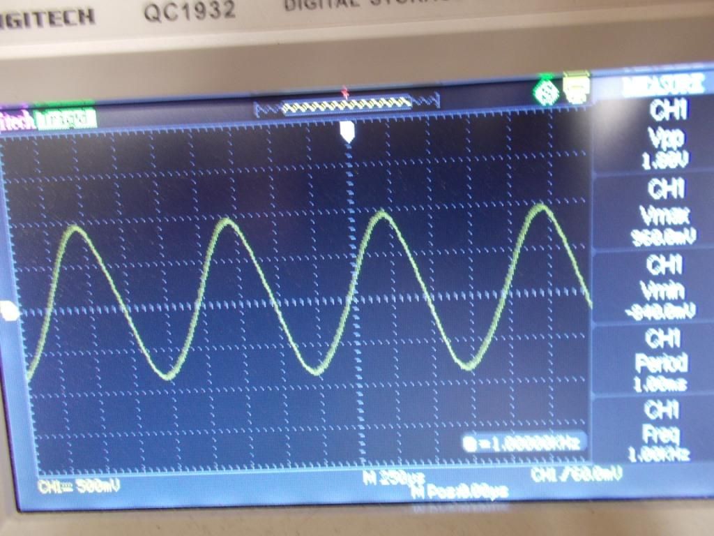

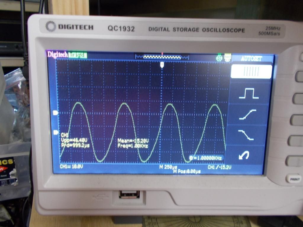

Hey shooter, The boys over here are certain that the PI is overdriving the 6GW8s.
I have now rewired the PI and output similar to the Marshall 1930.
Some new pics.
Both channels set at 1.5 on the dial, this is the point of onset of clipping at the OT output.
TP1
TP2
TP3
TP4
TP5
TP6
TP7
TP8
Dark OFF
Bright OFF
The amp still has an ugly distortion after 3 on the dial.

Thanks T, I'm trying to find someone to do a clip, but no joy so far. :BangHead:

Nice rebuild!
I have 2 amps I'd like sound clips for, I'm having the same problem here in farm country, my next best shot is FEB :BangHead:
