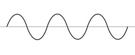

Hey all, first post here!
I'm working on designing a 50 Watt Push/Pull amp. This is my first try at amp building, and understand that I chose a pretty rough first build and probably 'in over my head'. However, I've dumped some time into this already so I'm pushing through until it's completed lol, I'm pretty confident I can figure it out.
I've been relying heavily on running simulations of my pre-amp/phase inverter through Multi-sim, and this is where most of my questions have originated. I know that from an engineering perspective guitar amps are poorly designed, and as a student I've been scratching my head QUITE a bit and summed it up as 'more art than science'. What's been confusing me is the point at which clipping occurs. I understand this is due to tube characteristics as well as the bias/'Q-point' of the said tube. The reason why it's been dragging me around in circles for weeks now is because I'm wanting to design an amp that has a lot of headroom in one circuit and have a separate circuit for overdrive. (I also understand that Overdrive is just a clipped signal) Separating the two circuits (switchable) is no biggie, my issue is due to the resulting sine wave from the output. In my head a pure sine wave (https://4.bp.blogspot.com/_6t_ZmJSkbL4/TJLFDrqFhYI/AAAAAAAACbU/BZgLx7HLP9U/w1200-h630-p-k-no-nu/Sinewave_horizontalview.jpg) is clean and has been what I've been aiming for. However, in most simulations I've been running I'm getting a severely clipped signal after the second tube (https://upload.wikimedia.org/wikipedia/commons/thumb/9/96/Voltage_Clipping.svg/1200px-Voltage_Clipping.svg.png). I know that the clipping is a result of the tube bias point, as well as the input signal; I also understand that the input signal is sweeping above the 0 Volt grid point in which the plate voltage is held constant until the input signal swings below the 0 grid Voltage point again.
I've ran multiple simulations of different bias points of 12AX7 and could obtain a clean sine wave at VERY low volume settings. The only operable design I've made that had a clean wave at the output for nearly all volume levels has been with 2 12AU7's, but I figure that this would be a bad design as it wouldn't drive the output tubes hard enough. (I guess I should have mentioned that I had a Tonestack in between these two tubes)
I figure that I am overthinking alot of this, and clipping in the Pre-amp is SUPPOSED to happen, regardless if it is the clean or overdrive channel. I even ran a simulation on the Fender Princeton Reverb AA764 and the clipping after the second tube was much more severe than in ANY of my simulations. However, I can't help but to continuously think and redesign, think and redesign.
So a couple of the questions that I have are:
Is clipping supposed to occur early in the pre-amp circuit? (As in before the Phase-Inverter)
Will the resulting (clipped) signal effect output power calculations? (I've already figured out my output circuit)
Are there are resources I can look to that demonstrates how the clipped signals will sound?
I'm sure this has been asked before, but honestly there's just so much information in this forum that I decided to make my own post. Plus, I figure I could get a little help from all the guru's out there.
Any kind of information you can give me I will appreciate greatly.  :worthy1:

Thanks guys. I suffer from a lot of brain stuff and overthinking to the point of insanity is one of those symptoms lol. As far as turning down the volume I figured that out, I ran the simulation with volume settings and I was overthinking too much about the point at which it started clipping...the simulation started at the 'pre-amp volume = 3 and master volume = 3' point. I'm putting way too much thought into this I guess.
I'm just really paranoid about designing the amp, building it and blowing the output transformer not even 10 minutes into the first jam because of some mis-calculation I did concerning the guitar signal.
However - hypothetically speaking; if you did create an amp that amplified an absolutely clean sine wave all the way through - would this sound REALLY bright and thin? Is it the clipping of the wave that gives the guitar amp that punch? Ya know, like that 'oomf' you get with an E?  :w2:
4 of the last 5 amps, I designed for 80% clean from pre, 80% clean PA, the last amp was built as a lead/distortion amp, complete square-wave outta the PA at max.  Nothing I've built, well, came from the either, it came from stitching pieces that are tried n true.
If your sim shows DC characteristics within tubes "operational range" you shouldn't make smoke, bad sound, maybe

Besides turning down the volume (which prevents clipping in both simulations and real life), what input signal are you simulating with? Guitar levels vary but 200mv is a good guess. If you simulate with a 1v input, you'll see clipping 5x sooner than you'd expect when playing a guitar through it.
Also, "audio" taper pots let about 10% of the signal through at the 1/2 setting. So unless you've accounted for that in your simulation... if you've found that you need 3/10 amplitude from the pot to avoid clipping, you can physically turn it more than halfway before that happens.
Clipping will not fry your OPT.
On the other hand, I'm not sure a lack of clipping will sound that bad... it could reduce some of the sound people usually look for from tube amps. But a lot of that comes from the signal being amplified asymmetrically, which produces even-order harmonics. This can occur long before clipping, where one side of the wave totally stops getting larger in response to a larger input.
