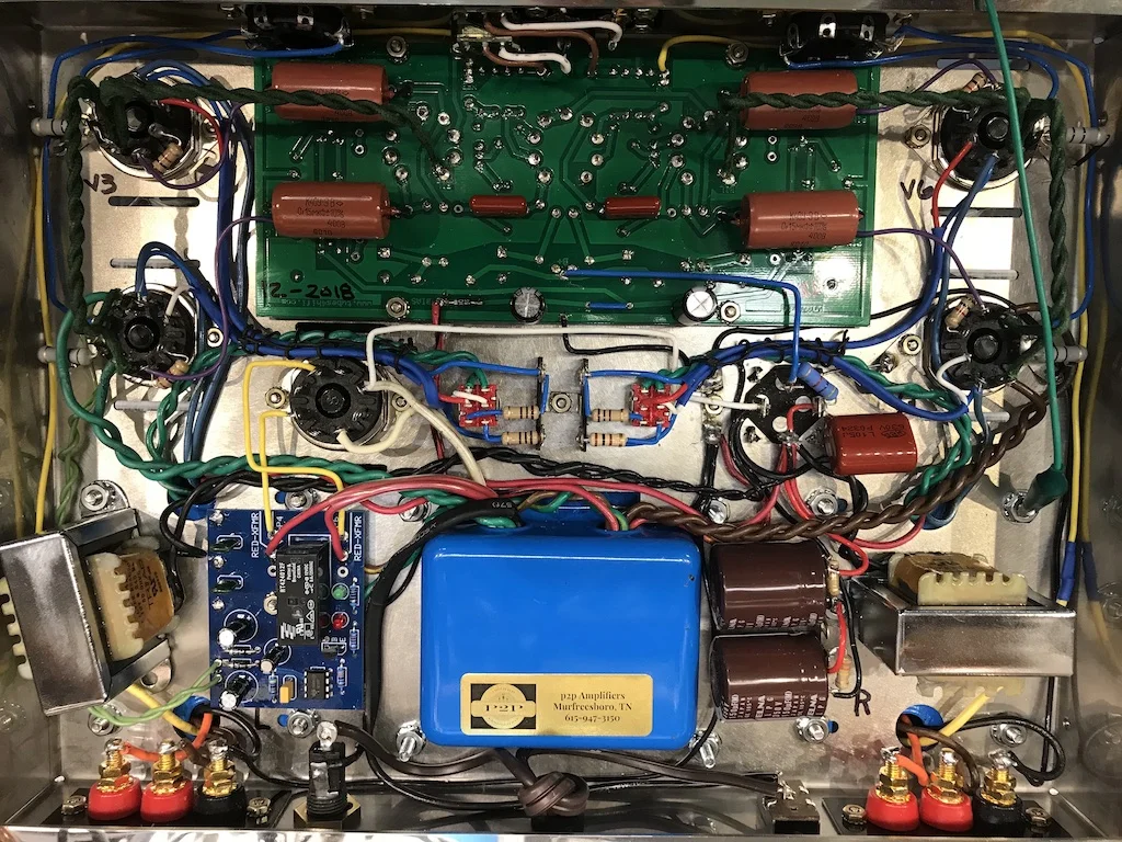

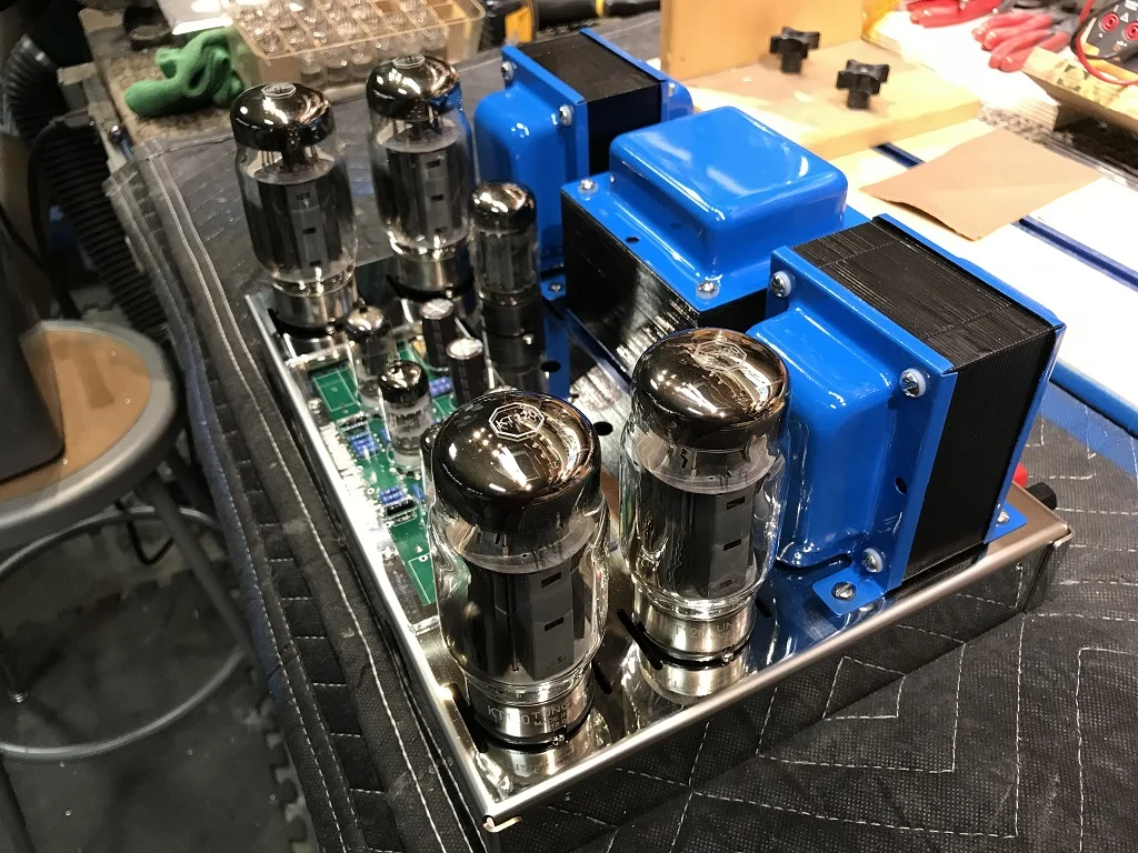

Does this count?  It's a cool ST120 Dynaco kit.  Fun to build and man she sounds amazing - KT120s just because
Everything Affects Everything
Re: Has anyone built a stand-alone power amp?
« Reply #20 on: July 31, 2020, 06:14:20 pm »
Nice!
How much power a side?  :undecided:
