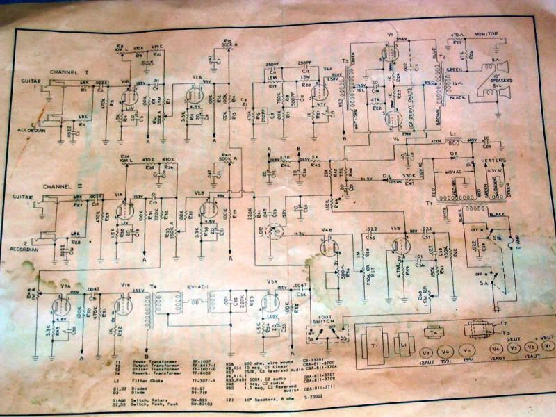

I was just given a "Model P" Wurlitzer tube amp, minus tubes unfortunately.  Someone had penciled in tube designations underneath.  (1) 6SL7, (2) 6J5, (2) 6L6, and a 5U4.  I have seen schematics for Model P-XXX, but none look like what I have.  I have searched the internet for a "Model P" with no luck.  I just wanted to see what the specs were, as I would like to strip the iron.  Which brings me to my next question...  There are some nice looking potted transformers on this thing.  The PT is huge, but surprisingly the OT is the same size as the choke - very small.  If I am not mistaken, it has just an 8ohm and a field coil out - but this looks like a Champ tranny!  Anybody know anything about these things?  Makes me wonder what records had been played through this thing over the years.  If only that OT could talk!

Can you post some pictures? They might help with determining what you have.

Are you talking about the amp from a juke box? If so werent some/most of them stereo? Maybe your missing  the other chan. which would have another OT on a 2nd chassis? Might answer why the PT is so large and OT is so small. PT feeding both sides, OT (you have) only feeding one side of the stereo? Is there some kind of jack/plug connector (like on a Hammond/Leslie) to hook up a 2nd chan? Just a thought.

I've done a few "conversion amps" and in general, they sound OK. in all but 1 I've ended up gutting the chassis, using the Iron and sockets and built a guitar amp in them and those sound GREAT.
Just my opinion here, these HiFi, Organ and Juke box amps were made to give LOTS of clean sound.
Most Guitar amps get dirty :grin:
Gut it, measure your Iron  find your HT, reverse engineer your current max, find your OT impedance, and guestimate by your HT and tube type plus physical size of the ot to determine wattage.
Find a suitable proven design to  plug in.
The Iron is always the most expensive part in a scratch build. resistors and caps are cheap.
you've got +50% of the costs of an amp there in your lap.
My guess would be that you have the right platform to build a single input, all octal, 5E3.
If you're looking to restore it to it's former glory, just test its components individually and replace everything  thats out of spec. Again, no schematic necessary.

I've only dealt with a couple amps that had field coil speakers. in both the field coil acted as the choke for the PS.
This may not be the case for you, but it may be worth checking out again.

Wait a second, if it has a choke, why would it also have a field coil out on the OT? They used to use the field coil for 2X duty as choke and instead/inplace of permanent mag. on the speaker. So why a second choke?
   Thanks,   Brad

More chokes = smaller filter capacitors, which was an issue in those days.
