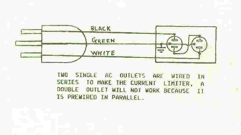

Are you using a lamp limiter on first power up? Easy to make, easy to use and could save you a lot of $ if you do have a short in your amp.
               Brad      :icon_biggrin:
A limiter will save you $$ on fuses, time AND possibly your PT (if the fuse doesn't do it's job in time) as you can quickly see if the amp is drawing too much current & shut down to find the problem, & keep doing this until the problem is corrected.
The parts can be purchased at any hardware or "big box" home supply store & should cost ~~ the same as a few fuses.
This thread has info on the Lamp Current Limiter>
http://www.el34world.com/Forum/index.php?topic=646.0
Here's a diagram Doug drew up several years ago........

That drawing is from a GW book. Notice the last sentance, "prewired in parallel" I never could figure out why he wrote that. Although, yes they come prewired in parallel,  there are 2 tabs, 1 on each sides +/- inbetween the 2 wire hook up screws that snap off. Snap those off and now they are 2 independent seperate outlets. There made that way so you can always keep 1 hot and the other on a wall switch, say for a lamp you can turn on when you walk into a room or for your bedside light and clock radio.
I used a standard duplex outlet in my lamp limiter, just snaped off the 2 little tabs, works fine.
I think he wrote that so you'd know you have to modify a standard outlet. I didn't realize sockets were prewired in parallel so I didn't know enough to break the tabs. I found out the hard way what he meant. BZZZZT!
