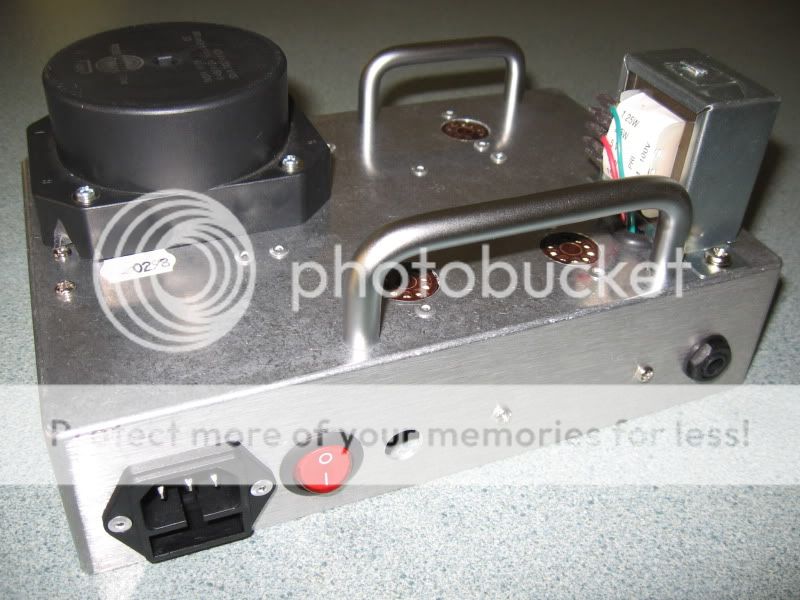

Enough talk, it's on with the construction. The chassis for this amplifier is the same one I have used for many low powered amplifiers - a diecast aluminium box similar in size to a Hammond 1550G. After drilling, filing and punching, the chassis was beaten into submission, and the valve sockets and protective grommets fitted.
Next were the tagstrips and the power transformer. The 50VA toroidal power transformer is a type used for several previous amplifiers. It has four 12VAC 1A secondaries - one is used to power the heaters, while the other three are connected in series to supply the B+ voltage, using a voltage multiplier.
The heater wiring was run hard down on the chassis from the transformer to the valve sockets, but also to tags, where hum balancing resistors would be fitted. The IEC power inlet socket and the power switch were installed on the back panel, 240VAC wiring to the power transformer was installed and exposed terminals sheathed with heatshrink tubing. An earth ( or ground ) lead was run from the IEC connector to a firmly attached lug on the nearest tagstrip.

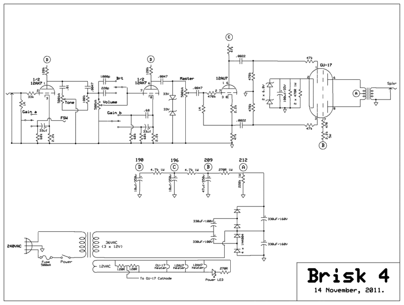

This is the current circuit of the "Brisk 4" amplifier. There is also an .sch file attached.

> you need a pretty high signal level to drive the tetrodes
Double the signal you need to each G1 with push-pull drive. Maybe a bit more for self-split losses.
> a fairly large "tail" resistor
Yes, the self-bias resistor is roughly 1/gm. For good self-split it must be larger than 1/gm.
> you have to provide a stable G2 voltage which is considerably lower than the plate voltage.
That depends on the Mu(g2) of the tubes. "Audio power" pentodes are designed to Mu near 10. This works well for audio with Vg2 nearly Vplate. MAX-current (sweep) tubes must be designed for lower Mu(g2), near 4, which leads to Vg2 much lower than a good Vplate. This also gives lower loss at high current, but that's a minor thing for audio, and not worth the trouble of extra G2 supply (unless it just falls in your lap, as with a multiplier supply).

The output stage uses cathode bias, so to seek an appropriate cathode resistor value, a 1k resistor was temporarily installed. The voltage drop across it was measured so the cathode current and valve dissipation could be calculated. The cathode resistor value was approximately halved, and halved again, until the bias was estimated to be appropriate. The final resistance was 235Ω, two 470Ω 1W resistors in parallel.
The voltage drop across the 235Ω cathode resistor was 13VDC, so applying Mr Ohm's law, the cathode current was 55mA. The cathode-to-plate voltage was 212 - 13 = 199VDC, so the total plate+screen dissipation was .055 * 199 = 10.9 watts. The dissipation per plate was therefore about 5.5 watts. The data sheet quotes a maximum dissipation of 7 watts per plate, so 5.5 watts should be about right.
The output transformer used in this amplifier is 8k plate-to-plate, with a single 8Ω secondary. The output voltage was measured at the onset of clipping, with 4, 8 and 16 ohm loads, and the output power calculated.
          Load                  Output Measured                 Calculated Power
           4Ω                             3.4VAC                              2.9W
           8Ω                             5.9VAC                              4.3W
          16Ω                            7.8VAC                              3.8W
So, with the "optimum" 8 ohm speaker load, this amplifier is able to deliver four watts. This is not a lot of power, but that was not the objective of this project. As Heinz suggested in an earlier post, running the GU-17 with the permitted 300 volts on the plates would achieve a greater output, but at the cost of greater power supply complexity.
