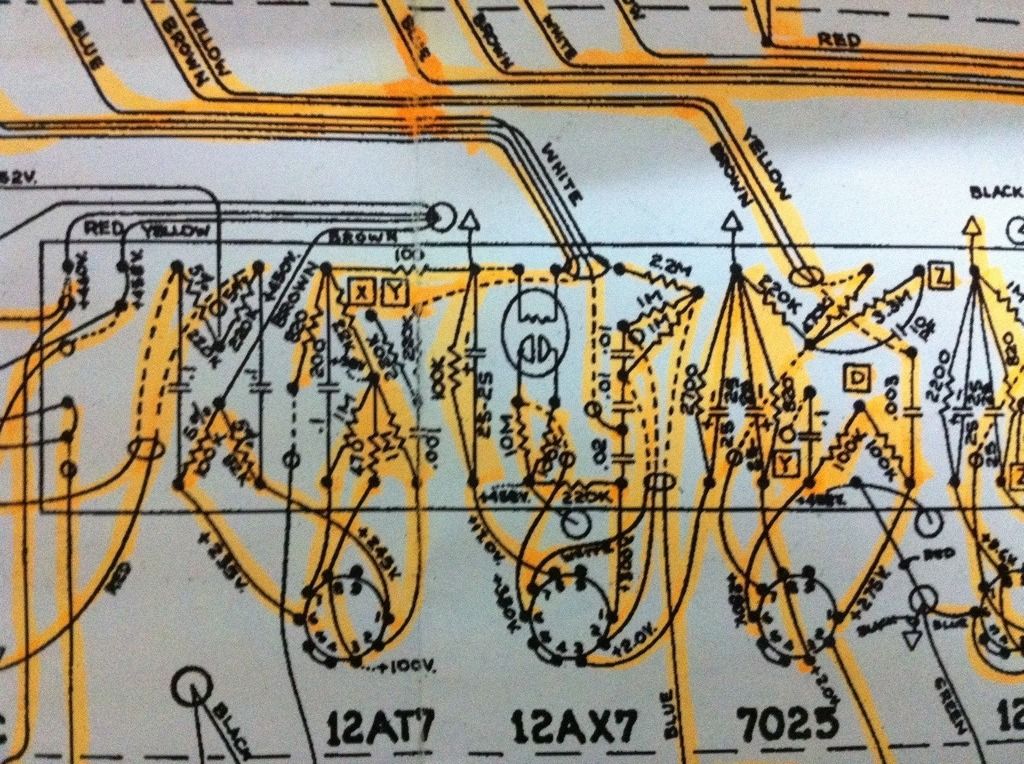

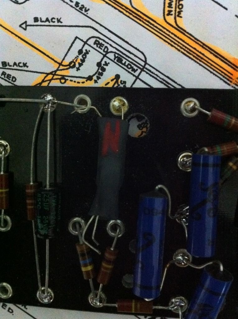

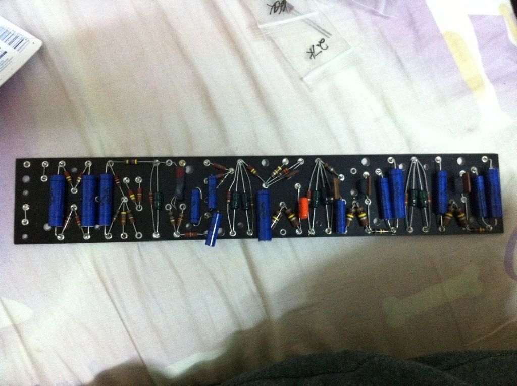

I'm repairing a near perfect (Cosmetically) 1957 Magnatone 213 Troubadour for a customer.
I ended up having to rebuild the entire vibrato circuit which had failed. I have it working but it's very intermittent. It won't work right away, but it kicks on after about 3-5 minutes. It will work for about 10 minutes and then stop.  My assumption is that it's not oscillating all the time. I replaced the (ungodly expensive) Varistors and have substituted known good tubes. I've also cleaned and retensioned the tube sockets.
This is only the second Maggie I've ever worked on so if any of you guys have any more experience with these than I do, I'd appreciate any help and insight..
Schematic:
http://www.el34world.com/charts/Schematics/files/magnatone/magnatone_213.pdf
I agree. Monitor the oscillator output sine wave at the top side of the intensity pot with a scope or analog voltmeter. There should be a healthy signal when the circuit is working and I bet it disappears when the vib quits. You can also monitor the plate voltage with a scope or analog meter. If all you have is a DVM, then monitor the plate. It will be a steady voltage if the oscillator is not working and it will just look like random numbers (constantly changing voltage) when it is working.
Check all the resistors in the osc circuit, especially the plate and cathode resistors. Maybe just replace the 3 caps between the plate and grid. If still no go, put a 22µF cap across the 1K cathode resistor. Still no go, then put a jumper across the 1K cathode resistor (make it look like the M10-A oscillator).
Hang on to the old varistors. They are probably good.

I actually tried the bypass cap first and it made the vibrato sound a little more full and it didn't cut out.  I actually did run into another problem though. When I put the amp back in it's cabinet the Vibrato would cease to function. On the bench it would be perfect.
What I discovered is that I had to bend the chassis slightly to fit in the chassis....and as this is a point to point wired amp, there were a number of components that moved when I'd do that. So I re-flowed any potentially loose solder joints, it still didn't fix it. Ultimately I discovered one of the leads to the old wax Astron .01uF cap would bend at a very strange angle. I chopsticked it and saw that this lead was barely hanging on to the cap. I replaced it with an Orange Drop and we're in business. I replaced the others too as I've had bad luck in the past with this type of wax cap.
