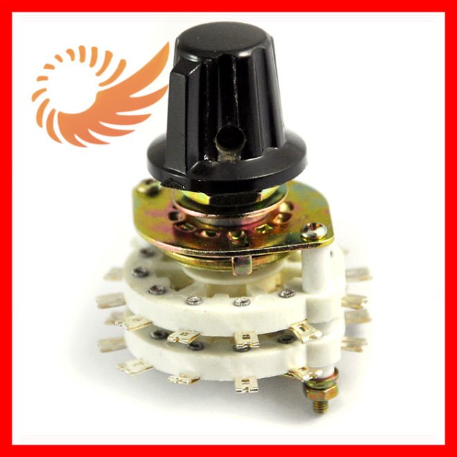

About to put all this wires in one place I think must considered that often there is a Triode pentode swich implemented
so no much difference if you add also the UL configuration
if I have  to do that I'll use a 1 way 3 position (double) rotary switch (is a 2 way 3 position) and I'll prefer a ceramic one (like in many RF apparates with high voltages)
like this one
probably also this kind of non ceramic switch can afford the needs
EDIT: The only way I can see to have it without a rotary switch in only one command is with a rotary switch acted as a normal switch like this
but don't know if it will be a safe realization
