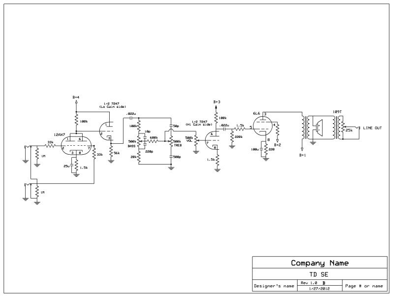

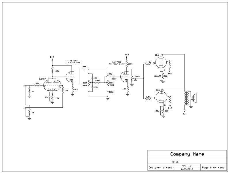

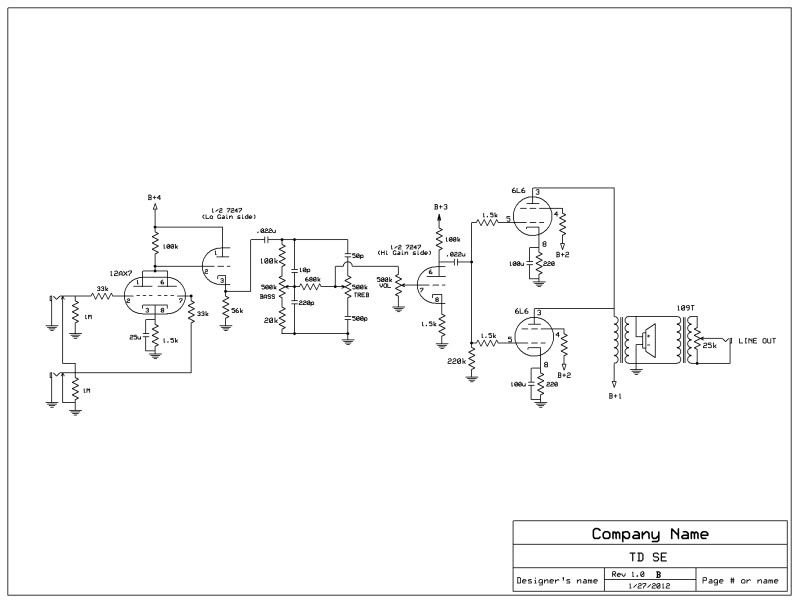

Hey fellas, I'm drawing up plans for a very small SE conversion from an old relic. Schematic is attached for your comments and critique. My question is the topic. If I don't implement it, is it much more likely to hum? Or is the feedback used more for tonal properties? My vast experience  :laugh: does not include even playing a SE amp, ever. Thanks in advance!

I just looked over your schematic,
That looks like a very gritty amp! (good IMHO)
I'm not all that familiar with the 6SL7 tube, but I am curious about your choice for Rk.
Where did you come up with 1.5K?
Shouldn't it be around 470R if your sharing the cathodes and using a 20uf Ck?
I'm really not sure about that, maybe someone with better technical knowledge can chime in.
http://www.tubezone.net/pdf/6sl7.pdf    pg.4
Ray

you need a cap from 6sl7 plates to top of top of volume control. using the wiper for a grid leak is not wise, it works, but not a good idea. if the pot fails wiper open (as they usually do), the 6V6 will be quite unhappy. you'd get more gain cascading the 6SL7 triodes, but that may not be what you're looking for. attached a .sch with the cap added.

Ray, thanks for the replies. I just pulled 1.5k outta my nether regions. I'll change that value on the schem. This is a 2-be-built-sometime thing- working on a slightly larger SE right now (slowly) using tubes I'm more familiar with. I still have to test the transformers that came with the derelict to make sure they're good, but drawing is free. Thanks again!!

DL, oops! Thanks, posted while you were,  I guess. I always forget that danged cap, and Sluckey has pointed that out to me in another schem I drew. And yes, I forgot the grid leak resistor as well. I think using something like a 1M to ground is good? Thanks again!
*edit* attached updated schem

One stage 6SL7 (even paralleled) won't bring guitar up to 6V6 level.
Re: NFB necessary in SE amp?
« Reply #10 on: January 22, 2012, 04:39:43 pm »
Good to know. Since the PT and OT both are quite tiny, I'll research some of those smaller power tubes. I was *ass*uming I could make a sortakinda Valve Jr with it something. Thanks for taking a gander!
« Reply #17 on: January 24, 2012, 05:32:01 am »
I'm probably misunderstanding what I'm reading, but it looks as though the 6sl7 has a mu of 70, while the 6sJ7 has a mu of 19 (?). Transconductance is similar, p-diss for SL is 1 watt max, for SJ is 2.5 watts max.
I never should have started this thread.... now instead of finishing my other project first I'm gonna get sidetracked by my curiosity!  :laugh:

« Reply #18 on: January 24, 2012, 07:50:23 am »
6SL7/12AT7 = 70, 6SJ7/12AU7 = 19.

Yes, I was thinking about that. Again showing my lack of knowledge, I thought that a paralleled dual triode gave more mu, but not necessarily more "gain" or distortion than a cascaded stage. I read so much stuff I can't keep everything straight, and then start these topics without checking myself.  :laugh:
Jennings, if you find that diagram that would be great! Meantime, I'll re-draw mine using a cascaded 6sl7. I need the practice.

I'm sure you'll find the 6SL7 sections are wired as separate stages, cascaded. Very likely there's knobs between to diddle the lows and highs. And of course the volume control.

I will for sure cascade the 6sl7.
I drew up a diagram by pencil as I was taking the stuff out, and for fun I'll make a .sch of it. I didn't understand some of the stuff at the time, but looking at it now I think the filament wires were grounded on one side? I'll do that schem and then let you tell me where all I've got it wrong!

Okay, attached is the schematic, taken from my hand drawn tracings when disassembling. I believe the PT is still in there with the heater wiring intact, so I will double check that part of it, but I remember being very puzzled about how the heaters were wired. In no way will I guarantee the accuracy of the schematic! I wasn't sure how to draw the on/off/bass/treble dual pot.
Like I said, I thought quite a few of the joints were not original, I'm guessing someone "modded" this before I got it. When I had looked inside the first time, there was no way I was even plugging it in, not even in a "hey y'all, watch this!" fashion.  :laugh:
It'll be a while before I dig into this, but figured I'd give you something to laugh at meantime.

Makes sense. RE-draw:
« Last Edit: January 26, 2012, 05:59:43 pm by PRR »
« Reply #35 on: January 26, 2012, 09:25:56 pm »
Ah, things become clearer. Thank you!
