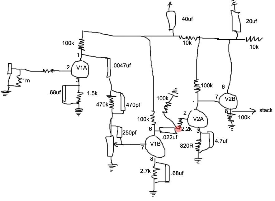

OK- I got some time to work on the amp.  I am using parts on hand to build this one, so I have a Hammond PT that I had to pad down a bit to get to close to the schematic voltages.  I have it playing ok but there is a lot of "fuzzy" distortion on the decay of notes that is robbing my joy reflex.  Its a gainy amp and I have tried numerous 5879 and 12aV7 tubes just to make sure its not a tube issue (also swapped in different ECL84 tubes as well).  I think there is some tweak I need to make here.
    I am including a few pictures of the guts- maybe somebody can spot something?  I have stuck to the schematic on this one.

This is the schematic you're using ............ correct?

Can you take a look at what I circled & maybe give a response, please?
What value is that one cap?  It looks sort of large for a 120p cap?
I'd like for this build to work out for you and have the smoothness that you want and that I think mine does.
Double check resistor values also, please.
Layout could be improved and your lead dress is your likely culprit for sure - especially with higher gain amps. The higher the gain, the more important these details become. Too many wires too close together in many places. Before redoing anything - space everything apart from each other as much as you can, especially anything close to your heaters and output tranny wires for starters. Another thing is you should mount your power tube's grid resistors directly on the sockets and the wire length should be kept as short as possible. It appears your resistors are on the board, then the wires run to your ppimv then under the board very close to other stuff especially the OT wiring? This also could be it. Run those wires over the board away from everything to your grid resistors.

The more gain, the more possibility for unwanted coupling between signal wires. Keep the circuit layout sensible so you avoid unwanted coupling. It can help to keep high-gain parts of the circuit separated for other high gain parts of the circuit by having intervening low potential wires (such as cathode resistors or wires at ground potential) in between. Avoid unwanted coupling by keeping different stages plate signal wires apart etc.
That is just the signal wires. You also want to be careful with the wires which are logical AC pairs, by keeping them twisted together, and by either laying them hard against the chassis where the ground potential 'swallows' up any stray EM field surrounding the wires, or keep AC pairs at least an inch away from signal wires (especially signal grid wires), and if its necessary to have them near each other, then make sure they cross each other at right angles in order to minimise the possibly of inducing EMF from one set of wires into another. Otherwise keep all leads as short as practicable.

OK- when I get some bench time I will go over the amp with your suggestions in mind.  As mentioned, I did only use parts on hand so maybe a few component choices could be changed.  The cap circled in the picture is a large Mica cap- it is a big boy, buts its 150pf.  I did not have a 120 that the schematic calls for.  Also, the 100k resistors leading into the master volume show in the schematic as feeding the master volume, not after the master volume at the power tube inputs.  Do I have this right?
