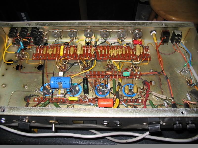

Offline bakerlite
  • Posts: 250
  • Don't forget to play it...
Re: SoLow Watt 12A_7
« Reply #14 on: April 05, 2012, 01:32:04 pm »
thats a crackin sound for blues! and at very manageable volume levels too by the looks of things.
have you posted gut shots of this amp in a build thread other to this one?
Cheers,
Bakerlite
  • Posts: 10328
« Reply #15 on: April 05, 2012, 02:32:50 pm »
The SoLow Watt was either the 4th or 5th? build in the same chassis.  I would NOT win any points on neatness even though the amp is very quiet at idle and there is no oscillation issues.
 :dontknow: :icon_biggrin:
However, here is the way it should be done. Absolutely beautiful work w/ chassis interior shots :
http://www.el34world.com/Forum/index.php?topic=13151.0
EDIT:  added a VVR version
