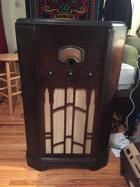

The amp sounds great.  I have it housed in a big old RCA console radio cabinet.  I replaced the grill cloth, made a baffle for a Weber Chicago 12", and built a sound-reactive LED circuit housed behind the original frequency selector faceplate.  It glows red as you play, and includes a knob to adjust the microphone sensitivity.  Too cool!

We would love to see some pics of that!
  • Posts: 5838
Re: help me understand this Dukane PA
« Reply #34 on: December 14, 2015, 08:26:57 pm »
+1
Front:

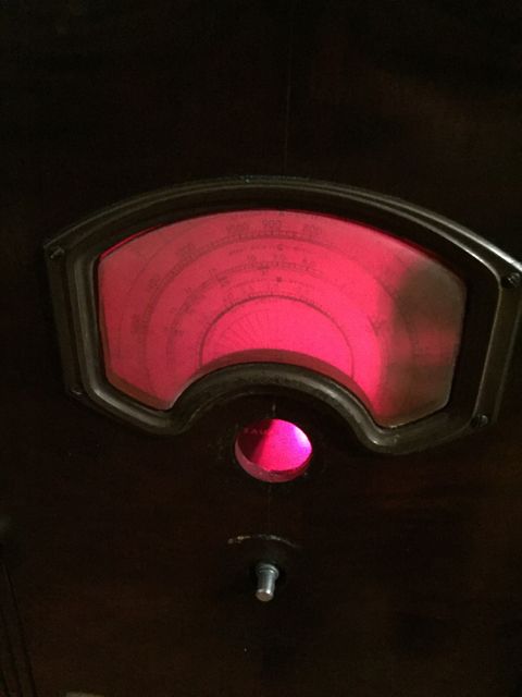

Here's the light in action:
Still needs knobs.  For the unused hole, I'm either going to install some sort of jewel light, or I'll relocate the LED sensitivity pot (currently mounted on the rear).  Overkill for a PA conversion?  Absolutely.  But I got the cabinet for free and had the speaker lying around, and I see this being a studio fixture or nice living room piece.
