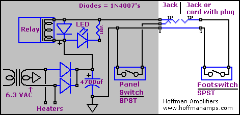

relay switch
« Reply #8 on: August 16, 2014, 06:53:56 pm »
I think you already have another post started about this, right?
See the top image on this page
Looks exactly what you are trying to do
http://el34world.com/projects/relay_switch.htm

One does the SPST switch allow you to energize the relay when no foot switch is plugged in and two is the jack a Switchcraft 12A
Yes and Yes
Print out the diagram twice and study it closely to see both options
No plug inserted and a plug inserted
Follow the circuit path to ground with a colored pen
No Plug Inserted:
See the switch on the jack is closed when there is not a plug in the jack?
What happens when you flip the spst panel switch?
The relay coil now has a path to ground and the relay coil is energized
Plug Inserted:
If the footswitch is plugged in, it can energize the coil by providing a path to ground

  • Posts: 10666
Re: relay switch
« Reply #13 on: August 16, 2014, 08:06:57 pm »
Two ways to ground the relay coil
Top image = no plug in the jacks - Panel switch can trigger the relay coil
12A switch is touching the jack tip
Bottom image = foot switch cable is plugged into the jacks
Note that the switch on the 12A jack is not touching the jack tip when a cable is plugged into it
Foot switch can trigger the relay coil

  • Posts: 5291
Re: Jack for a footswitchable overdrive channel
« Reply #17 on: August 17, 2014, 10:45:05 am »
Also, I am not sure why you put the led next to the 180R resistor.  Could you tell me what they do?
You must use a current limiting resistor in series with a LED. The LED will burn out without the limiter. Also note that Hoffman's LED is on the amp chassis, not the footswitch. You will need to be more creative to use the LED on a footswitch.
You don't have to use a 12A jack, but it makes it convenient to disconnect the panel switch whenever you have the footswitch plugged in. Not all people care for that feature. You can just use a type 11 jack and just wire the panel switch parallel to the footswitch. Just be aware that if you turn the relay on with either switch, you must turn it off with the same switch.
If you would like to be able to have total control with both switches at the same time, then you will have to use a common "three-way" circuit. But that will require SPDT switches and a type 12B stereo jack. Here's a schematic. You may just want to keep the switching bare bones for a simple single relay control. I just wanted to show you some other options.

sluckey
I have attached a new layout that includes the footswitch I will be using for this project.  The footswitch has a 1K resistor to reduce the voltage to the led.
The way I want the panel switch to work is by energizing the relay when the panel switch is turned to manual.  This will be used mostly when no footswitch is plugged in.  I find it very helpful when tuning the related circuit as I don't need to have a footswitch in the way while I am working.  When I want to use a footswitch to energize the relay I plug it in and switch the panel switch to the Pedal setting.
Do you think the way I can accomplish the above with the components and layout I have on the attached drawing?
Mike

Try this Mike...

Mike, read this thread, paying close attention to what Geezer says in reply #4...
http://el34world.com/Forum/index.php?topic=14348.0
Geezer explains how the footswitch you have operates. Basically, the LED will be illuminated whenever the relay is de-energized.

I do not want the normal position of the relay to be in the NO position (energized) when the amps overdrive is off.  During the majority of time the amp is operating I would expect the overdrive to be off.  It is my understanding that the useful life of these relays may not be very long if they are staying energized for long periods of time.
I would not be concerned with the life of the relay. The relay will probably be more reliable that the amp. I've worked with thousands of relays over my 40 year career with FAA. Many of those relays were energized 24/7 for years and years.
But, if you must have the footswitch LED illuminated when the relay is energized, you cannot use that footswitch as it is wired. I see two options.
1. Rewire that footswitch as PRR showed earlier so the LED is in series with the relay coil. This will require a higher dc voltage since the relay will want 5v and the LED will want approx. 2v. That's easy. Just don't use the 7805 regulator chip. All you need is the bridge rectifier and a 470µF cap for a supply.
2. Replace that footswitch with a DPDT or 3PDT that Doug sells. Replace that type 11 jack with a stereo 12B jack. Use a 3 conductor cable between the amp and footswitch. This will allow you to use two wires to switch the relay on thru one half of the footswitch, and use a third wire to supply power to the LED thru the other half of the switch.
And there is one other option. The dead nuts easiest way to do this is to forget about the LED on the footswitch. Put the LED on the amp and wire it as Doug shows.

I'll just add that if you are that concerned about replacing the relay, use a socket and you can relax  :icon_biggrin:
Then all you have to do is unplug the relay and plug in a new one

When I had my PT made I included a dedicated 3.15 - 0 -3.15 @ 1A secondary to supply the relays and footswitch led.  I am also going to use it to power my 6 volt square indicator lamp because I have maxed out the heater secondary with the inclusion of the seventh preamp tube.
So do I use the CT or 100 R resistors on the 1A secondary or just tape it off when I lift all these grounds?  If I don't use either will any hum get injected into the amp?
Having a dedicated 6V winding simplifies a lot of things. You don't need to use the CT or any 100Ω resistors. Hum is not an issue. And you can connect the negative side of the 5V power supply to chassis. And you don't have to isolate the type 11 jack. And since you are no longer concerned about having the LED on when the relay coil is de-energized, you can use that simple drawing I did. And you can use that footswitch you have.
Everything is ready to go. I can't think of anything else to say about it.
Sluckey
Good news about the dedicated 6.3V secondary having its advantages.
Your earlier post about having the led on the faceplate of the amp made me think that would be better than average.  I doubt that there are a lot of DIYers that have a led on their faceplate indicating when their overdrive circuit is on.  I think I have decided that is the way I want to go.  LED on the faceplate and not on the footswitch.
I didn't purchase the footswitch yet so I will just buy what we finally determine is best.  I did a new layout diagram that includes a footswitch with no led and led and 180r resistor placement in the circuit.  I think I did it right but would you double check it for me please?
Doug's schematic does not include a 7805 voltage regulator.  Don't you think I should have one?  Also, do I just ground the center tag of the 7805 and ground the type 11 jack to complete the layout?
