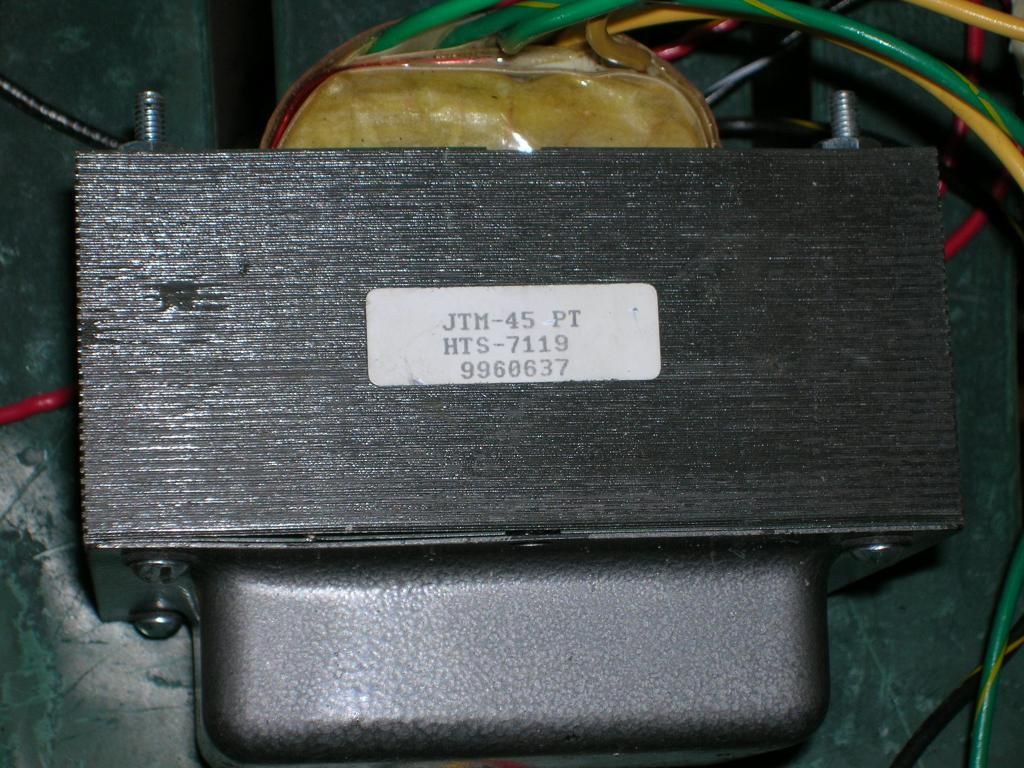

  • Posts: 10645
Re: Bandmaster Reverb repair "mixed bias" question
« Reply #23 on: December 09, 2014, 10:25:52 am »
The schemo Sluckey posted for your amp shows 455dcv at the 6L6 plates, you measure 383dcv at 6L6plates.
Something's not right. 455dcv - 383dcv = 72dcv. That seems a little too much of a drop for just a little hotter bias point.
What do pins 4 and 6 on the rectifier socket measure in AC volts? (With ALL tubes installed, measure pin 4 with red lead and black lead to ground on AC setting, then measure pin 6 with red lead and black lead to ground. Use your alligator clips on your meters leads for safety.)
It has a replacement Bandmaster PT and has been almost entirely redone passive wise to stock.
What's the number stamped on the PT's bell end?
                        Brad    :think1:

Offline goldstache
  • Posts: 360
« Reply #24 on: December 09, 2014, 06:11:25 pm »
The transformer is a classic tone bandmaster replacement,40-18005
325-0-325
Im getting 315Vac at the rect.
It is a Bandmaster reverb, so a few more stages might attribute to a little sag right? With the power tubes out my B+ is about 415VDC.  I think the 455vdc is for a stock amp with original transformer, so maybe it was spec'd a little higher to accommodate reverb circuit. Voltage is significantly lower for Tube rectified with a "blackface" era replacement power transformer, as it was solid state rectified.   I also ran the bias real cold to see what the plates would get at that current. (12ma)  It was 410VDC.
So I biased by ear to 383VDC  X   .05ma = 19Watts.  It sounded the best so far.  I definitely see why an extra bit of B+ would help with volume and tube life.
Do you think that is where my low B+ is coming from?  I tried different rectifiers (5u4) and other sets of 6L6's with the same results.
Thanks, -joe
« Last Edit: December 09, 2014, 06:14:37 pm by goldstache »
  • Posts: 10645
« Reply #25 on: December 09, 2014, 06:26:03 pm »
I just looked at the Classic Tone bandmaster replacement, 40-18005 and it doesn't have a 5vwinding for a tube rectifier.
http://www.classictone.net/40-18005.pdf
So, your amp has an added 5v heater PT?
                Brad    :think1:
Offline goldstache
  • Posts: 360
« Reply #26 on: December 09, 2014, 07:21:32 pm »
Geez I'm sorry.  It's this part number!
p-tf22798
Too many windows on the computer open!
  • Posts: 10645
« Reply #27 on: December 09, 2014, 07:31:25 pm »
Did a search, found this on the PT;
"Replacement for Fender Super Reverb, Pro Reverb, Bandmaster, and Tweed Bassman. Includes rectifier tap. Equivalent to #125P5D & #022798. Specifications Primary: 117 volt, 60 Hz Secondary: 325-0-325 V, 370VDC@200 mA(DC) with 50 V bias tap Filament winding 1: 6.3 V, 4 A Rectifier Filament: 5 V, 3 A Mounting Centers: 2.75 x 3.5 Weight: 7.5 lbs "
Still seems the B+ dcv your getting is a little low, even with a 5U4. PT's B+ wind is rated at 200mA, so why is yours sagging down to 385dcv?
You could try a GZ34/5AR4 to get a few more volts.
                       Brad    :think1:
