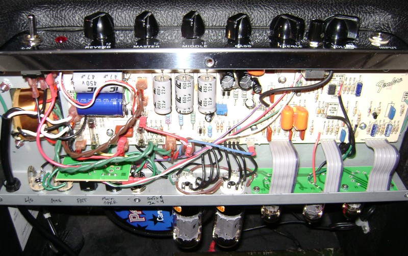

Ok. I had a fried Blue Jr come across my bench a few years back.What to do,what to do.
  I looked at the charred board and proceeded to gut it and built a Princeton Reverb into the chassis.I used all the same control descriptions on the panel but it was 100% Princeton Reverb inside.I used the transformers from the blue jr as well.
  The result? A killer sounding,low voltage Princeton Reverb with a master volume,treble mid bass controls.
It is still in regular service and sounds amazingly good.I simply bolted on Belton tube sockets into the existing holes in the chassis,added one extra preamp tube hole(easy) and Voila!
  Install great sounding amp where a mediocre Blues Jr was before.The stock transformers actually worked great too!It is fixed bias with basically the same bias supply as a Princeton Reverb taken off one leg of the Primary PT winding.

I was going to start a post on this topic, but I did a search and PsychoNoodler has done exactly what I want to do.  (though this thread is old this seemed like the best place to start)
I want to gut a cream board Blues Junior that I own, and install a hand wired Princeton Reverb circuit.
Looking through the Hoffman page Im not sure what parts I'll need to order, so I wondered if anyone here could shed some light on the subject.
From the BJ, I have the Cabinet, Chassis, Reverb Tank, Speaker (a 12" which I may change for a 10" with corresponding baffle board), and all the other bulky heavy-cost-to-ship items.
I need to buy a turret board (Im assuming I'll buy the Blues Junior board and wire the princeton schematic..?) and I Guess a handful of resistors, caps etc.
Just wondering if anyone could offer a bit of guidance on this.  I have modded amps before, repaired a few things, but this would be my first build.

Size wise, the correct Hoffman Princeton board should be fine but measure to be sure. Reverb tank is an 800ohm in and like either a 1200 or 2200 out. I'm thinking that probably won't work like it should with Princeton tube reverb. BJ reverb is solid state. I also don't think you will like the results of the OT of the BJ with the 6v6 of the Princeton. But then again you may like it.
  • Posts: 5280
Re: Let's build a blues junior
« Reply #11 on: February 27, 2016, 01:56:37 pm »
The BJ PT is wrong for the PR circuit. It doesn't produce enough B+ or bias voltage.

Ok, full disclosure.  The BJ I'm trying to mod has already been modded.  I put in the BillM Octal conversion kit 6v6 instead of el34's and upgraded Transformer.  Made it 40 watts...but I don't like it (did this maybe 2 years back)
I like the princetons Reverb 15w sound with the 6v6.  Essentially I want to turn the amp up to 9 and not have the band throw things at me for it being obnoxiously loud.  I tried a PRRI at the shop yesterday and it seemed right on the money.  turned in up to 9, a few ppl looked over annoyed, but the whole store wasn't running over to strangle me.
I own:  A 67' BF super reverb, way too loud past 2 (no break up), A 71' Vibrolux, way too loud past 2 (no break up), a 67 BF Deluxe Reverb (way too loud past 3, bassy, no break up), and 2 BJ's; a slightly tweaked el34 original, and the Octal converted one we're talking about.  The el34 one is ok...but, not great, and I don't like the Octal as is at all. Just flat and lifeless (lots of tubes/speakers have been tried)
So Basically Im thinking Hoffman PR kit, in a BJ box
  • Posts: 10616
« Reply #13 on: February 27, 2016, 03:22:49 pm »
The blues Jr. has EL84's not EL34's. And your 2x6V6's is maybe ~20w not 40w.
Unless you meant 6L6's? But the new PT must have enough B+dcv and B+ current to get ~40w output.

With that PT you should be able to build a PR (or DR) in your BJ cab. You will need a 4AB3C1B reverb tank. It's 16.75" long. Hopefully the BJ cab is wide enough.

You strip out everything you don't need then start putting PR stuff in.
It would help to see some pics of the outside and inside of the chassis to see what you're up against.
EDIT... I just looked at the pics of Hoffman's BJ conversion. You're gonna have to plan this carefully. The PR needs 7 tubes so you will be adding two. Check the measurements of Hoffman's PR board to see how it will fit your chassis.
I suggest you start a new thread on this project.

....Anyone know how to build a PR into a Blues Junior?   :laugh:
Lets just start from the beginning. You will get any help you need here I promise. Gut the amp. Are the sockets onboard? If so you wont be needing those. Are they chassis mount? If so, re-use them. Leave transformers intact (for now). Post some photos. We can go from there.  :icon_biggrin:
« Reply #25 on: February 28, 2016, 04:16:55 pm »
Ah, thats a good start, i didn't see the BJ conversion photos before.
Looks like reverb needed to be scrapped entirely (neither solid state or tube driven, from what I can see...just no reverb.)
Ill post some photos asap. The original BJ Tube sockets were mounted on a separate circuit board.  As shown in photo 1:  http://el34world.com/Hoffman/Blues_Junior_Build.htm
After the Octal conversion I did, the 2 6L6 sockets are mounted to the Chassis, and the PCB they used to be mounted to, was cut in half, like this:
http://www.duhvoodooman.com/miscimages/musical/BJr/BJr_mods_rear-down.jpg
So, the initial big picture problems are going to be:
Im going to need to add another preamp tube, as BJ's only have 3 12ax7's
Im going to need to add a Rectifier tube.  I think I have the physical real estate, but haven't measured.
And I may need to abandon reverb (which may be a deal breaker, the compromise makes it less interesting to me)
Either way I'll post photos and more info as I go.
Thanks guys
Dave
