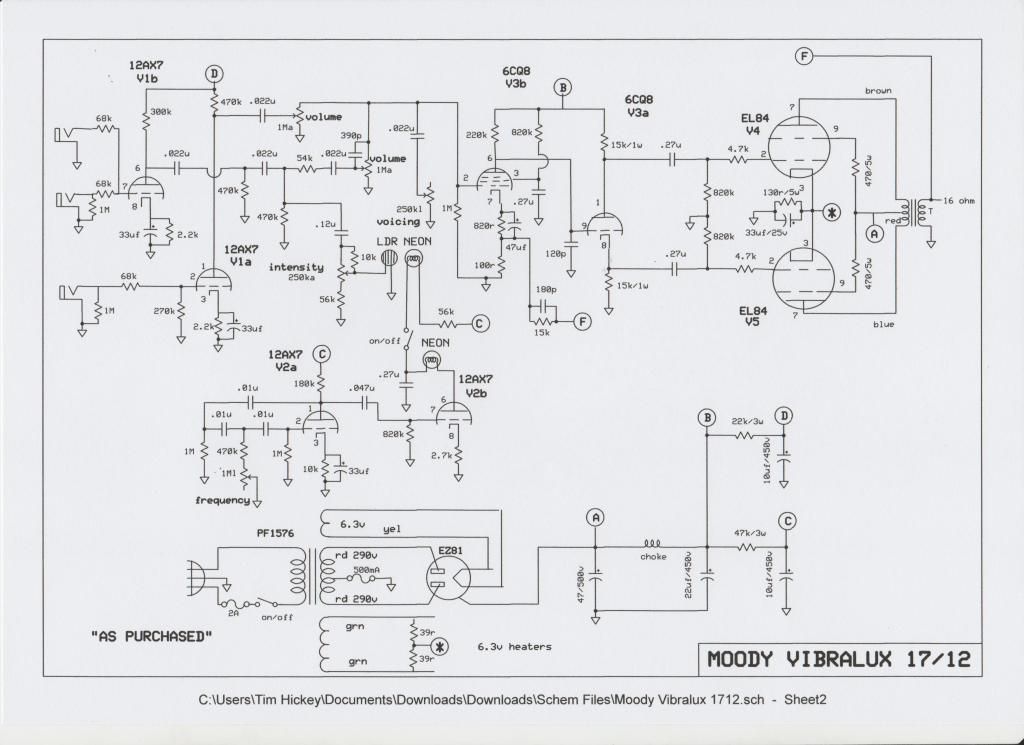

Hi guys!
I'm wondering about this M10a reverb circuit.
What is the gain difference on dry signal between Vin and Vout?
I know 15k and 2k7 makes a voltage divider but is there gain when signal goes in the cathode and comes out the plate?
thanks in advance.

I think I see a Dry gain of about 0.6 (a loss of about half), based on a half-assed analysis.  Maybe PRR can tell me if I'm on the right track:
There's a big signal loss on the first 12AU7 stage due to taking a cathode output across such a small load.  I didn't try to formally analyze the stage, but since plate current = cathode current, the cathode output is likely only 270Ω/5kΩ = ~1/18th the size of the plate output.
As you note, the 15kΩ forms a voltage divider with the 2.7kΩ cathode resistor at the 12AX7 mix stage, which is another 2.7kΩ/(15kΩ+2.7kΩ) = ~1/7th loss.
I can't trust the 12AX7 internal plate resistance is the data sheet value of 62.5kΩ, but rolling with that number the gain of that stage is 100 * [270kΩ*(270kΩ+62.5kΩ)] = ~81.
1/18 * 1/7 * 81 = ~0.6
Of course the Reverb path has a hefty signal loss through the reverb tank, so it seems reasonable it would be comparable to the Dry path signal, even with the extra 12AX7 gain boost for the Reverb signal.

Gain of bare cathode follower is unity.
But all the resistance in the plate circuit, divided by Mu, appears as cathode resistance.
Taking one 12AU7 at high current as Rp=6K, we have 3K, plus the 5K, is 8K. Divided by Mu of 20, is 400r.
400r to the 270r resistor is gain of 0.4.
At the grounded grid end, if we ignore the 2.7K, gain is effective resistance on plate node to the 15K source. 12AX7 at low plate current is say 100K Rp. With 270K plate feed, say 75K here.
So GG stage gain would be 75K/15K= 5.
But the 2.7K diverts much of the signal from the 15K. I'm having trouble proving this, figuring what factors cancel out. But assume the 270K is divided by Mu, gives 2.7K, so the current in 15K is split about in half.
0.4 * 0.5 * 5 = unity.
That is assuming NO load at Vout. Impedance here is ~~75K, so even a light load will be some drop. A complete study would need this data.

What about this block from M8, is this closer to unity gain than the M10a block?
Gain of the 7025 stage is about 88.
The Dry signal sees a 470kΩ resistor leading into a combined 27kΩ (pot & 22kΩ resistor).  With the Mix set for max-Dry, the reduction is 27k/(27k+470k) = 1/18.  So net gain of 88/18 = ~5 for the dry path.
Look at that schematic again and perhaps lower your net gain result by an order of magnitude or so.
Re: M10a reverb question
« Reply #13 on: September 23, 2016, 09:30:58 pm »
Well, the error was going with an rp of 62.5kΩ from the 12AX7 data sheet.  But that's because I didn't want to draw on a sheet to get an accurate rp, which turned out to be ~139kΩ.  And Mu is down to 90, while the effective load is only 320kΩ once you factor in the 1MΩ which follows.  All told, the math says a gain of 90 * [320kΩ/(320kΩ+139kΩ)] = ~63, while following the a.c. loadline looks more like 60.
If you were talking about using 27kΩ in the formula rather than the pot's 5kΩ, make sure you didn't overlook that 22kΩ to ground...  The Dry never drops to zero-level, even though the pot is ganged to reduce dry signal when the Reverb is turned up.
