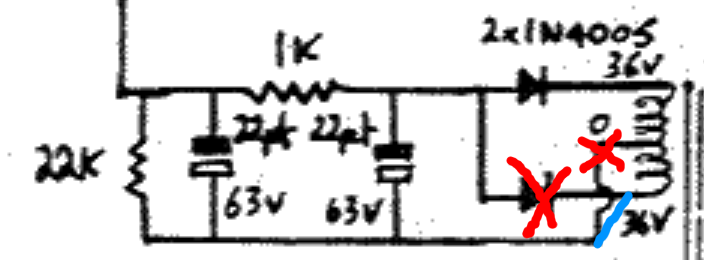

Hi there.
I got this amp last week, and after be really afraid about inner voltages (you can check the whole process here;  http://el34world.com/Forum/index.php?topic=21818.0 ), i finished the schematic.
Amp was made by a Barcelona company here in Spain maybe in mid 70s.
The company is Centro Musical Barcelona (CMB) and still is in business but i think they just not build amps anymore.
Design and look is deeply influenced by early Orange and Matamp designs.

David, are you considering subtle improvements to the amp, after checking all the parts are ok (especially coupling cap leakage)?
Such powerful amps can benefit from little practicalities like adding EL34 cathode current sense resistors, and removing/bypassing switches and poor speaker sockets that can accidently disconnect the speaker.  Elevating the 12AX7 heater may also reduce stress on the phase inverter triode.

The power supply voltages depend on how much current is being supplied.
You identified power supply voltages in the other thread, and then effectively concluded they were too high, and hence changes to the power supply would be needed.  That may have been a poor initial judgment.
A more considered assessment would be to restore the amp, confirming that no parts are poor, and the idle setup has appropriate EL34 power dissipation, and to measure power supply voltages, and confirm cathode and screen currents.  Then you would be in a better position to check the EL34 loadline, and how the original designer set the amp up.  You may want to operate the amp for a particular use (PA, guitar, hi-fi), which may then lead you to question if any changes are needed.
Ciao, Tim

Hi,
I´m measuring O.T. plate to plate impedance.
I applied 232vac into both primary sides and get 15.4vac on the 8 ohm sec.
so...
232/15.4 = 15.065
15.065 x 15.065 = 226.95
226.95 x 8 = 1.815.
So.
Is this a O.T. wired in 1k8 configuration?

1.8K per four tubes (3.6K per pair) is what Marshall used.
Do any Marshall "100W" use screen voltage this high?
What is your heater AC voltage? If it is much over 6.3V, then wall outlet voltages have risen since this thing was made. You could connect a 240V:24V 1A transformer to buck-down wall voltage 10%, say from 245V to 220V, which may be what it needs.

What make me suspicious about something going wrong are the e-caps in preamp power supply nodes running way above its ratting voltage.
Did you have all the tubes, especially the power tubes installed when you measured the voltages on the preamp e-caps? If not, all readings on your schematic will be high.

Well then, I'd be concerned with 519v on a cap rated for 450v.

Yes, i saw that kit and people here have issues about the 600v ratting for the mosfet and the pot handling those voltages.
And... yes. tubes was all in when i measured the voltages.
I just ordered some stuff yesterday and next week i´ll do some work.
New rectifier diodes, new E-caps (rated for real voltages in the amp), check the bias supply, power resistors, leaking caps, grounds....
And new tubes, of course.
When amp arrive i check the bias: 33-40-32-64 mA. Far away from a matched quad.
Before going into any other conclusion, i´m gonna do all the basic job.
After that, new voltages measurements and, if needed, look for a solution.
Right now, and after some research, i found all this options. All of them had been tested in working amps:
.-VVR for the screens. Tube town kit or any other with better voltage specs.
.-Using the central point of the 2nd power supply node as screen supply. (Half voltage, maybe too low)
.-Add some zener diodes in line with the screens, before the 1k screen resistors. I have some 20v/5w. Five of them and i am in the safe zone.
.-Doubling O.T. primary impedance. If i use a 16ohm speaker with the labeled 8ohm tap i get 3k6. Could be a solution?  PLEASE. SOMEONE CHECK THIS.

checking Hammond specs. i found this.
They ask for 3k4 for 4xEL34.  So... if i use the "8ohm" output with a 16ohm speaker i´m in the 3k6 area.  Ballpark??
David
Re: CMB. 70s Orange/Matamp clone
« Reply #18 on: April 23, 2017, 03:29:02 pm »
Tubes can be run with a WIDE range of loads, depending on the B+ you use and your output goal. The Hammond chart is only a suggestion, and probably not a good one.
Find a Marshall, Orange, or Matamp which is similar and study what they did.

With voltages over 500vdc with 4xEL34
Matamp uses 2k5 pri.
Laney Supergroup MK1 uses a 3k5  (600vdc!!!)
Marshall goes from 1k7 to 2k
Park used 2k5
