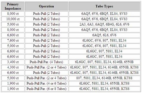

« Reply #17 on: April 23, 2017, 09:13:08 am »
1.8K per four tubes (3.6K per pair) is what Marshall used.
Do any Marshall "100W" use screen voltage this high?
What is your heater AC voltage? If it is much over 6.3V, then wall outlet voltages have risen since this thing was made. You could connect a 240V:24V 1A transformer to buck-down wall voltage 10%, say from 245V to 220V, which may be what it needs.
checking Hammond specs. i found this.
They ask for 3k4 for 4xEL34.  So... if i use the "8ohm" output with a 16ohm speaker i´m in the 3k6 area.  Ballpark??
David
Re: CMB. 70s Orange/Matamp clone
« Reply #18 on: April 23, 2017, 03:29:02 pm »
Tubes can be run with a WIDE range of loads, depending on the B+ you use and your output goal. The Hammond chart is only a suggestion, and probably not a good one.
Find a Marshall, Orange, or Matamp which is similar and study what they did.

« Reply #19 on: April 24, 2017, 07:43:40 am »
With voltages over 500vdc with 4xEL34
Matamp uses 2k5 pri.
Laney Supergroup MK1 uses a 3k5  (600vdc!!!)
Marshall goes from 1k7 to 2k
Park used 2k5
« Last Edit: April 24, 2017, 03:06:39 pm by chocopower »
