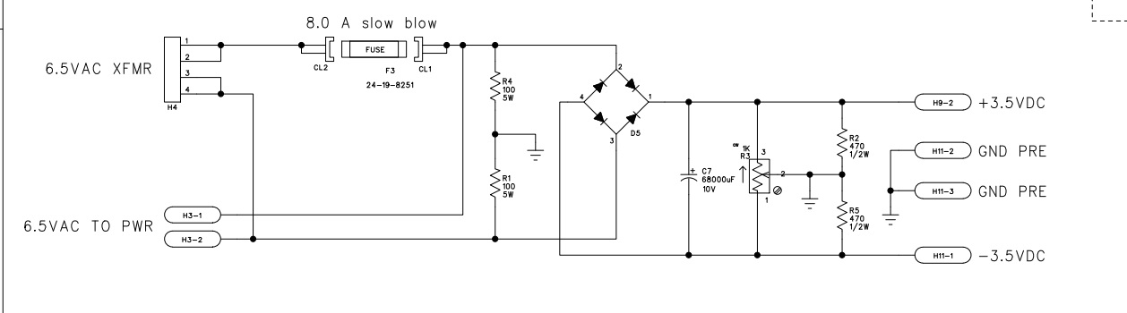

I had read on a couple of threads on other sites that the bridge rectifier, D5, commonly burns out.  I'm pretty sure, but not certain, that this is the heater voltage for the preamp tubes.  For some reason, they are running on DC.
For reference, I have linked an attachment of this specific section of the schematic (located on page 37 in the above link):
I did turn the amp on initially and saw that the the power tubes were glowing but not the preamp tubes.
Upon opening the amp, D5 was very clearly overheated.  It was so bad that upon removal, the negative-lead solder pad had melted into the board.  So I got a new rectifier with a slightly higher current rating and added a heat sink.
I proceeded to solder the 3 pins into their pads and added a jumper wire to the 4th pin which is the negative pin of the bridge rectifier.  Here is where I went wrong - I accidentally soldered the other end of the jumper to the negative side of C7 instead of the positive side.  I didn't realize until after attempting to power the amp and nothing glowed, not even the power tubes this time.
I then took another look at the schematic and realized my error.  I switched the jumper wire over to the positive end of C7.  At this point I probably should've ran it into a light bulb limiter, but I was so certain this was the issue.
I go to power up the amp and the 8 amp fuse blew immediately.
Now I'm kind of at a loss as to whether I caused a new short by attaching the negative end of D5 to the negative end of C7 (instead of positive end), or if there was something else already shorted that somehow caused the old bridge rectifier to burnout before the 8 amp fuse.
My thoughts are, the issue is somewhere within this smaller rectified section and / or within the heater section of the preamp tubes.  I did test the preamp tubes for shorts and didn't find any.
When my new 8 amp fuses arrive, my plan of attack will be to use a light bulb limiter and remove all tubes.  From there, I suppose I'll check voltages in the area of the burnt out rectifier.  The resistors in the attached schematic seem to look and test fine.  Unfortunately I can't test C7 as my meter only goes to 1000uF for capacitance and that bad boy is a whopping 68,000uF!
Anyways, thought I'd see if you guys had any other recommendations and / or confirm that I'm on the right path here.

can you temporarily connect the preamp tube heaters to ac to see if the amp otherwise works without the dc heaters? might give ya more to troubleshoot in the meantime
always mind your pinouts and polarities!
you might wish to use the type of rectifier bridges that have solder lugs and can be bolted to the chassis. use the AC lugs (usually marked with a ~) as a tie point for the filament taps and links to the power tube heaters. then run the + to the + end of the electro cap and the - end to the - end of the cap. 20A rectifier bridges can be had dirt cheap... about a buck off tayda?

> D5 was very clearly overheated.... a new rectifier with a slightly higher current rating and added a heat sink.
Don't be shy. Current rating is now cheap. And for most of a century designers have mis-guessed rectifier stress leading to failures not-too-long after warranty expiration. It is conservative and often *affordable* to design for 3X the *winding* current rating. For more fun, the preamp DC and power amp AC heat are on the same winding. 4*1.6A= 6.4A of AC load, 5*0.3A*1.8= 2.7A for preamp, this is over 9 Amps of winding. Times three is 27 Amps. Start with a 25A part-filter but watch for deals at 35A and 50A.
And yes, heat this hot can't be shed by an epoxy box. This should go on chassis. (Or heatsink that won't break loose on the road-trip.)

Since your power tube heaters appeared to be working originally while your preamp tubes were not, and now that your power supply is out and nothing works, this would point to the original problem being in the preamp section as you where thinking. Your problem most likely is not a dead short but an unusually low resistance in the preamp heater circuit causing additional current which resulted in your rectifier overheating. I would suggest you measure the resistance of the heaters of your preamp tubes (across the pins with the tubes removed) and see if you can spot one with a lower resistance than the others. Start with the preamp tube that was not not working when you originally powered up the amp that is closest to the power supply. If nothing is apparent there, with all the tubes removed, measure the resistance across the power supply feeds at each socket starting with the last tube in the heater circuit and work your way back to the power supply. With all the tubes removed, the resistance at every socket should be nearly equal. If the resistance changes at any socket, investigate for issues in that area.

 :think1: The resistances across the bridge and capacitor should be very high, leaving the two 490R resistors and the 1K potentiometer across the supply as the paths of least resistance. I would expect to see a resistance of about 500R. What are the resistances from each side of the supply to ground?

Alright - some updates:
Amp off Tubes Out
-When measuring each side of the heater transformer to ground, I'm getting 100 ohms which seems to make sense since each side is going across a 100 ohm resistor, right?
-When measuring resistance from the positive side of the bridge to the negative side, I'm getting full continuity (like 0.2 ohms).
-When measuring across R2 and R5 (470 ohm resistors) I'm getting like 124 ohms.
Amp on Plugged into a light bulb limiter
-First attempt to turn on and the 8 amp fuse blew again.  Figured it was my 150w bulb.
-Changed to 75w bulb in the limiter.  Very dim glow from the bulb.  I measured 6.5 VAC from transformer to ground.
-I measured all points of the bridge rectifier on DC and they all read 0 VDC.
-Just to be sure, I measured from pins 4&5 to 9 on the sockets and they all read 0 VDC
So, at this point it seems pretty obvious that I probably blew the bridge rectifier when I accidentally swapped the negative side of it onto the negative side of C7.  I'm going to be changing that guy with a beefed up one, as recommended above anyways.
Anything else I should check at this point?  Any reason not to change out the bridge rectifier yet?

Update for you all - the beefier rectifier seems to have solved the issue.  I've tested it up to the point of having preamp tubes installed.  No shorts and all the front lights come on, which is the first time I've seen them since getting the amp.
