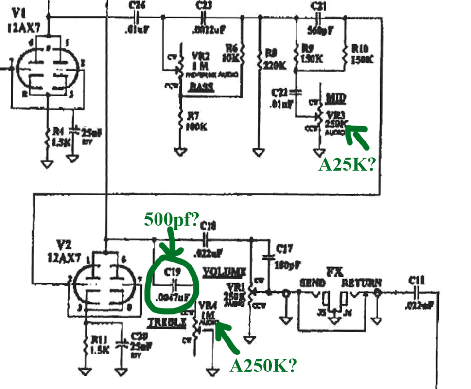

Greetings,
My build is an adaptation of Hoffman's single-channel DR, with a couple of mods from sluckey's Tweed Deluxe Reverb: I added a master volume, and replaced the .047uF  midrange cap with .022uF.  I'm currently voicing the amp and have the most persistent problem.  The Treble knob is crazy strong.  At any Treble setting above 3 it adds a harsh, buzzing quality to the notes. This happens with single coil or humbucker pickups although not as bad with humbuckers.
I have spent the last several days researching here.  Mostly the blame fell on oscillation, so I've been trying various tweaks I've read, mostly placing 50-200pf caps in various places.  One across the Master volume leads helped somewhat.  I've tried them parallel with the preamp plate resistors but couldn't hear much of a difference.  The next best one was 120pF across the LTPI plates.
But still, while the sound is improved, there is still a harsh buzzy quality unless the Treble knob is dialed way down.  It also seems like the Mid pot also adds some buzz when I turn it up high.  The tone stack is the classic Fender.
Any tone from bass through bright midrange comes through fine, although definitely brighter with single-coils.  It's just the treble side that's out of control.
Should I replace that .047uF tone cap?  Would replacing the 250pF treble cap help here?  Changing the slope resistor?   :help:

If it’s the circuit, I suggest to reduce the tone stack treble cap value from 250pF to 120-150pF.

@pdf64,
I have a 120 pf cap; I will try replacing the treble cap in the tone stack.

I suggest to check the taper of the treble pot.

It's a 250K pot.  Across the outer leads I measure 247K.  At roughly 50% rotation I measure 35K, at about 75% rotation I measure 125K.  More later.

I tested the 120pf cap as the treble cap in the tone stack.  It made the harsh-tinny-buzzy quality of the notes worse.  Then I replaced the 250pf cap, and put the 120pf cap across the plate resistor of the triode immediately following the tone stack.  That was some improvement, about a 30% drop in the harsh, buzzy quality.
Bear in mind that this effect happens only on the higher notes, say from 600Hz upward, more pronounced on the higher frequency notes.
I then took the Mid pot completely out of the signal chain and that helped somewhat more.  In that configuration I could actually dial in about a third or half of the Treble pot without getting the harsh overtones.
I also lowered the bias current from about 26-27ma to 24-25ma.  These are new JJ 6V6GTs.
I hope this makes sense to someone.  I'm well out of my depth.   :w2:  Willing to try anything.  I have to go out tonight but I can report back on the other stuff tomorrow.

You said you replaced the .047uF  midrange cap with .022uF.  Wouldn't that end up making the tonestack treble control stronger?  What was the purpose in that change?
It was from sluckey's Tweed Deluxe Reverb and I believe it is a common mod done to tighten up the bottom end.  But you're right, the .047 is the stock AB763 value, and I never actually tried the amp with it.  I will sub in a .047 cap today.

Replaced the .022uf cap in the tone stack with the stock .047uf.  It was a definite improvement.
Removed the Mid pot out of the circuit. Also improvement and that helps some.

#4) I have a 10K mid pot, would 25K be better?  I see that value on some circuits with Mid.  I'm happy leaving the Mid control off, but wouldn't mind getting it to work if I could.

Try using a different type of 250pF on the treble pot. IE, if using a silver mica, switch to a ceramic.
I just scrounged up a 220pF ceramic cap and clipped it in and ...  yes, it sounds better.   :bravo1:  The buzzy, ringing sound is gone.  I also tried a 2.2nF ceramic and it sounded okay too, with a tighter bass response and punch.  The -3dB point for the 220pF cap is ~2890Hz, for the 2.2nf cap it's ~289 Hz.
Why would a ceramic 220pF be such an improvement over the 250pF silver mica?  What went into the BFDR's during the 60s?

Don't know why ceramics sound better. The original blackface amps used ceramics. I don't remember seeing any silver mica caps in anything back in the '60s. They may not have even been invented at the time. Here's some high resolution pics of a '64 DR. All ceramic.

Thanks again for getting down into the weeds on this one, and adding to all the help you've already given me on this amp.

I’ve been following this thread as my “ear” has been hearing an overly treble or very bright issue, in a 6v6 plexi l built.
In the plexi l’ve just been mixing the normal channel more to compensate. I’be been using mica caps for a good while, l’ll try some ceramic.

I have also been replacing silver mica caps with ceramic discs the last year or two.
I had bought some of those huge Sozo ($$) silver mica’s and chased many other possible bandaids before swapping out the cap I spent big money on hoping for more mojo.
Well I’m chasing the same problem and using a 250p polystyrene treble cap. So you’re saying the problem all went away with just changing your 250p silver mica treble cap? I have a different amp, modded up JCM800 Marshall. I installed the same style Fender tone stack for my clean channel off the plate of the first input preamp tube V1.
What I saw with a 1k audio tone injected was a jagged looking sign wave on the tone stack output that got worse the more treble passed to it. I installed a 331p to ground after it and that smoothed out the signal. Now, I lowered it to 400hz input and lo and behold the jagged signal returned! Still chasing the higher frequency note ringing. Can’t see it on a scope at the output but you sure can hear it. I could add a bigger cap to smooth that out but there goes most of my tone and treble. I’m going to try a preamp NFB some where along the line using a small cap and resistor to see if that cures it. I tried slugging a pole with from 120 to 1000p caps on the power tube grids per Merlin. All that did was cause an oscillating squeal making matters worse. Installed a 330p across the PI 47k NFB hoping that was it. It did remove the hump on the 10k square wave input at the amps FX Loop Return as Merlin wrote about that’s about it. Frustrating  problem for sure.

I would match the Hoffman schematic more closely.
Replace the 100k Master Volume with a 50k pot. This more closely matches the 47k resistor to ground that Hoffman has in this location.
Remove the bright cap on the master volume. It makes your amp sound bright!

After some research it appears it might be intermodulation distortion and phase shifting with the TMB adjustments. I paralleled a 120p across V1 plate resistor which in my case is 220k. That helped a lot. I’ll upload a schematic once I make the changes and reduce the size. The Fender “shimmer” explained on another forum is the treble and bass full up and the mid pot lower. Do the opposite and you just have a flat response for the most part. Duncan’s Tone Calculator gives you some examples.
