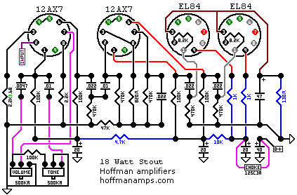

I've got a marshall style 100w pt with a heater secondary that reads 3,50V per side, instead of the more usual 3.15V, what do you guys consider to be a safe error margin for this value is 7V usable or should I be looking for another pt?

If you are worried about it, just install 1N5408 nad it will drop voltage around 0.7V on each filament side. just be sure to check current rating on diodes in order to avoid burning them up.

forgot to add the schem. :rolleyes:

The diode approach to reducing heater voltage throws me a bit.  Wouldn't that act like a half-wave rectifier on the heater supply?  Not saying it doesn't work, just curious.
Chip
sand rectos have a constant voltage drop when operated above some microamps.
In order to act as a rectifier, it would be necessary that both diodes were oriented in the same way, so that each diode conduct positive cicles of current while the other would be off. When sine wave inverts, then the other diode starts to conduct and the very first diode would quit conducting.
On the drawing, the upper diode conducts positive cicles while the bottom diode conducts only negative cicles.

rzenc, your top circuit cannot work. One of the diodes will always be reverse biased, and since they are in series with the load, no current can flow thru the load (filament circuit). The bottom circuit will work, but each diode will drop 0.7 volt and the resultant current will be unfiltered, halfwave rectified dc.
A better way would be to put the diodes parallel but back to back, then in series with the filament string. That way you can drop about 0.7v and still have AC voltage applied to the filaments.

sluckey, does the attached show what you described?
Yes. The link jjasilli posted shows it as well.
Can someone tell me whether two resistors placed in the second drawing are in series or in parallel?
The circuit is incomplete as drawn. But, if you connect each resistor to the filament pins of a tube, then the top resistor, tube filament, and bottom resistor are all in series. You could really just replace the two resistors with a single resistor.
However, IMO, 7VAC on a receiving tube filament designed to work at 6.3VAC is fine, whether that 7 VAC is loaded or unloaded.
Top circuit was only intended to show how a full-wave recto is set up, although it is not complete, my bad, I must have done it properly....sorry I was in a rush..and, indeed, as jjasilli mentioned, I was refering to Merlin arrangment, but draw it wrong..  :huh:

Ah, the missing CT! That changes everything.   :wink:
