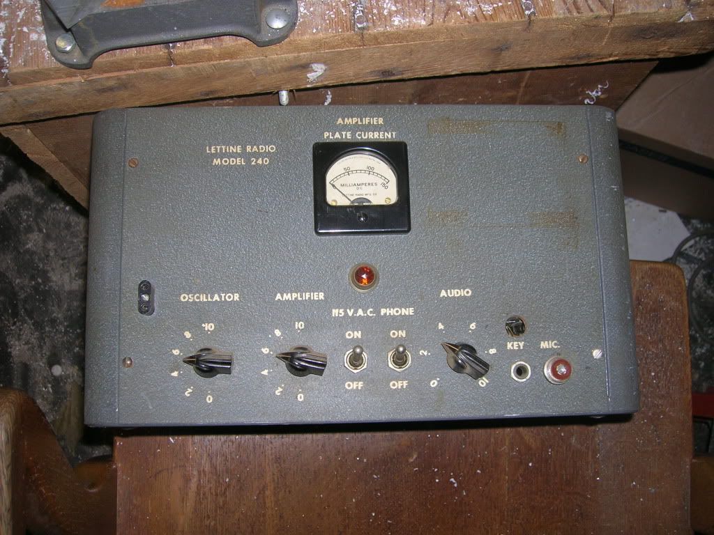

I'm holding here one of two fattish NOS never installed GE 10 Henry chokes I got from the garage of doom. I measured DC res and got 187 ohms and 196 ohms (the connection terminals are a tad corroded so the res readings could be a tad flukey)
They are rated 10 henries and 100 mils. However, as the wire coming out of the insides is minimally 18 ga, I hardly suspect 100 mils exceeds any  kind of current carrying capability.
I have seen inexpensive handheld meters that measure henries of an inductor. My Fluke 77 doesn't.
