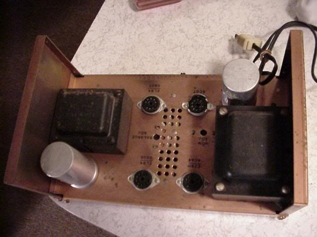

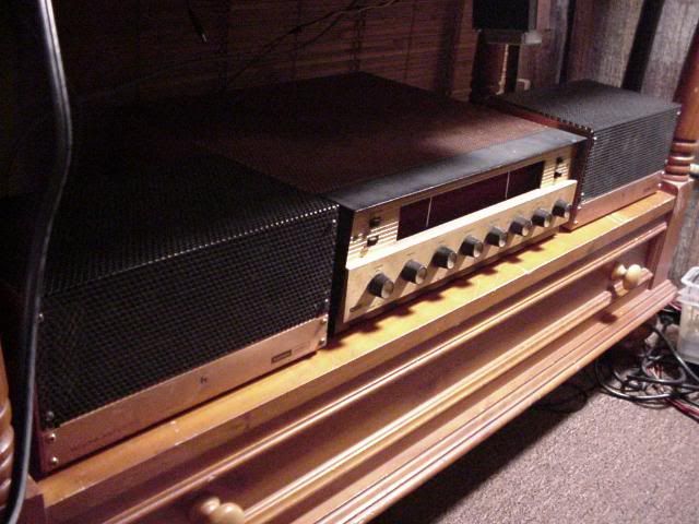

What should i do with this monoblock setup? Any wild ideas? (2) EL84 (1) 6CG7 (1) 6CA4
I have all the tubes that came with these. Blackplate RCA 6BQ5's as well. I removed them to test them

You'd need to punch another hole for a 9 pin socket for a 12A_7  & rewire the 6CG7 for a 5879 pentode.
I've punched numerous holes into steel mono block chassis by tracing a penny on to the chassis. Then using 1/8" drill bit to make holes around the inside perimeter of the traced penny circumference. Punch out the plug and use a grinder drill bit to smooth the hole for the 9 pin socket. Usually takes about 20 min max.

No offense, but I think what LC suggested might be the way to go. There could be a serious audiophile out there looking for one of these HK setups in good condition. You've got both amps and the preamp it appears. It might be worth more to you to clean it up and sell it as is. Then use the cash to buy some transformers and a chassis.

+1 on the restore.  Ground the properly, give em a cap job, outfit them with some decent tubes, and sell em for a profit.

All three serials are different. I like the copper chassis's

Harmon Kardon = $$$. Good stuff to audiophiles, especially the unmolested lower powered units. Pair of identical monoblocks? What a find!
You'd be facing some serious karma, should you tear 'em up. I'd sell all three units together so's not to be considered a home wrecker.

I looked on fleaBay at completed listings.  A pair of HK-250's sold for $950.00  That's the 4 x 6L6 version.  I think you have the HK-20's.  I'd bet an easy 6 bills as they sit.
