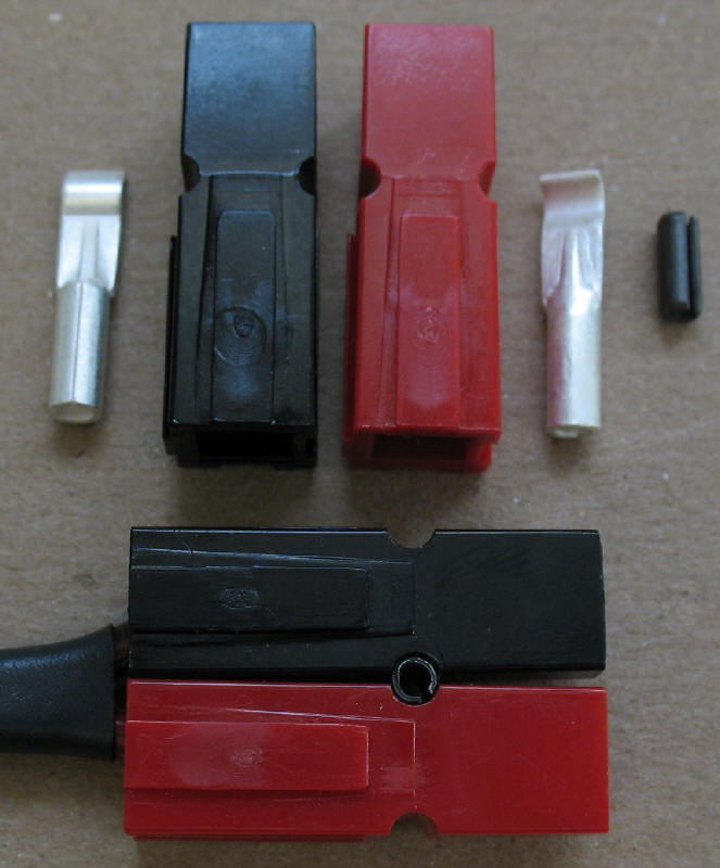

I would probably use something like the LED I used for my CNC machine lights
They are high output, but only run about 20-30 milliamps each
I have used these LED's for a couple projects with good success
Cheap - You get 25 of them for $2.60 and free shipping.
http://www.dealextreme.com/details.dx/sku.1106
For 12 volts I would put 3 or 4 in series to see how that looks
You could just drill small round holes in some material, even wood, and glue in the LED's
You would need one current limiting resistor, a double wire and some sort of plug
I use the Andeson powerpole connectors and love them
I have a page with info on those here
http://www.el34world.com/Misc/bike/BikesLights27.htm
