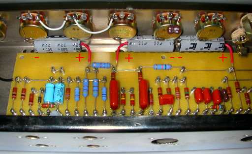

It's easy to modify a Hoffman layout to conform to O'Connor's "galactic ground" system.  In fact, Hoffman's grounding scheme already is darn close to one IMHO.  I've had success adding a board-mounted ground bus to a Hoffman layout, allowing placement of the filter caps along the edge of the board.  This Super Reverb layout worked well:
It's hard to see there, but the orange/gold line just below the board is the ground bus.  Mounted on either end in eyelets.  Green leads are grounds - that'll point you to the bus too.  The 3 big caps on the right-hand end of the board are for the power amp.  Notice that they are on a separate, short ground bus.  That's Hoffman's grounding scheme, and it works.
In another build, I used radial electrolytics for filtering the preamp stages.  That seemed cleaner in layout terms compared to using axial caps.  Also, I hate that messy bias board and have a much better layout for a bias board now.
I got the idea for caps along the edge of the board from this picture in Doug's "Library"
That's a Hoffman Bassman build BTW.
