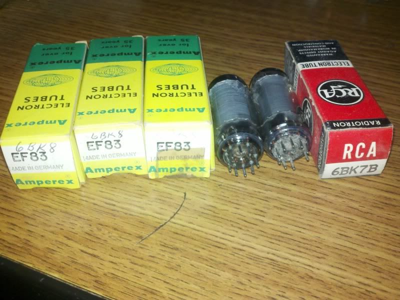

why burger king? well, all the tubes are 6BKsomething_or_another...
6BK8 - semi remote cut-off pentode for audio use - not very popular & seems to be uncommon - euro equiv. is EF83 - same pinning as 6267/EF86.
6BK7 - PI - as far as i can tell, nearly as common as dirt, as far as tubes go.
6BK6 - 1st stage & summing amp - 6AV6 variant w/ same pinning - seems to be fairly common.
6BK5 - output pentode - also seems to be fairly common - probably used mostly for outputs on TV sets (just a guess). filaments are current hungry - 6 volt versions are 1.2A/valve
U1 will dissipate ~~10W - will need a fairly hefty heat-sink.
just fooling around - have not built yet - have everything except the 6BK8/EF83 - buttery had all the other tubes in his stash. thanks buttery.  :smiley:
it's just a 5E3 with a 'lil twist.
I didn't know it had a US type-number.
It was specifically made for a tape recorder automatic level control.
http://www.pocnet.net/hobby/bastel/tubes/tips.html
It is a real waste to use it as a straight pentode.
Find one of the simpler vari-Mu limiters. Final stage plate winding feeds caps and diodes to make control voltage. Bring that around to the EF83 grid (must block DC from the jack). Use the specific Ra and Rg2 values from the sheet, with little or no cathode resistor. It's a limiter, and the unique feature is that it is relatively thumpless for a single-ended limiter.
6BK7 was a very popular TV tuner front-end. I have used it as push-pull headphone "power" amp.
6BK6 ... I don't know why it existed, 6AV6 does the same job.
6BK5 is probably part of the deal to screw Armstrong on his ratio-detector patent. Some of the strange things used to evade his patent incidentally had high output, but not enough to flog 6AQ5 etc. It seems to have topped the charts in 1954-1955 with a short-wave radio and five TV sets, monsters with 24" screen and 10" speaker.

was only able to procure 3 of the 6BK8...
...but they are lovely three.
i'll start strapping on the breadboard tomorrow.
