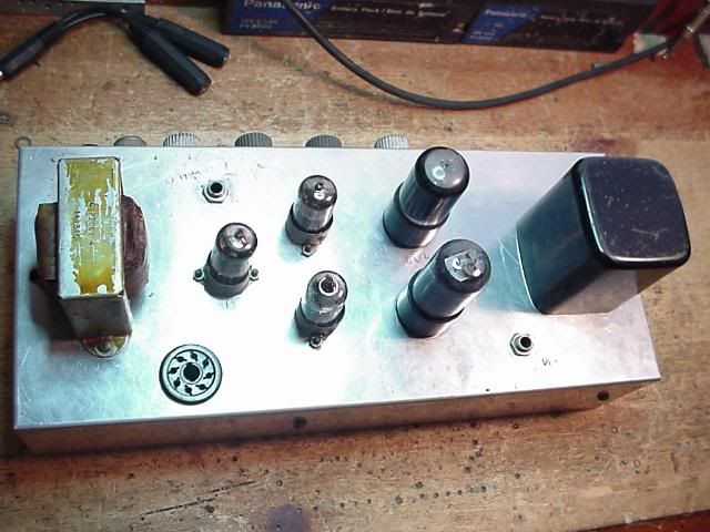

Built A Sch 40 GA-5 Today
« on: January 09, 2011, 10:52:49 pm »
Well mine is in a aluminum chassis.  I tip my hat to those who have built it in a 6 X 6 PVC J-box it has to be tough in that space.
I tried to use the new voltage chart.  Please comment.
Sounds great, way better than the Firefly thing I did for my 1st build.  Now to finish the face plate and build a head box.

Those voltages are way too high
Was the amp running with the valves in it when you measured them?
« Last Edit: January 12, 2011, 06:39:52 am by EL34 »
Offline Geezer
  • Posts: 3680
Re: Built A Sch 40 GA-5 Today
« Reply #3 on: January 12, 2011, 06:58:29 am »
Yeah, it sure looks like there's no load by those voltages.......??

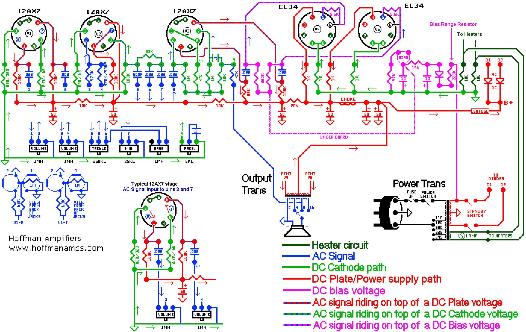

Sluckey why does the current flow diagram http://www.el34world.com/charts/images/CurrentDiagram2.gif show the rectifier circuit as DC or am I misunderstanding the flow diagram in my previous post?
The output of the rectifier diodes (cathodes in this case) is DC. But the diode anodes are connected directly to the PT secondary which is AC. Did you notice the "AC" and "DC" labels next to the diodes?
No I did not see the forest through the trees I got fixated on the colors and did not pay attention to the details.  Funny thing about that library all the info is there you just gotta find it.  Some times it takes a few looks but its there.

That particular drawing is very busy. Easy to miss a small detail.
Ignoring screen current, your EL84 is dissapating 23.6 watts. Way over max spec. I'd put a 500Ω cathode resistor in it and recalculate.
