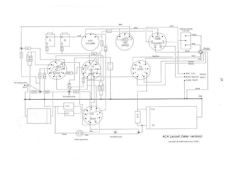

First things first...
I'm using the schematic and layouts from www.thevoxac30guide.com (which is a nice book BTW)
but here's the original...
http://www.el34world.com/charts/Schematics/files/Vox/ac4.pdf

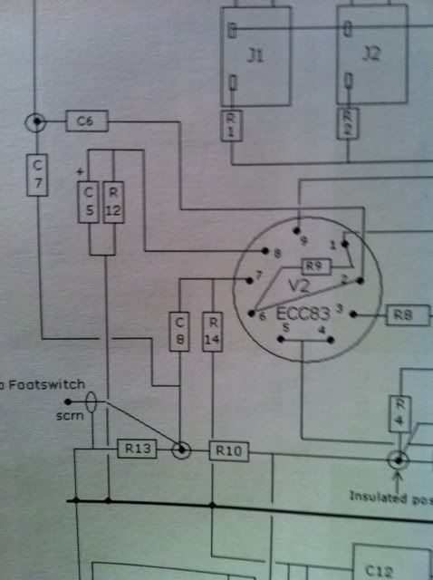

The thing that's throwing me off right now is that on the layouts I have, on V2 pin 6 is connected to pin 2 which then goes to C6.  Perhaps this picture will help.
Where as on the schematic C6 is connected directly to pin 6 and R9 and it appears that pin 2 is unused.  What do you make of that?

The thing that's throwing me off right now is that on the layouts I have, on V2 pin 6 is connected to pin 2 which then goes to C6.  Perhaps this picture will help...
It's the same thing. Pins 6,7,8 are the trem oscillator. The signal from the plate (pin 6) is directly coupled to the grid (pin 2) of a cathode follower. Pins 1,2,3 are the cathode follower. That schematic shows a connection between pin 6 and 2 but the vertical part of the line did not scan well. It's there though.

The tremolo should be fairly easy to troubleshoot. I'd start by double checking the wiring for V2 and also be sure that 100K resistor is connected between V2-3 and V1-3. Measure all voltages on V2 and compare to schematic. Post them here too. V2-7 is not listed on the schematic but it should be zero. The footswitch contacts needs to be open for the trem to work. Take two sets of V2 voltages, one with the F/S open, and another with it closed. With the switch closed the trem will be defeated and all V2 voltages will be steady. With the switch open the trem will be enabled and the voltages on V2 pins 6, 2, and 3, should be fluctuating at the trem speed. The fluctuations will just appear to be erratic readings on a DVM, but you can actually see the smooth changes on an analog meter. Fluctuating voltages means the trem oscillator is working.

That means the oscillator is not working. Concentrate on the wiring for V2-6,7, and 8 and associated components.
Any chance you could scan the entire layout rather than just bits and pieces?

Ya know, I was thinking about that and I feel like it's a little unethical. The schematic is public domain I guess but the guy that made that book spent time and effort redrawing everything and cleaning it up. What do you think?
  • Posts: 5275
Re: New AC4 build trem and 1 tube reverb not working
« Reply #8 on: April 09, 2011, 01:43:14 pm »
I think it would help get your tremolo fixed.

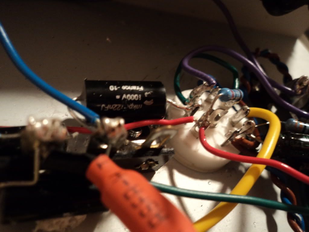

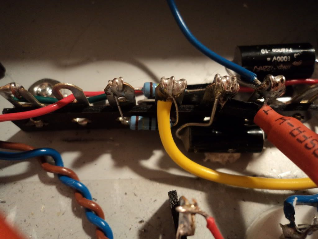

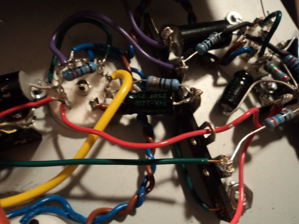

Here's some pics...
And the layout...
Let me know if you can think of anything else to check or if anything jumps out at you as a problem.

Man I just can't find it.  I've been over the layout and schematic 100 times.  The only thing I can find that I did differently is the B+ goes from the first filter cap to the power tube, then V2 then over to V1 as opposed to splitting after the power tube and going to the preamp tubes.  I guess I would describe it as series rather than parallel.  I really don't know if that would keep V2 from oscillating or not.
  • Posts: 5275
« Reply #12 on: April 17, 2011, 08:30:24 am »
I still think it's a wiring error although I can't see it in the pics.
