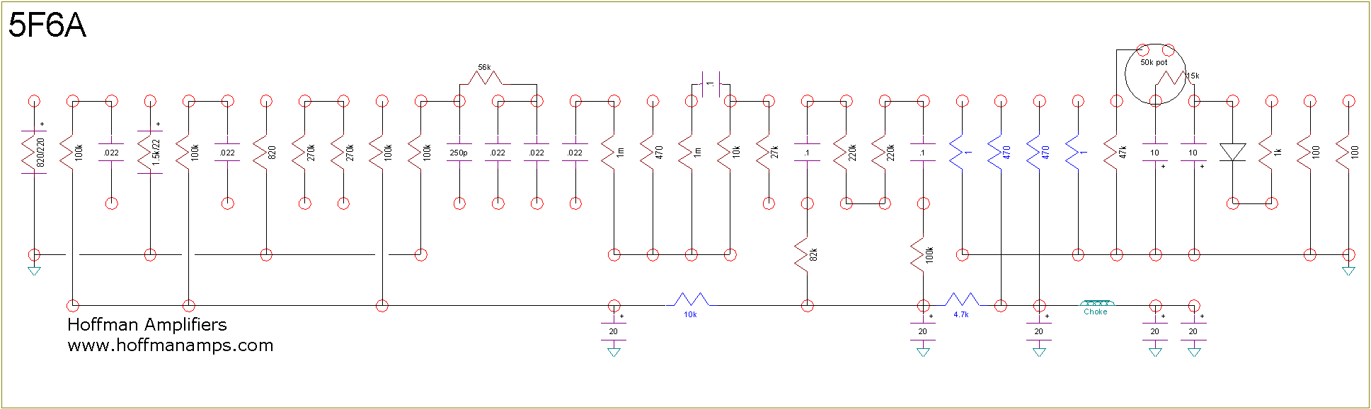

Don't know if you decided topology towards AB763, but I would suggest 5F6-A.
Hoffman has proven layouts for both amps:
http://www.el34world.com/Hoffman/images/AB763New.gif
http://www.el34world.com/Hoffman/images/5f6ANew.gif

thank all of you for the responses so far.  i had considered the 5F6A since it is one of leo's best and being for bass it was designed to be more clean.  i guess i really don't have enough experience with hi fi amps to really know the distinct differences between them and most guitar amp circuits to know what is or isn't coloring the signal too much.  i know i will find some answers if i dig deeper through the topics here but i have found that sites dedicated to amps that play recorded music and others that are dedicated to guitar amps have differences in the approach.  the price difference is too far out to try to build the equivalent of a macintosh--it's like yachts and working fishing boats.

i guess i am trying to understand why, for example, the ab763 is a cleaner amp than the 5f6a when to a guy like me there are many similarities.  think of me as a guy who knows oso buco is a great dish but doesn't know why the oso buco at frascatti is better than the olive garden. while i can build and repair an amp from a schematic and layout i am wanting to understand more about the finer points.  like the slope resistor value earlier mentioned here, or why a hoffman, heyboer, or chino special trannie all sound different.  maybe this is why decade boxes are among my most used tools.  i hunt and peck till i get what i want but would really like to know more about the theory behind what certain points in an amp make it cleaner of fuzzier or more distorted etc.  probably way beyond the scope of a single thread but probably everyone that reads this has or will be at the same point i am right now.  i'm just having so much fun and satisfaction building and repairing tube gear i feel it is time to learn to be a better cook---and come up with a few more of my own recipies.

i guess i am trying to understand why, for example, the ab763 is a cleaner amp than the 5f6a when...there are many similarities.
The similarities between the AB763 and the 5F6A are limited to the simple fact that both amps use tubes, capacitors, resistors, transformers and wire.  Beyond these sundry items, there are no other similarities shared in those circuits.  Worlds apart.
The topology is totally different, the gainstages are different, the preamp voltages are different, the tonestack is voiced differently, cathode follower vs plate fed tonestack...ect.
AB763 was designed after the 5F6A to satisfy players needs for a louder and cleaner sound.
I even like the Silverface 12AT7 PI values, as it sounds nice and punchy.
Keep the preamp voltages up around 250v on the preamp plates, 450+ on the power section.
Make sure to use the 220k to ground at the Phase inverter entrance as shown in the layout in my earlier post and that will keep the amp a bit cleaner.
