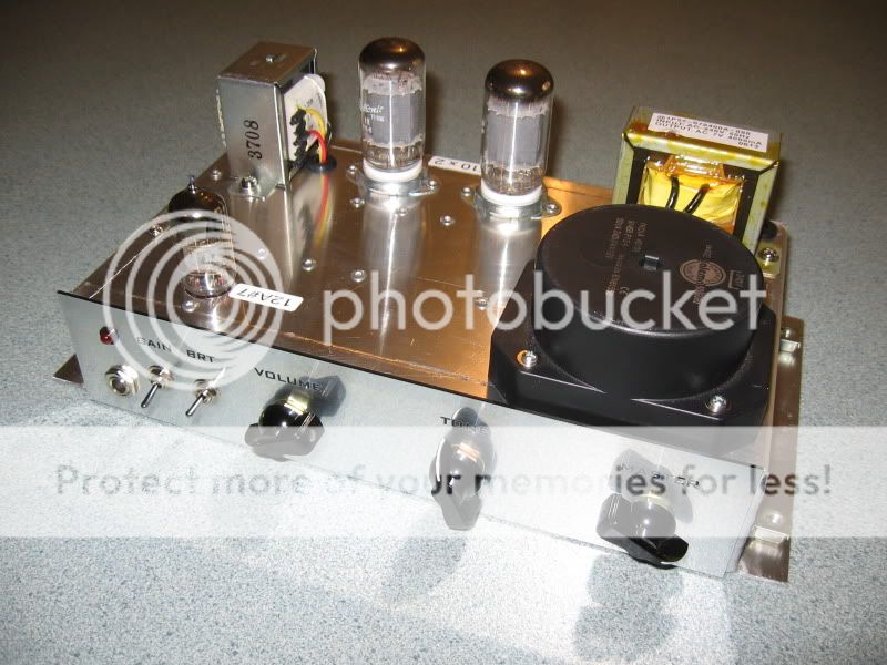

may be is better the 6AR11 rest in my junk box (at € 1.00 I can permit myself to get a "wrong" tube)
I'm still collecting spare parts to build the 6AF11 "Squirrel Monkey" amp, results are sure because the project was build and tested
