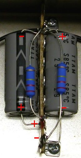

I don't fancy multi section caps for new builds as their architecture - a single common ground - can bring unwanted noise. Two sections caps on two similarly grounded nodes are OK, for instance plates + screens or two preamp sections from the same dual triode.
You can consider using a couple of terminal strips holding the caps.
Or go for distributed filtering (best), either with the caps on board between nodes or connected between the board and chassis buss wire.
Pix from the Filter Caps page in Doug's library of info http://www.el34world.com/charts/filtercaps.htm
