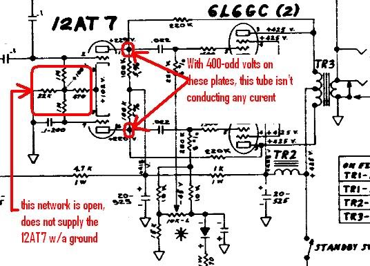

I just tried to start up the ab165 Bassman head I have been working on and I have power, but no sound.  :cussing: :cussing: I went through and checked my resistors and caps, and all looks good. I was wondering if someone could look at the pin voltages I put into the cool program here and tell me if there is a clue? I have been working on this thing for months...

on your 6l6, you should have around 450VDC, via a 470 / 1W resistor (screen grid). On pin 8, you should have 0V (ground). On pin 5 (grid) you should have around -45VDC (Bias voltage).
your preamp tubes voltage are not good; you should measure around 250/260V on plates, between 1.5 to 2V on cathodes. PI tube: around 100V on cathodes, 220/230V on plates.
I would deeply investigate the power rail, ground connections, heaters and wiring dress/solders.

It's curious to me that you show big + volts on the plates of your 6L6 tubes and NO bias voltage on pin 5 of either tube. If the cathodes of those tubes are grounded, the plates of those tubes should be glowing bright screaming red hot and maybe even blowing the fuse. No way you would not notice that, to put it mildly.
Thus I am going to assume that the "-" you have on those 6L6 pin 5's is the negative bias required to keep those tubes from blowing up. (Or they'd be blown up)
The preamp tube voltages look fairly nominal. On the plates of your phase splitter, however, V3, you have big (~~400) volts which could only happen if that tube is not conducting anything. Thus I'd have to suspect something in the "+" shaped resistor network from the cathodes of that phase splitter tube to ground. That 12AT7 has no "ground" connection.
+1.
I had some strange PI volts and it turned out to be a cold solder joint exactly on the ground tie point for the tail resistor.

Eleventeen- You assume correctly! I didnt enter the voltages- long night I guess...I have -045v on both pin 5's, and according to Danksman's numbers, it  looks like normal voltages on the other pins for the power tubes.  The 12ax7's are another matter!
Danskman- Thanks for the values, sounds like I have a lot of work ahead of me unfortunately, but it is a relief to know the proper values I am shooting for...
I am initially suspicious of the ground wire under the board that starts from the 22k resistor in the "+" section and ends under the board at the top of the 1500 resistor/ 25/25 cap pair in V4, because pin 3 on V4 reads "0" and it should read 1.5-2v per Danksman. And I did a shitty job of making sure it was still connected underneath...Does that sound like it might cause these problems?
And thanks again, you have really helped. Hopefully I will be playing really really loud guitar in the next week or so... :m7 :m7

That could absolutely do it. With power off and HV VERY WELL bled (don't leave that step out!!) just buzz the the connection between the "cold" end of the 22K and ground. (that would be the west end on both the schematic and the layout, the side that DOESN'T go to the junction of the dual 1 Megs) If it's anything but almost zero, that's your dude. Don't kill yourself pulling it all out. Just run another short wire from the junction of the 22K and the .1 uf to the ground eyelet for those dual 25/25 caps those on top of the board and be done with it. THAT connection, with so many leads going to it, could be iffy...and cold-soldered. Make sure it's a nice looking solder joint when you're done.
On power up, the (common) cathodes (pins 3 & 8) of the phase inverter should be 100-110 volts.

T'would seem like it...that's most likely the resistance of your test leads. Are you measuring to real amp ground (like the brass strip under the controls) or just measuring to the blob of solder on the negatives of those caps?
You pulled the tube out of the socket and made sure there isn't some hairline crack in a pin? Tube in-tube out-tube in, to clean the contacts some? Maybe change 12AT7's? Any 12A_7 tube will work for a quick test.
With the amp powered on, what kind of volts do you see on the 12AT7 phase splitter cathodes? Should be right around 100 volts.
Does that damn tube light up?? It might act the way you're saying if the filament was dead! If the green heater wires successfully make the pass-through connection to the other tubes but somehow don't light that one up, that could do this too. Yeah, I know, bizarre. I see you show 7 volts on the cathodes. That tube isn't conducting spit!

I measured from the brass piece and I tried the silver wire coming out of the bottom of the 1500 Resistors/25/25 caps.
I changed out the tube and got the same on pins 3/8 - 6-7 volts...
This is interesting. I turned out the lights and checked the tubes. V3 V4 V6 didnt glow. It looked like they might have had a tiny speck of light somewhere inside at the top, but almost imperceptible.
These are all new tubes (I have had them for a year or so, but not used)
The only thing I havent done to this amp is clean up/replace the tube sockets.....I will check the heater wires tonight

Well, at this point, a true e-detective would measure filament volts at the first through third preamp tubes and wiggle various wires. You may have a broken wire somewhere in the filament string. Or, perhaps a hairline crack across a tube socket pin where the through-connection is good but the filament power doesn't quite get to (in this case) the phase splitter. Or, a cold solder joint where the filament wires, again, make the through connection to each other but do not connect to the particular tube the connection is made on. Pretty danged weird!
Maybe I would get some clip leads and measure filament volts on the 12AX7 farthest from the power transformer by clipping them onto that last tube socket. Then go wiggling wires.
You could try to search out the problem or just reheat all the filament connections with a tiny bit of new solder added to each to reflux the connections.

Still got only 7 VDC at that network node on the PI? (where there should be ~~100V?)
First preamp tubes light up?
Good heater volts at the first preamp tube? Measure a few other places too, just for grins.
Maybe half the 6.3 winding is NG??? (Schematics I see show a CT on this winding)

 OK- I found 2 points on the board that were open (one on that first group of three caps connecting to the deep switch, and another on the .047 cap connecting to the normal controls) They were those old blue caps and the wires were touching the solder but not attached.) Fixing them didnt seem to have much effect.
I re-measured all the voltages after I re-did the pin connections-
I still have 7v on the PI pins 3/8
Pin 6 on V6 (Bass channel) voltage kept climbing slowly- I stopped it after about 5 minutes and 470v.
Tubes are lighting up, but after the PI, they are only lit in one spot
The heater wires all check out at 2.7 and 3.2v -not sure if this is enough (5.9v total), but it is the same as before.
Im thinking I still have an open connection on the board somewhere, maybe underneath? How do I check the connections without ripping everything out? Or any other ideas?

Sounds to me like you need to get a copy of the schematic and "buzz out" each and every connection. Make sure power is off and any HV well drained. Use an ohmmeter to establish whether or not all connections are made. Best is to use a colored pencil (NOT a felt tipped something) on the schematic and a magic marker on all the solder joints on the parts board. Be conscious of grounds and grounding. If you have only the seven volts on that node we've been discussing....and you have climbing volts to the 400 range on a preamp tube, then that tube is also not conducting. My suspicion is that you've left one or more grounds out of the picture. If there are jumpers running under the board, you can see if they exist by seeing there is continuity between where the ends are supposed to go. You need to have a clip lead for at least one of your meter leads so it can be placed on a connection and left there.
At the end of this exercise, each and every wire on your schematic should be covered up with a red pencil line. Don't use felt-tip, in case you make an error. Be systematic.
Assume you are working on the 7025 at the center of your schematic.
http://www.thevintagesound.com/ffg/schem/bassman_ab165_schem.gif
You're going to have a dialog in your head like, OK, I am on the plate of this tube, pin 6. I am making sure that pin 6 is pin 6 and I haven't counted pins wrong. Yes, there is 7, 8, 9.
That plate connection goes to a 100K and a 470K and a .1 cap. Are those connections made?
The 100K is a plate load resistor, connected to the B+ rail. Find it. Zero ohms between pin 6 and one end of it? Red pencil from the plate to HALFWAY THRU the 100K.
The OTHER END of the 100K should connect to a 4.7K / 1 watt (prolly under the cap pan on top of the chassis) and a 27K / 1 watt (likewise, possibly under the cap pan) If all those connects are made, cover up the schematic lines with red pencil HALFWAY THRU whatever parts the far end of that 100K connect to. Go back to the 7025 plate, pin 6.
It also connects to a 470K and if that is there, red pencil it halfway thru the 470K.
It also connects to a .1 cap. Find that cap. Maybe mark it with your felt tip marker.
Everybody does this in a different sequence. But you have to have the layout taped to a sheet of cardboard and the schematic, likewise, and preferably on a clipboard.
From your description, you do not have a "broken amp"; you have an amp that in essence, just came off the assembly line at the factory. You do not necessarily know if mis-connections were made, you do not necessarily know if wrong-value parts were put in. There is literally nothing you can take for granted.
This is DIFFERENT than taking a working amp that stopped working.
Somehow, you must exorcise all the uncertainty out of your amp. Redlining the schematic is the general way it is done.
One by one, you need to start at a solder joint on the parts board, mark it in some way, and ascertain that whatever wire is connected to it goes to where it is supposed to go. This sounds like a project that was started and then put away for some time. We all have one or more of those. Memory is useless in these situations.
You need to go through the exercise of confirming that every wire and every component you see on the parts board goes where it is supposed to go and makes a valid connection thereto. Useful is an ohmmeter with a "beep" for continuity.
