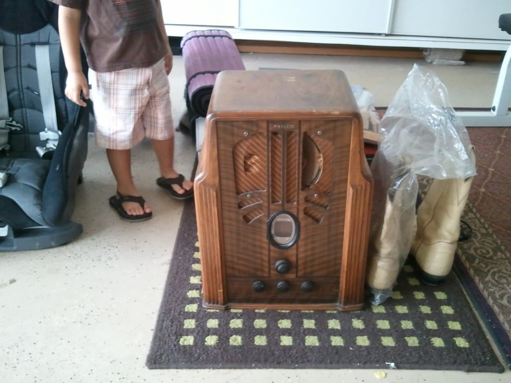

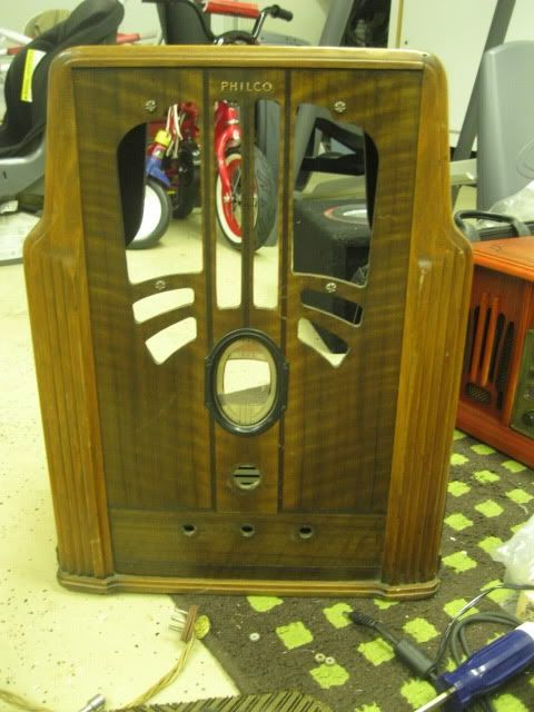

I picked up a vintage Philco radio from a Garage sale a few days ago.  It doesnt work, all the tubes are gone and the the speaker is shot.  Originally my wife just wanted to use it as decoration, but I figure why not do something cool with it.
SO, I want to build it into a simple guitar tube amp.  I was leaning towards a champ, but I am open to suggestions.  There are a few specific things I want from this build.
1.  I dont want to modify the original radio cabinet.
2.  Since its got 4 knobs originally, I can only have 4 knobs/switches, inputs total.  So probably a power switch, input jack, volume, and either gain or tone.
3.  It will only take a 6" speaker, so power will have to be fairly low.  Maybe 5-10 watts.
4.  I would like to use the original radio output transformer, but I realize that I am asking alot with this one.
I hope to not spend too much $$$, and I have a box of misc amp parts from a build that I did about 10 years ago.
Does anyone have a suggestion/schematic for what I should build? I am a real newbie with amp building and have only ever built a preamp, so it needs to be pretty straight forward.
Thanks!

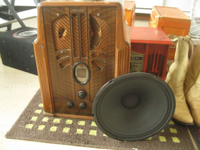

Here is a pic of the radio. I will get pics of the rear later.

I love that radio cabinet!  Beautiful wood. Craftsmanship back then was incredible.  It should have something nice done with it.  Looks like maybe a 8" speaker would work or a 10"?

Must be a perspective thing, but that looks bigger than a 6" speaker.
what is the tube compliment?
does it have a 6.3 and 5V tap? or will you not salvage the PT?
That sure is some pretty veneer!
It was likely finished in shellac or varnish but nitro is not out of the question either.
Do you plan a refinish? or leave the patina?
Cool project!

I am definatly going to keep the patina.  the only thing I will replace is the grille cloth since it ripped.  I am going to get some pics of the inside of it and the other parts I have and will post them when I have a chance.

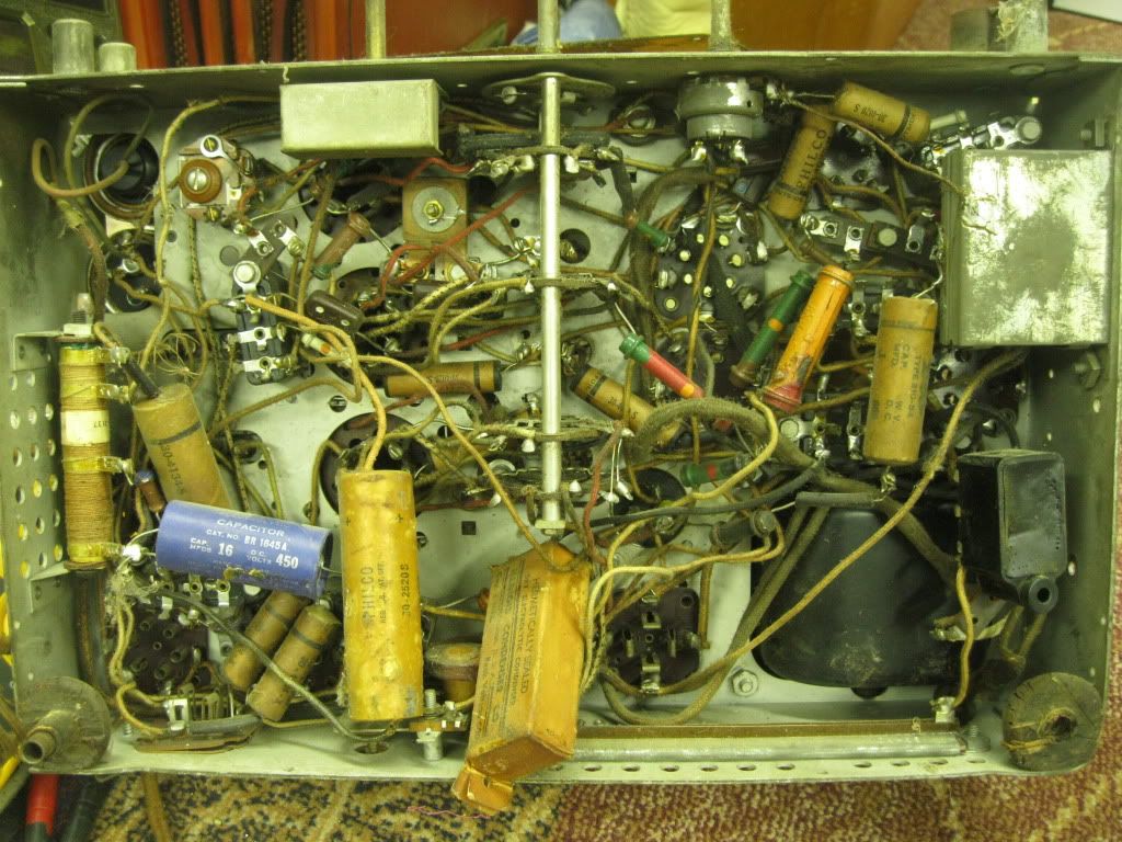

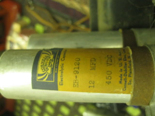

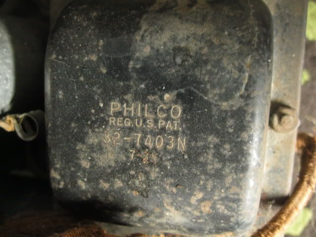

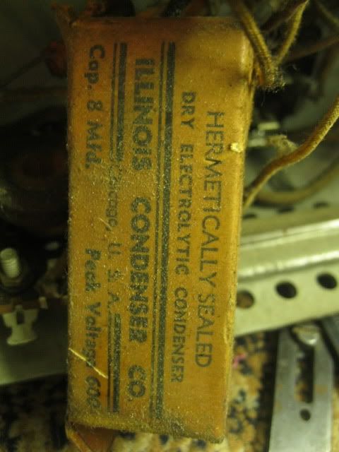

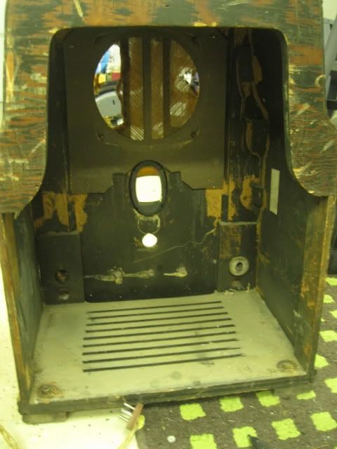

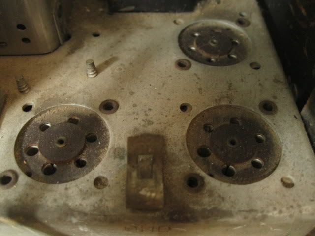

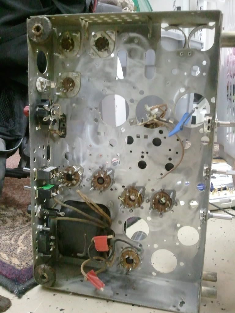

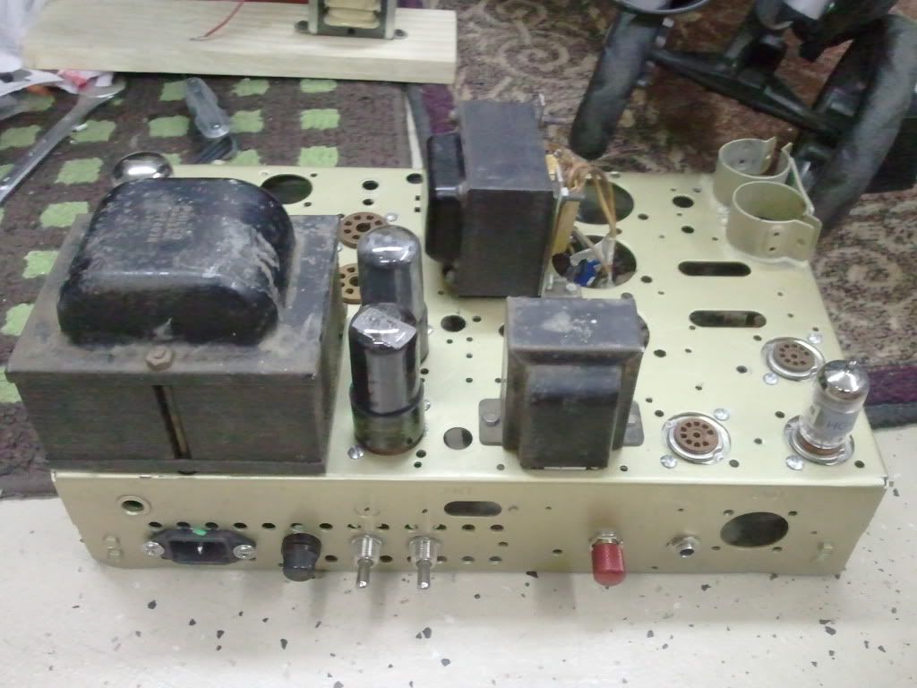

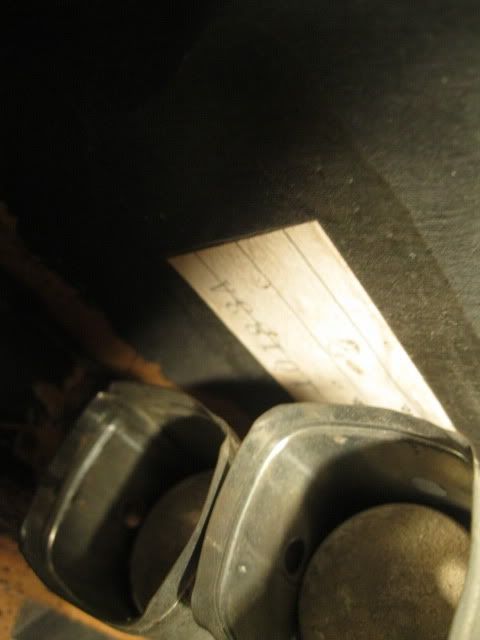

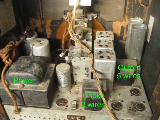

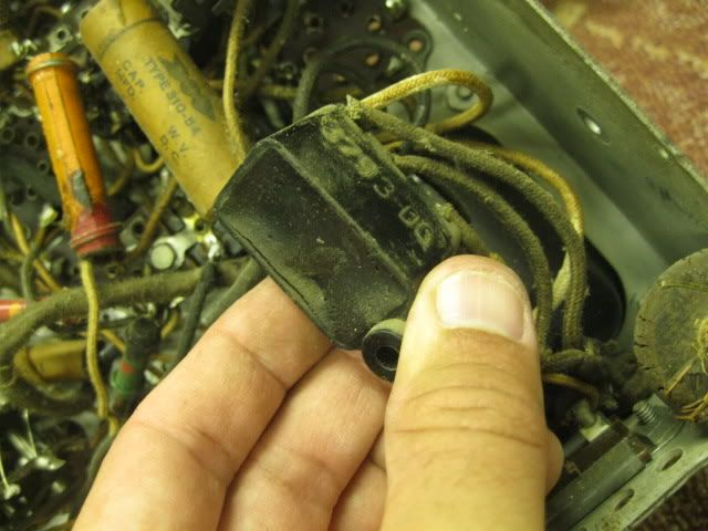

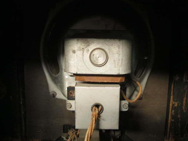

OK,  Here are some pics of exactly what I got.  Some good, some bad:
The Front:
http://i268.photobucket.com/albums/jj26/thebattens/IMG_5569.jpg
The Back:
http://i268.photobucket.com/albums/jj26/thebattens/IMG_5570.jpg
http://i268.photobucket.com/albums/jj26/thebattens/IMG_5571.jpg
http://i268.photobucket.com/albums/jj26/thebattens/IMG_5572.jpg
http://i268.photobucket.com/albums/jj26/thebattens/IMG_5573.jpg
http://i268.photobucket.com/albums/jj26/thebattens/IMG_5574.jpg
http://i268.photobucket.com/albums/jj26/thebattens/IMG_5575.jpg
http://i268.photobucket.com/albums/jj26/thebattens/IMG_5576.jpg
http://i268.photobucket.com/albums/jj26/thebattens/IMG_5577.jpg
http://i268.photobucket.com/albums/jj26/thebattens/IMG_5578.jpg
http://i268.photobucket.com/albums/jj26/thebattens/IMG_5579.jpg

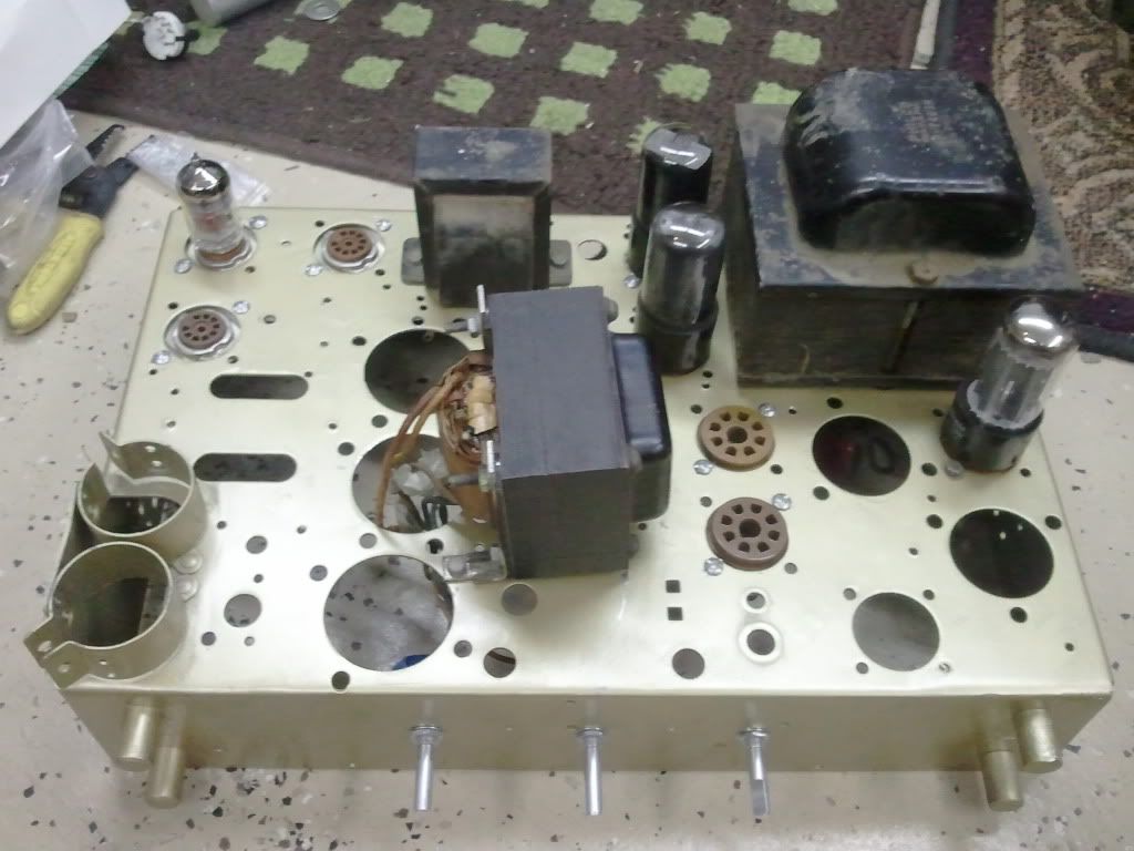

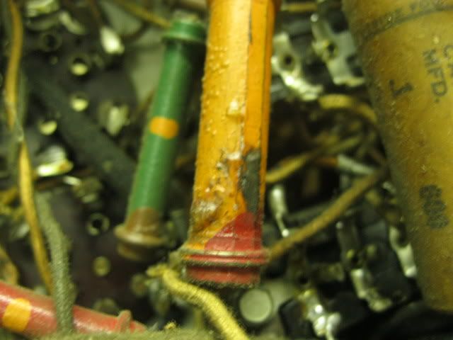

Here are some parts I have that I can use:
Caps, resistors, tubes, sockets, turrets, diodes, etc:
http://i268.photobucket.com/albums/jj26/thebattens/IMG_5580.jpg[/img]
http://i268.photobucket.com/albums/jj26/thebattens/IMG_5581.jpg[/img]

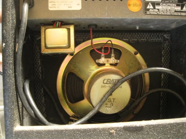

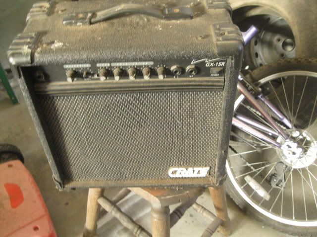

A little crate amp I can rob stuff from, maybe the OT:
http://i268.photobucket.com/albums/jj26/thebattens/IMG_5585.jpg
http://i268.photobucket.com/albums/jj26/thebattens/IMG_5583.jpg
http://i268.photobucket.com/albums/jj26/thebattens/IMG_5584.jpg

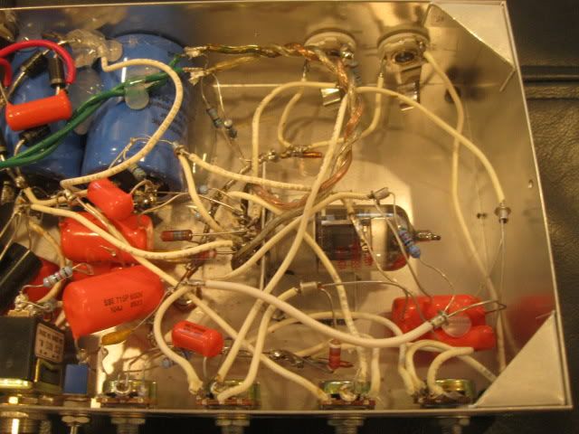

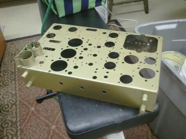

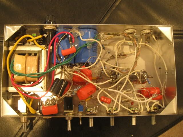

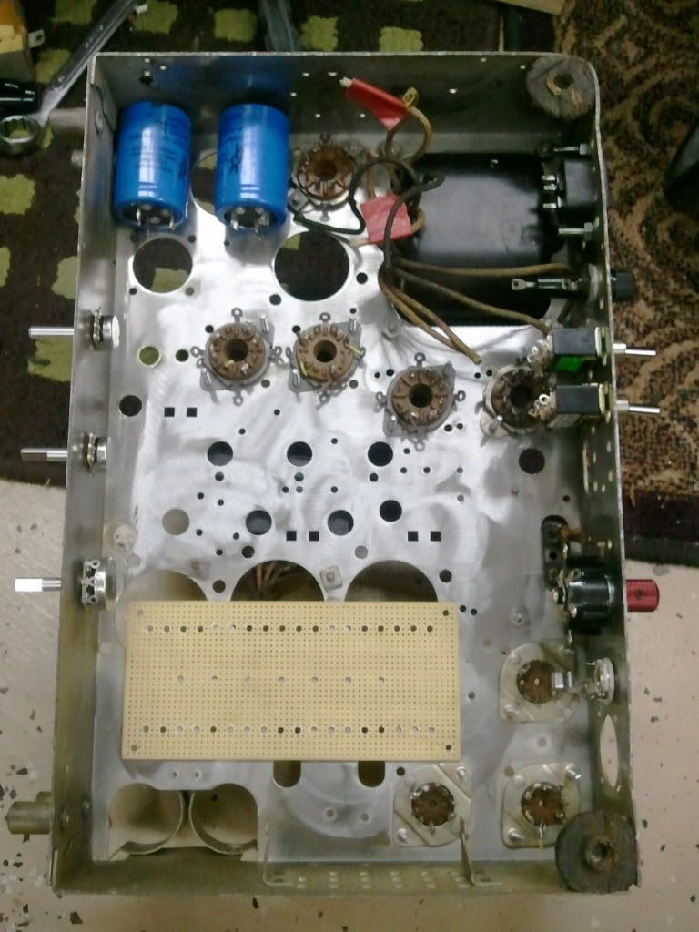

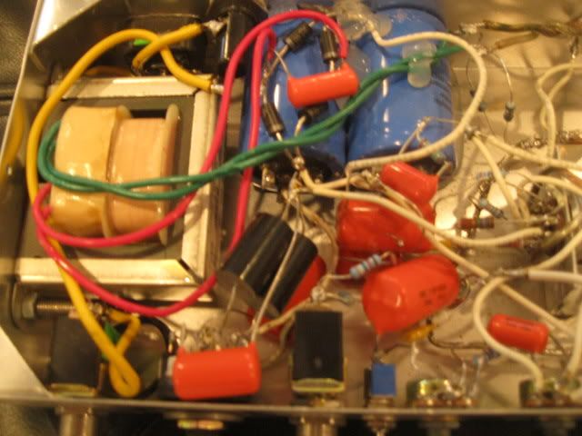

This is my first build ever, its the preamp section on an Ampeg B15n.  I can rob it of parts it need be because it doesnt sound very good:
http://i268.photobucket.com/albums/jj26/thebattens/IMG_5590.jpg
http://i268.photobucket.com/albums/jj26/thebattens/IMG_5593.jpg
http://i268.photobucket.com/albums/jj26/thebattens/IMG_5592.jpg
http://i268.photobucket.com/albums/jj26/thebattens/IMG_5591.jpg

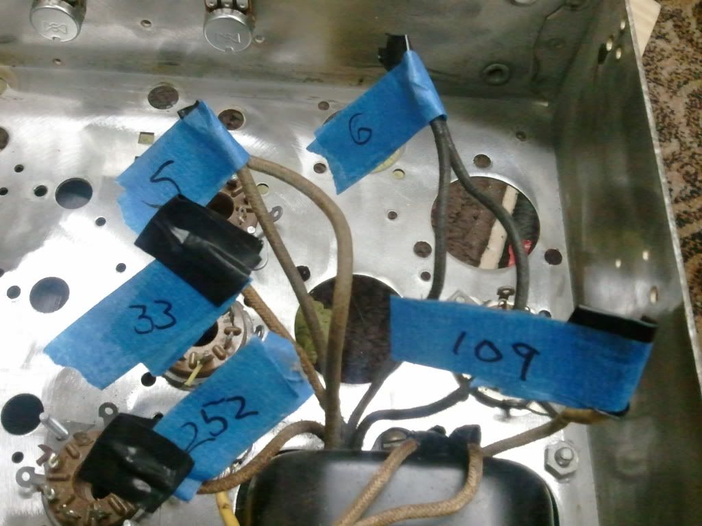

And HERE Is the coolest part of the whole deal
http://i268.photobucket.com/albums/jj26/thebattens/IMG_5589.jpg
http://i268.photobucket.com/albums/jj26/thebattens/IMG_5586.jpg
http://i268.photobucket.com/albums/jj26/thebattens/IMG_5588.jpg
http://i268.photobucket.com/albums/jj26/thebattens/IMG_5587.jpg

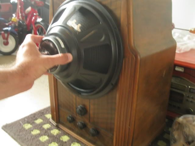

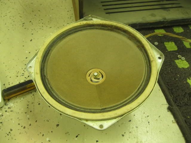

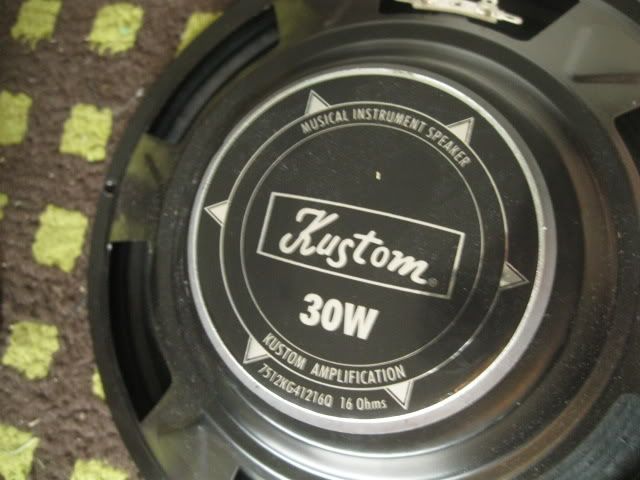

Looks like I can squeeze a 12" speaker in with a little work.  That will make a HUGE difference.
OK boys, start throwing your ideas at me.  I really want to do this!  I bet with what I have and what I want to do, I can do the whole thing for $100 out of pocket.

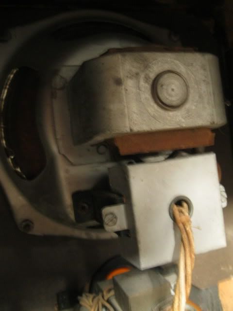

Re: Amp Build From a Vintage Radio
« Reply #18 on: September 15, 2011, 09:39:58 pm »

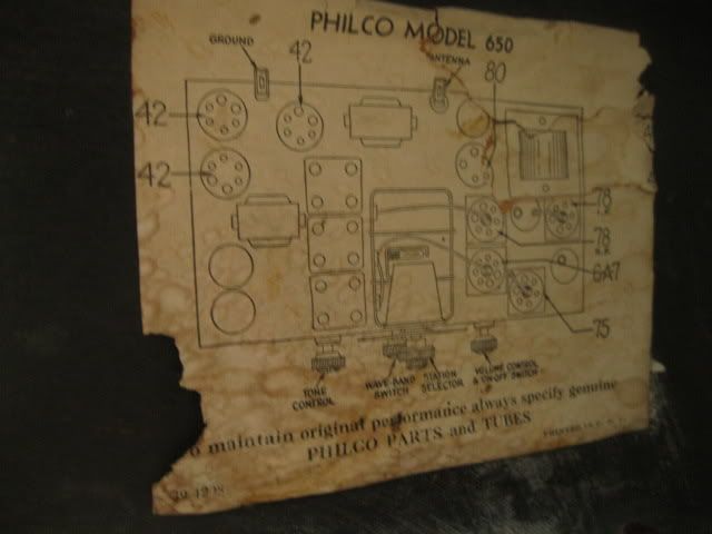

It really should be repaired.
It would be a sweet guitar amp.
Recall that Tweed Champ and Princeton _ARE_ radio parts and circuit minus tuner. The parts Leo got in late 1940s are cheap generics of what Philco used in 1935.
'75 is a half-12AX7.
'42 is a 6F6 on a 6-pin base. 6F6 is a lower-gain precursor to the 6V6.
'80 is 5Y3 on 4-pin base.
A '75 is only $13. '42 can be had for $23 or less. '80s go for $70!
If you drill the socket rivets you can probably drop octal sockets right in, use 6F6 directly or 6V6 with mods.
The only non-Tweed bit is the SE power stage and interstage transformer, and the final stage working in AB2 Triode mode. Might not be raucous enough for a tavern, might be fine for the parlor.
Challenges: the grid bias is back-bias, needs ALL the radio current including tuner plus the field-coil current. The wiring will probably make you insane.
There's something wired to the top of the volume control. Cut it. Feed an iPod here, it will work fine (after repair). Tone self-adjusts at lower volumes, you also have four switch settings. For guitar you would need one more stage.
The PT, choke, and OT can be used directly in any modest two-6V6 plan.
3-pin cord of course.
« Reply #19 on: September 15, 2011, 09:43:29 pm »
The Phico OT is surely 3-4 ohms. Your 16 ohm monster will be a very poor match.
I like the look, but a parlor radio should be 6" or 8", maybe 10" if the power stage is weak. A 12" is really too big IMO.

« Reply #20 on: September 15, 2011, 10:14:55 pm »
PRR- Thanks for taking the time to type all that.  There is really some good info there.
I can get a 4 ohm 12" if I need to.  Or I have the 4 ohm 8" in the crate amp.   What would a modest two-6V6 plan be?  And should I lean towards that instead of a champ? I wish I knew more about electronics and building amps, but at this point about all I can do is follow a schematic.   Its funny, I used to be an electrician.  I can wire a mansion by myself, but cant wire an amp without a guide.
Also, I like the idea of using a volume now withe the on/off built in.  Now I have room for a 3 knob setup!

And what would happen if I used the Philco output transformer in a champ build?  Is it a problem to use a transformer that is too big?

OK, well after spending half the night up looking up info and staring at schematics I think I have figured out where I am going with this.
It will basically be a Champ AA764 with a switched volume.  That way I have volume, bass and trebel control.  I will use the 4ohm 8" speaker from my little crate amp.  And I will use the transformers from the original radio.  This is assuming that I can use the output transformer with a single 6V6GT without any problems, and assuming the original transformers work.  I think the only thing I will have to buy are a couple tubes, and the switched volume pot.
If anyone has input, I would greatly appreciate it!
Other option is a Champ 5F1 with an added tone stack.

Output Transformer- All you need is the proper impedance ratio and the wattage capacity.  It sounds like the OT is big enough to handle an SE 6V6.  You get impedance for a given load, your 4 Ohm speaker, by multiplying the square of the turns ratio by theactual load impedance. To determine turns ratio, put a convenient small AC voltage on the primary, like 10 VAC from your Variac.  Measure the secondary voltage right around .27 VAC-  This would give you a turns ratio of 37:1.  Square that for 1369.  1369 x 4 =5476 Ohms.  Pretty good for a 6V6 class A nominal load of 5500.  If you don't have a variac, see if you have a wall wart transformer that has an AC output, like 9VAC.  Use the same formulas substituting 9VAC.  Allbest, Larry
Great info.  Thanks.

The speaker is definatly an 8", so I will use the speaker out of my little Crate amp.

> are these labeled correctly?
No. The OT is on the speaker. What you marked is the driver transformer. Innerestingly the DT cost more than the OT. (In part this is SE/PP difference.)
PM me an email address where you can take a 2MB PDF file, I'll give you full schematic and excellent parts layout diagram. Philco documented this stuff well.
I spotted one odd thing. The schematic shows "1.11 ohm" next to the speaker voice coil. This may actually include the OT winding. Can you break a connection from OT (which is on the speaker!) to voice coil, and read the voice coil alone? If it is 3 or 6 ohms, then it is wound for 4 or 8 ohm close-enuf. If the VC is really 1.11 ohm DC, then it is a "1.3 ohm nominal" speaker and that's very awkward.
The main filter-caps are the round cans inside "TV-shape" shields, a very odd thing. The service data confirms they are electrolytic (thus now scrap) and you can get new ones for $1.10-$1.80 (if this were the 1930s all over again!).
Otherwise....
Have parts been removed other than tubes? Has the cloth rotted off the wires real bad? Have you seen seriously burnt/melted parts?
If not, then it really is less work, the way I see it, to replace the rotten and obsolete audio bits than to rip and ravage. (I'm NOT talking about fixing the tuner; it likely just needs tubes, and is the best AM you will ever hear, but the AM band is crap and better SW radios are cheap.)
replace these caps:
C55 0.02u
C63 0.05u
C59 0.25u
C77 10u 75V + 8u 450V (100u 50V + 22u 450V)
C78 8u 450V (22u)
C71 3u (22u 400V)
three '42 sockets change to octal H H K G1 G2 P
verify 9-11 ohms at "10 ohm" tap on R66
short live end of R66 to center-tap, adjust for 200 ohms to ground
replace field-coil with 1K 10W resistor
two 1N4007 and two 250r 10W resistors on '80 socket (genuine high-loss 5Y3 hard to get)
three 6V6
smoke-test, quickly verify -1.0V at 10 ohm tap
squirt volume pot, tone switch
snip top of volume pot, feed iPod
build 1-stage guitar preamp

I have the bassman preamp that I posted pics of earlier.  I can use that as a preamp I guess?

That speaker is repairable with rubber cement and tissue.

> The OT ...has 4 wires in and 2 out to the speaker.
The field-coil is also in there. One end is high B+ and OT CT. The other end comes back to power the low B+ loads.

I took my radio to a local amp builder that I know.  He is a super cool guy and he helped me get together a game plan.  I also got my tubes, sockets, and a nice used 20watt output transformer that has 4, 8, and 16 ohm output.  He also gave me some grille cloth.
So, Heres the plan.
Use the stock power trans, and choke.
5y3 Rectifier
1 12ax7 preamp for now, but possible add 2 more preamp tubes later.
2 6v6 power stage
20 watt, selectable impedance out put trans.
When I got home, I stripped the chassis, got the enture thing to bare metal, and painted the outside metallic gold.
Here are some cell phone pics:
OK, come on now, how did you strip it/get it to look like that???        :undecided:

I used a flap disc in a 4" grinder.   I am also building a 51 Chevy and have been doing a lot of custom body work.  So for me the metal work is the easy part.

I got the layout for the chassis figured out today.  Here is a a couple pics of where I am at so far, If you see any problems with this layout, please let me know:
Here is the inside,  nice and roomy:
I had a few extra tube sockets, so I used them to fill in some of the holes.  There are 2 extra octal and 2 extra small 9 pin sockets.  I would like to use them and was wondering if I should plan a second channel or something while I am at this stage.  What do you think?
Here is how my power tranny read out:
There are 9 wires total.  I marked the primary before I took it out of the original setup, so that was easy.
There are 2 wires that are black, they are 120v each or 6v together.  This must be for the Filaments
Thera are 2 brown wires that are 74v and 75v each or 5v together.  These must be for the rectifier
And then there are 3 tan colored wires:  Here lies the question.
The separate voltages to ground are 33v, 252v, and 109v
The 33 and 109 together = 410v
The 252 and 109 together = 410v
And the 33 and 252 together = more than my meter can read.
This leads me to think that the 109 wire is the center tap, but I may be wrong.  Also I THINK that originally the 109 wire went off by itself somewhere...
Does this make sense?
« Last Edit: September 25, 2011, 12:32:13 am by blown240 »
« Reply #46 on: September 26, 2011, 12:38:37 am »
When ALL winding ends/taps are lifted from ground, the "to ground" voltage readings are practically bogus.
I wish you had noted goes-to-what before you (expertly) chopped. It hasn't changed much. Two HV ends go to rectifier plates. The CT often goes to ground, though Philco took it a few hundred ohms "below ground" to get bias.
Resistance readings should suggest which is CT.

I checked the resistance readings and from what I found the CT is what I thought it was.  Yesterday I got all the heater wires and the rectifier done.  I am getting 368v on the B+ coming off the rectifier (using a 5Y3GT).
