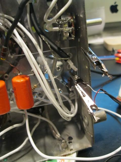

I want you to make a few resistance checks with amp turned off. Clip one meter lead on chassis. Clip the other meter lead directly on the following tube pins. V2-8 and then V2-7.
I want one number for V2-8 and I want two numbers for V2-7 (one with treble pot max CW and another with treble pot max CCW.
Also, how is that ground buss connected to chassis? Is that chassis painted on the inside? If so, be sure to scrape off the paint at any point where you make a connection to the chassis. Don't try to solder to your chassis. Use screws, nuts, and star washers (or kep nuts) to make chassis connections.
And one final thing. Connect a jumper wire to chassis and connect the other end directly to V2-7. Be careful to get the right pin and only the right pin. Turn the amp on. Does V2-7 read zero volts now?
v7-p2  treble down = 995;  treble up = 1501
v2-p8 is 002 either way
Ground wire it bolted to the chassis at both ends, one end is a ring terminal, the other side is thru the ground block that is bolted to the chassis, no star washers.
Chassis is bare clean metal at both places.
Jumper wire from p2-7 to chassis makes between 0 and .1 volts.  It makes the tubes arc though, and none of the knobs do anything.
Which tubes arc? All of them?
You have at least one more wiring error. If you can't find it, then consider ripping out all the wiring and start fresh. Or take it to someone who can find it. Your odd layout and schematic combined with all white wiring will make it a huge challenge for any of us to spot the problem via pictures. Someone needs to have the amp in hand to unravel this mystery.
Think about this... The first time you posted voltages, V2-7 was fine. Now it's not. What changed? Also, your bias supply is the only source of negative voltage in that amp. And V2 ain't supposed to be connected to the bias supply.
I've held off saying anything about your layout and wiring job because I didn't want to sound condescending or discourage you. But it's time to say it. Your wiring sucks and it's probably the root of most of your problems. This criticism is meant to help, not to hurt your feelings.

The thing that changed was when I found there was a jumper missing from pin3 to pin8 of the 12ax7 in the power stage.  Before that I had good voltages, but no output.
Actually, shortly after finding the missing jumper, you also found a missing 4.7K resistor in the cathode circuit of the PI. The PI voltages got happy after you put that resistor in, but about that same time V2-7 went to negative 37V.
A bad socket will not put a negative voltage on V2-7. Bad wiring will.
There cannot be negative 37 volts on V2-7 unless it's wired wrong. I can't see that wiring error without having my hands on the amp, but it's there. You just have to keep looking.

Pn 5 on the output tube get me -34.  When I turn the volume and treble to get the tubes really screaming, pin 5 gets to about -37 to -38.    Doing the jumper from v2-p7 to ground keeps the pin5 at -34.
The3 lug grounding block wasnt soldered to the chassis.  It was bolted, but I took it out and put a ring terminal in its place.

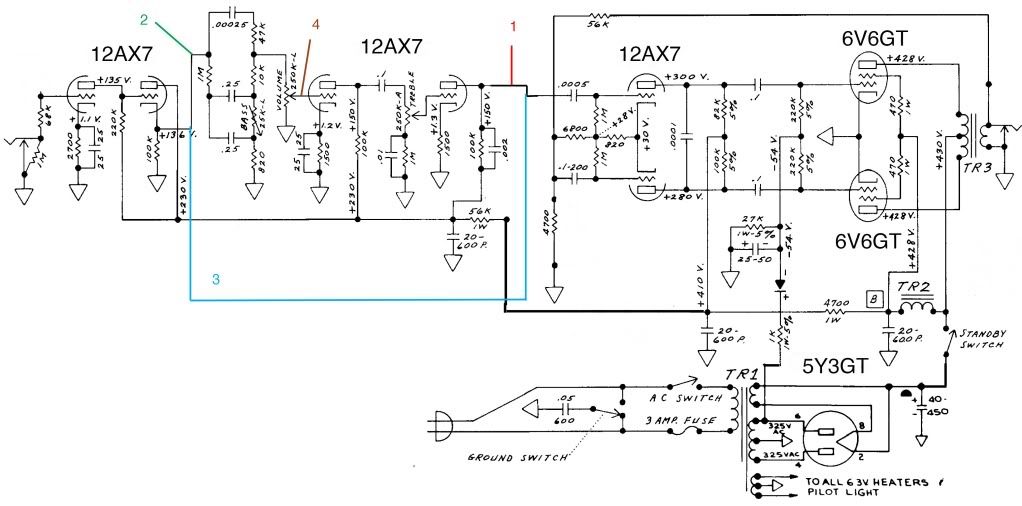

I did a little experiment this morning after tracing all the connections in the PI and power stage.  Everything was correct.
First I pulled the preamp tubes. Then I took my phone and clipped it in where the preamp section and the power stage come together.  This is with the NFB disconnected.
Here is the result:
http://youtu.be/38xrKoFLW00
So other than what sounds like a heater hum, I would say the power stage is fine.  Does anyone disagree?
Since I have a test method that seems to work, I came up with some other test points that I will try:
1.  Already tried.  Seems to point to the Preamp being the issue
2.  With the first preamp tube out, tie in right before the tone stack.
3.  With the second preamp tube out, jump from the first tube to the powerstage.  This will bypass the tone circuit and the 2nd tube.
4.  With the first preamp tube out, tie in right before or after the volume.
Thoughts?

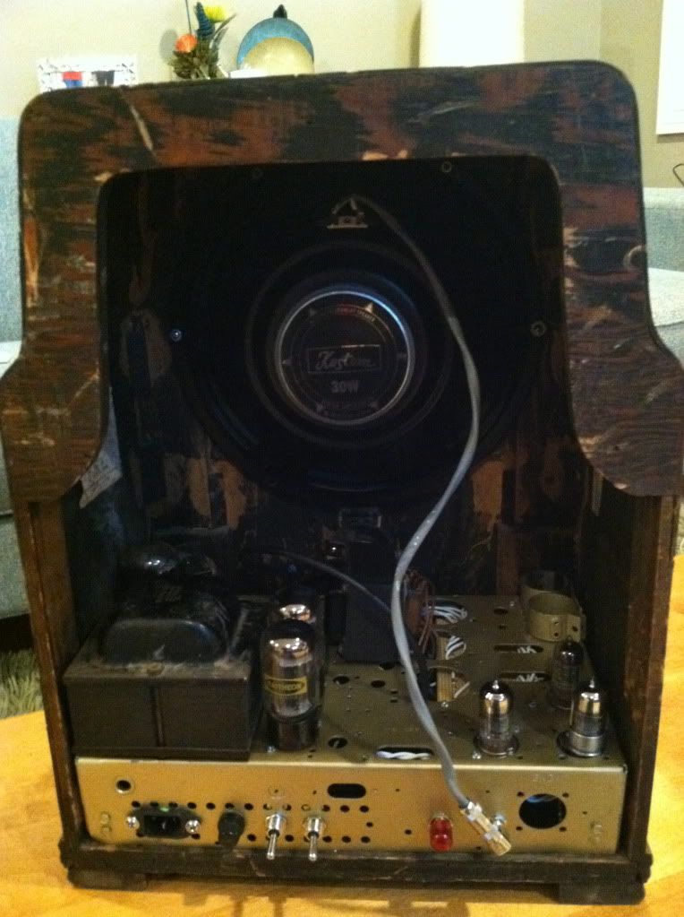

Re: Amp Build From a Vintage Radio
« Reply #178 on: November 29, 2011, 11:43:24 pm »
Two questions:
1. Have you tried to reproduce the noise with a guitar?
2. Does the amp makes the same noise when a different speaker cabinet is plugged in (not using the speaker in the Philco cab)?
It seems from the pics that the speaker is a much bigger diameter than the cutout in the baffleboard. With a bass, you might get the cone pumping with loud, low peaks. I'm thinking maybe the speaker surround is buzzing against the baffleboard during those loud peaks.
