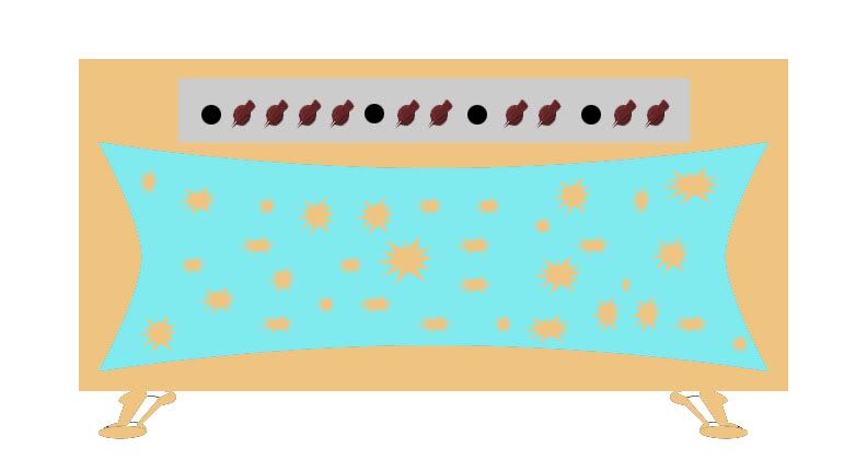

I have never worked with maple for an enclosure.  I am planning a build that will be designed after Heywood Wakefield furniture.  The cabinet will be stained maple.
Any tips for how thick the baffle needs to be, or other maple specific tips?
It hopefully will look sort of like this:

The one thing I know about maple cabinet is that it won't glue well.
Go hang on a woodworker forum.
Is the H-W stuff really solid maple, or very clever veneer? I would really want to use a less-reactive more glue-friendly wood for the carcass, and maximize utilization of precious clear-maple by slicing rather than chunking.
For your purposes: use the standard dimensions. It will be heavier than pine, but you are unlikely to be lugging this beauty in the subway. The density of maple suggests it could be enginerred thinner, but stiffness goes down WAY faster than thickness, 3/4 pine is not over-stiff, so 1/2" maple may be too thin. OTOH this is a "music creation" cabinet, not a "reproduction" cabinet, so some resonance isn't fatal. If 1/2" maple is much cheaper than the 3/4" (AND if you can get enough glue-area!), then go 1/2".

Re: Any Tips For Maple Combo Amp Cabinets?
« Reply #2 on: November 16, 2011, 11:33:39 pm »
Well the baffle should be covered in grille cloth.
It doesn't have to be maple, in fact it should be made of void free plywood.
As far as to how thick, that depends on size of speakers, outside dimensions of your baffle AND the expected wattage of the amp.
For amps less than 15W I use 1/4" Baltic birch,  15-50W 3/8" BB, over that and I use 1/2"
Speaking of Baltic birch, It is my preferred material for constructing most projects. Very strong, easy to work, and relatively inexpensive.
It's as light in color as maple, to the untrained eye it COULD pass pretty easy.
They do make a maple edge banding to cover the plies and it applies really easy with a clothes iron.

« Reply #3 on: November 17, 2011, 12:05:58 am »
The real HW furniture is solid maple, and REAL heavy.
I was looking at a website for a local wood supplier and there is hard and soft maple.  Not sure which one I want.
The speaker will be 2 12s and the power output has yet to be determined, but probably around 50watts.   I am trying to decide if I want to go big and do 100 watts.  The outside dimensions of the entire cab will be roughly 30" wide, 12-16" deep and 18" tall. I dont have the exact size worked out and unfortunately the cost of the wood will make some difference.
3/4 thick is roughly 30% more $$$ than 1/2

I'd go with ply and veneer it.

How hard is it to veneer around a 1/2 inch rounded edge?

> maple for an enclosure. ... after Heywood Wakefield furniture
http://www.heywood-wakefield.com/tables/m793g-lamp-table-with-drawer/
This sturdy lamp table, like all our furniture, is built from solid Northern Yellow Birch.
IMO, Birch makes more sense.
The true H-W style uses _large_radius edge shaping. Do you have a heavy shaper?
Good point.....  The furniture makers could steam and bend veneer easier than the DIY'er could.

I dont have a heavy shaper.  Neither do any of my buddies.  A router with a 1/2 rounded bit it pretty easy and I think it would match close enough.   Here are some pics of the corners of a few of the pieces I already have:
I always thought that this stuff was maple, but if its birch, or if birch i close enough and easier to work with or less money, than thats fine with me.  Poplar may even be close enough.  I dont need to match HW exactly, I just want it close enough that it has the same look.

Use plywood and veneer it.  The edges aren't a problem - you cut your openings 1/2" (or a tad more, maybe 9/16") oversized, and glue in a piece of maple to rout your edge into.  The best part of veneering it is that you can get MUCH prettier veneers for a lot less money than you can with solid maple.
I can't agree with PRR on gluing maple.  Maple is a pretty easy wood to glue up, as it hasn't got much in the way of oil in it.  Rosewood is hard to glue up.  Maple is easy, by comparison.  Just make sure all your joints fit well.  I also don't find maple particularly hard to work with.  Time consuming, yes, because it is very hard and with the wild figured stuff you need to take very light cuts with very sharp tools.  And you need to sharpen your tools often.  If your router bits don't need sharpening when you start, they probably will when you are done!  But it isn't hard to work with, and in some ways it is a joy.  NOTHING holds an edge as cleanly as maple, and when you make a cut it holds it's shape.  With a properly sharp chisel, you can get a surface so perfect it is downright shinny.
Still, doing that whole cabinet in maple would be a shameful waste of wood.  Make it out of a good baltic birch plywood, and veneer it with maple.
