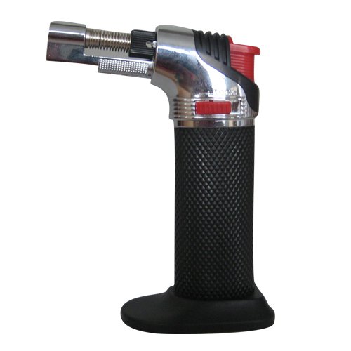

  • Posts: 7934
Re: AC30 CCH help
« Reply #15 on: January 25, 2012, 05:55:38 pm »
Faceplate paint ............... yes that is a problem
also with some duct tape as protection you must use only one or two drops at a time
no, too complicated and unsafe ................. :dontknow:
if the faceplate is in metal you can try (with attention) to use a micro torch like this
to hot the cone, but if the faceplate is plastic .............. isn't a good idea
Kagliostro
