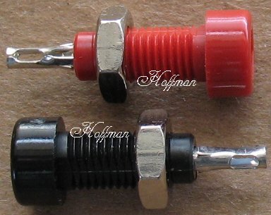

If you have an external bias pot, use these test probe jacks
I sell tons of these, so lots of people are using them
You use one black and two reds in a two power tube amp
You can even install them on cathode biased power tubes to check the voltage drop across your cathode resistor

I believe i bought some from you a year or so ago. I liked them because they were smaller than what i was getting at Radio Shack.  They take up very little rear panel space unlike the bigger test probe jacks
