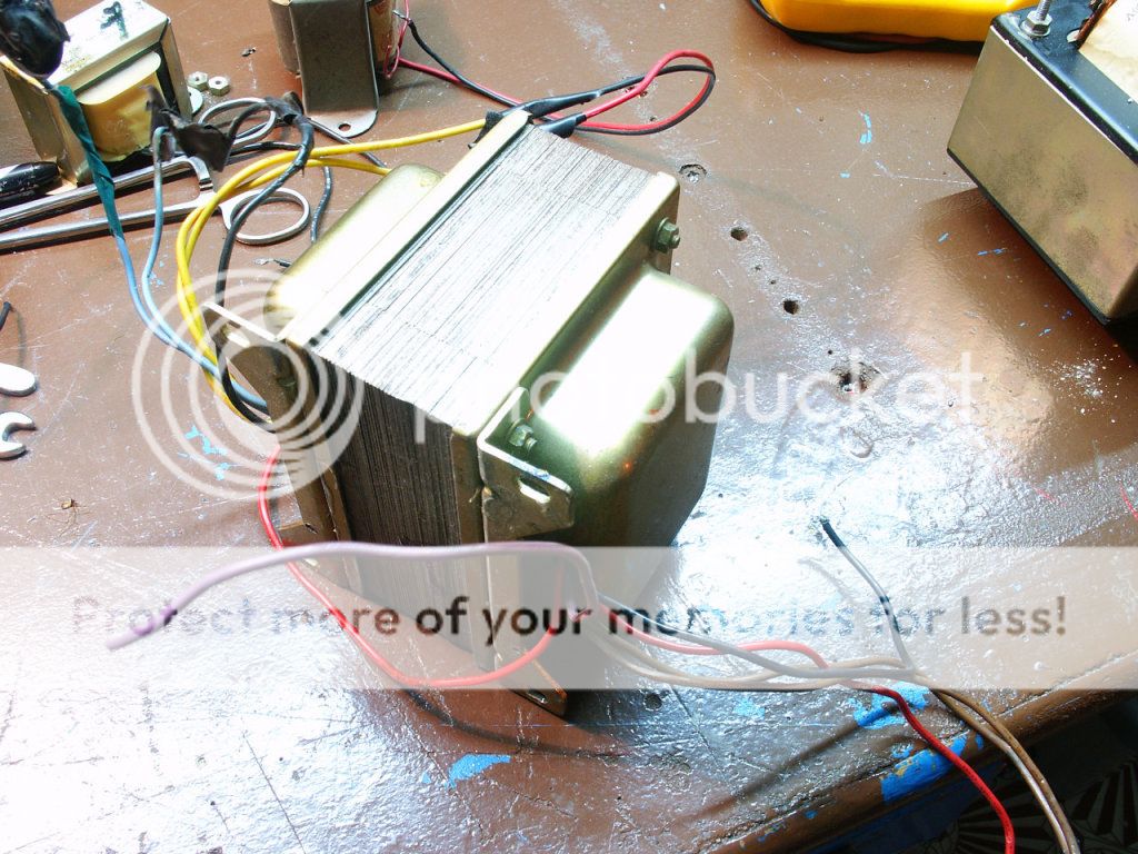

I am tring to fix after along time on the shelf my Guyatone GA 1000 head i remember that some smoke came out of th PT.
I have some spare PT all unknown and without identificaition but i remember this one coming from a guitar amp of same rating(100W) and tubes (4 6l6)
Leads coming from one sidea are soldi colors:
Blue
blue
yellow
yellow
black
form the other hole come out solid:
red
red
brown
brown
purple
black
Can some one help identify the wirings for this unkown POWER tranny? or at least some one can link me to a step by step or well explained tutorial for identifing the leads with a multimeter and or variac?
searched long time in the years info over the internet for the guyatone GA - 1000 head but cant find also any schematic on the web some one has a link or something?
will 3  47Mfd caps tied togheter on the negative pole work as replacement of the original 50+50+50 MFd ?
Thanks for reading and Cheers.
(the first 4 pics are of the replacement "unknown" transformer.. the latter one is of the old original PT of the head just for documentation :))
http://i716.photobucket.com/albums/ww170/psychedelicwarlord/PICT0813.jpg
http://i716.photobucket.com/albums/ww170/psychedelicwarlord/PICT0812.jpg
http://i716.photobucket.com/albums/ww170/psychedelicwarlord/PICT0811.jpg
http://i716.photobucket.com/albums/ww170/psychedelicwarlord/PICT0814.jpg
http://i716.photobucket.com/albums/ww170/psychedelicwarlord/PICT0815.jpg

Blue
blue
yellow
yellow
black
I'm sure those are primary wire . With ohmeter test lead on the black wire , IMO the black is the common.
1- Take mesurement from the one blue ; ........ohms
2-                                       other      ; .........ohms
3-                                        one yellow;..........ohms
4                                        other yellow; .......ohms
Tell us the result .
__________________________________________________
What I think ;
The more ohms between the black and the other wire mean this for a 240 volts.
Little less ohms ; 220 volts
Less ohms 120 volts
and less is for 110 volts
After that , you can put few AC volts ( 10 to 24 ) between the black and the other wire you need maybe a 220 if you are european ?
With this small AC volt , you can take some AC mesurement on secondary side to find wich wires are B+, Heater  ......
Good luck

« Reply #2 on: April 17, 2012, 05:24:04 pm »
Black > any yellow =0,3
Black > any blue = interrupted
yellow > yellow =0,3
blue > blue = 0,2
Any blue > any yellow = interrupted
sure the PT is coming from some unfixable EU wreck.
so as you say i have to figure that black and one of the two yellow are the  two mains 240 or 220  right? and what i have to do with the other yelllow? :)
but i argue that readings of 0,2 - 0,3 ohms seem to me very low and also is strange that blue between them show continuity and between black not..
sure i will put some 12 ac on the primary once identified and take readings so in proportion of the voltage applied i can figure the other outputs am i right?
but just let me ask two things: if you can check the pics you cans ee the original PT has also a 60v out will i be able to get it if not from the socondary outs from one or half of the unused primary?
and about the caps dp you think coupling 3 47 mfd by the grounds in substitution af the  50+50+50 originals?
i know the ripple thing but just for firing it up and seeing it working after that i can order some better caps.. i also have some other trannies that i ll do better use in some kit thantaking dust on the shelf. :)
i really thank you for the help.

ok i've taken the remaining readings:
red > red 85,6
brown > brown 6,7
purple > one red 49,7
purple > other red 26,2
black > purple 6,3
black > any brown interrupted
black > one red 44
black >other red 42
i also checked all the wires from the other side to this side and all are interrupted continuity (this is good sign :) ?)
i paste the previous readings of the previous tested side:
blue > blue = 0,2
What you think Strat ?

With your mesurements i can say that your transformer primary is the black with one yellow probably for your eropean wall outlet voltage.
The two blue are for Noth America voltage ?
In both case you have to put some low voltage ( ta save your transformer in case of wrong winring ) to do some voltage test.
Applied ,lets say 12 AC volts , at the black an one yellow and mesure what you have on the other side of transformer ; the secondary.
Do these test   with each primary wire.
1- Black and one yellow
2- Black with other yellow
3- Blue and blue
Each time you have to take some mesurment at the secondary, you have to do 3 test, like I write before.
_____________
The secondary of your transformer with your mesurements is ;
1-Two  red  wire is for B+ , to solid state rectifier
2- Black wire is B + center tap
3- Purple is bias voltage
4- Two brown wires are for tubes heater
DON'T FORGET like I write , a low voltage test must be done to be sure. Those test are very easy to do but not esy to explain by e-mail. Be sure you  know what you do to not burn your Power transformer.
_________________________________________________________________________________
----tubehead99
Answer;
Yes this is normal , secondary and primary are electricaly separate, interrupted
