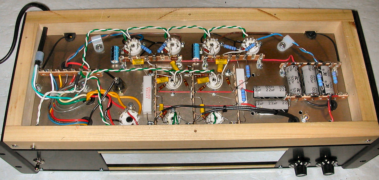

Why not Doug's Stereo Guitar Amp with 6v6 instead of el84 ?
It is well documented, there are schematics, layout and photo documentation
http://www.el34world.com/projects/StereoPreAmp1.htm
http://www.el34world.com/projects/StereoPowerAmp1.htm

Is there actually a layout? Doug's page says not, because it was wired point to point.

The preamp has a layout
about power amp you can use the photo as a layout
