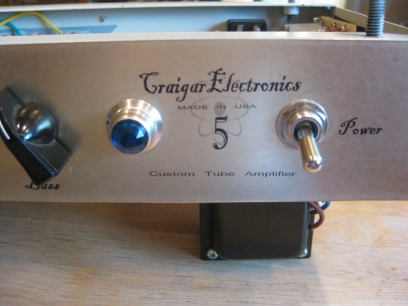

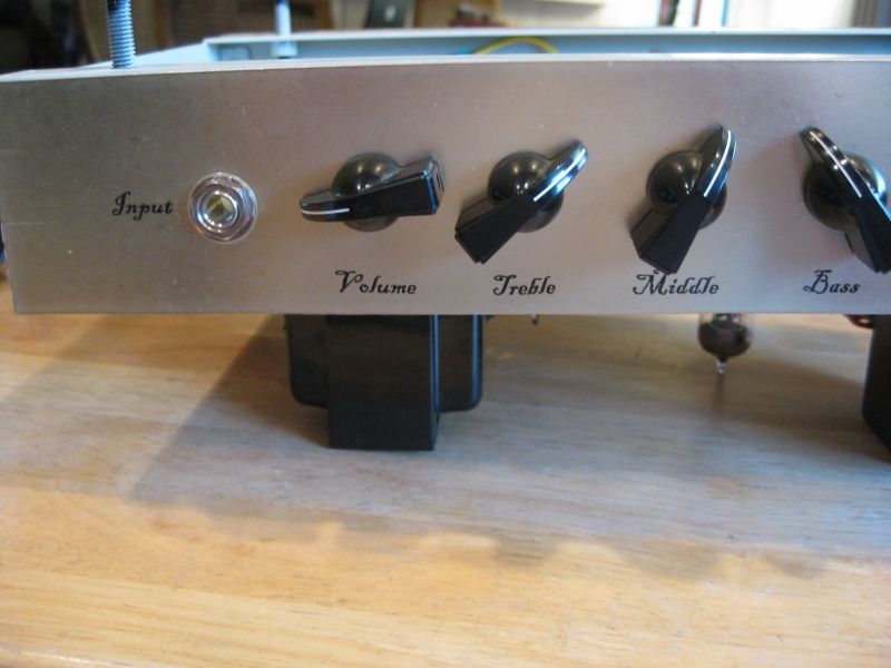

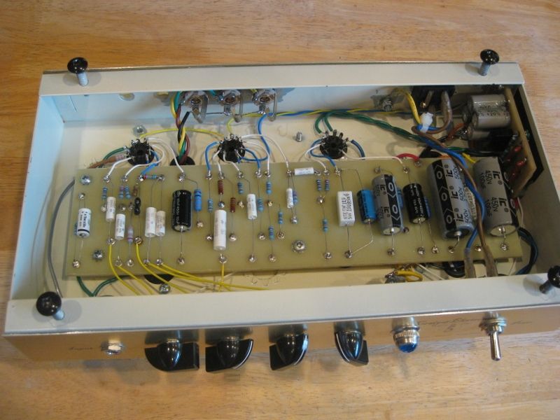

Just wanted to share - for those who own a Blackheart 5w and wanted to do "something else" with it.  Used the trannies, chassis and a few bits and pieces off the Blackheart (IEC power jack/fuseholder, power switch) and I think about $50 worth of parts from Doug.
This one is based on the Marshall 5w.  Sounds awesome for low volume clean, nice natural compression even at lower volumes, and of course it growls very nicely when pushed.  The trannies only get warm, so no issues adding another 12AX7.  The preamp tubes have a DC supply for the filaments.  I utilized the unused 5v tap for the pilot light.  I have the schematic and would be willing to make a layout in ExpressSchem if there's interest.  Maybe there's already a layout floating around out there I don't know about  :icon_biggrin:
The faceplates are an anodized aluminum door kickplate from HD, I made a set of waterslide decals for it, and sprayed Polycrylic over it to finish.
I'm going to make a combo cab with a single 10" speaker for it.    I hope you're all having a great summertime!  Cheers!

Looks great Craig as your builds always do however I look forward to hearing your playing more than the amp.

nice! very neat wiring.

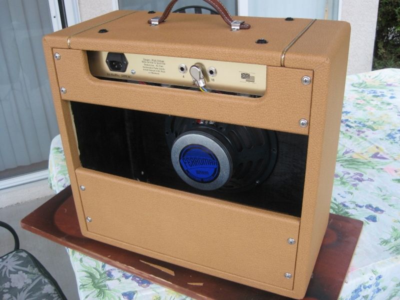

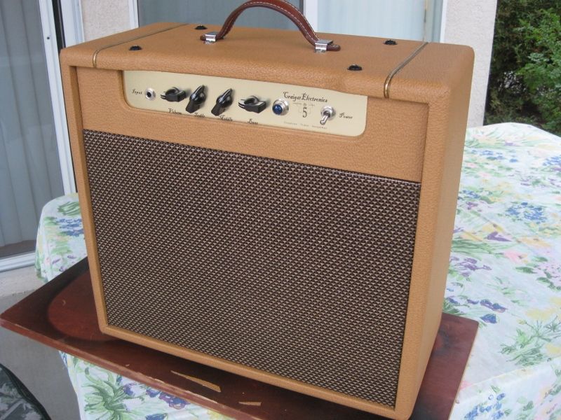

« Reply #23 on: July 25, 2012, 10:37:03 pm »
got the cabinet done, I'm using a weber 10F125.  Ready to have beer spilled on it  :icon_biggrin:
I'll try to get some recording going on soon with it as-is before making any mods.

« Reply #31 on: August 18, 2012, 11:28:47 am »
Finally had a chance to read the entire thread that Lyle started.  Being that the bottom-line consensus is that all we are accomplishing with his mods is to give more useable range to the EQ, trim a little fat off the bass frequencies, and unleash a slight bit more gain, I figured I'd set out to make a change or two at a time.  I mean, what the heck, I reckon it's easier for me to mod this thing than one of Marshall's PCBs, right?  :icon_biggrin:
Here's what I came up with:
1)  Changed input (R20) to 1M, no RF blocking cap.
2)  Installed a switch to toggle between (C8) .68uF and 4.7uF cathode cap biased with 1.8K (R18) - much better with the .68uF, and the switch gives the option to fatten it back up a little.
3)  Changed 220K (R7) to 470K, removed .022 (C13) on vol wiper, and removed 1M (R9) voltage divider.  (No real noticeable difference that I could tell after making this change.)
4) Added 120pF bright cap to volume pot (I may remove this later - I find that upper ranges of the treble pot is just too spiky with the tele, but haven't tried humbuckers with it yet, so the jury's out on this)
5) In tonestack changed slope resistor (R28) to 47K and changed .047 (C20) to .022 (now this REALLY helped bring out a wider range on the tonestack and may be all that's necessary for someone to do to their Marshall 5.)
6) 68pF fizz cap across 470K (R26) at EL84 grid.
Before I made these changes, I did have a chance to record with it.  I got some really nice tracks with a moderately crunchy rock tone, so I'll do some more recording with it hopefully today or tomorrow and see how these tracks sit together.
