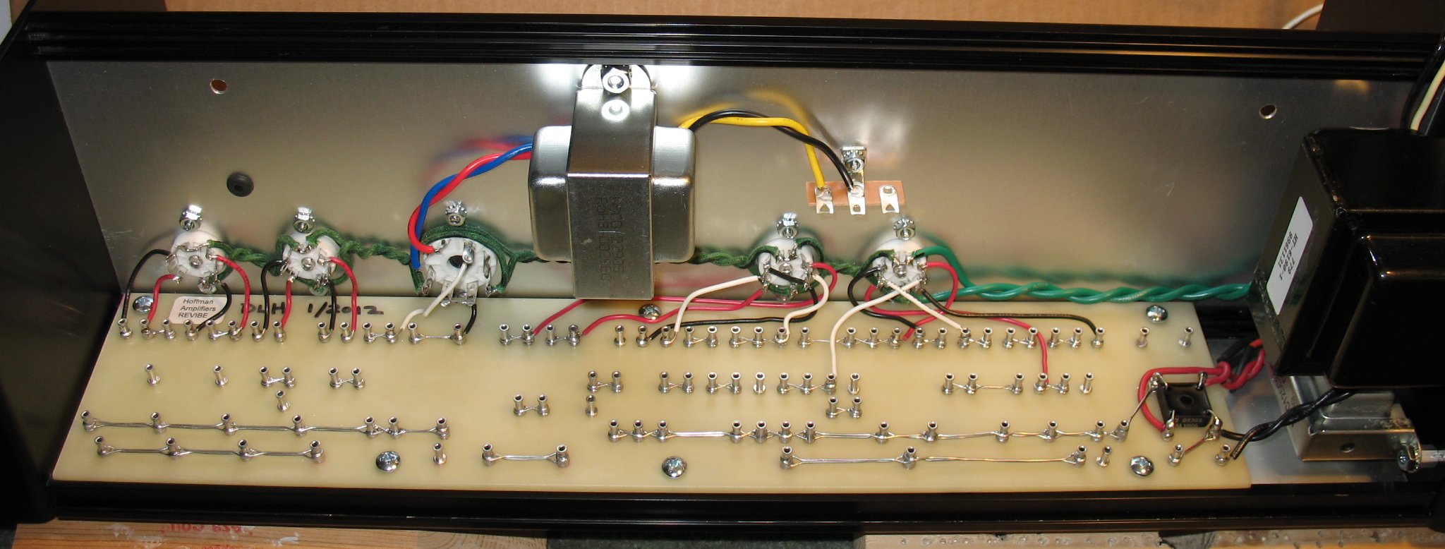

Jeff, You add your parts to the board first and then wire up last?
I wire up the board in the chassis and add the parts last.
Just curious if you find it difficult to wrap wires around the lugs with the parts in the way?
Doug, you rascal !!!!!    :l2: :l2:     I started laughing when I read that.
Sometime waayyyy back, I saw a populated layout board that you had done and figured you populated the board first and then wired it into the amp.  So,  I got the idea from you!
 :dontknow: :icon_biggrin:
Anyhow, yeah that works fine and it's not been a problem wrapping wires around the lugs that way. I just use small needle nose pliars. No issue there.
I am not sure where or when that was?
Anywho, just for the record, I always install the board in the amp, do all the wiring and then add the parts last.
Just my method, whatever works for you is good.
You have really got me chuckling with this one .............
Always refer to the current Hoffman Library of Information!   :l2: :l2:
It's a marvelous source of information.   These pics are where I got the idea that you populated the boards first.  :grin:
With respect, Tubenit  :icon_biggrin: :icon_biggrin:
Ah ok,
I can see how that would be misleading.
Those are the Hoffman board kits that I sold maybe 15 years ago and so I took pictures with the parts on them so people could see what they looked like when loaded. They arrived like that to the customer, but that's not how I installed them.
I never installed them with the parts on the board since it was so much easier to install the board without any parts.
But I found out that many people find it hard to do without looking at a part on the board for reference.
Hard to say after all these years if I have any instructions on how I actually installed the boards at my shop
Another plus to installing the board wires first is that you can clean up all the solder flux spots before you add the parts.
This makes the boards look really nice without tons of flux spots.
The flux seems to pop and spray everywhere as it heats up.
Again, this is just something I have in my brain because it's how I used to do it.
Probably the best info are the build pictures on the library page of some of my projects which show step by step how I build things.

about relay connection don't you think it will be better to duplicate the turret of the contacts as to have an easier way of connection (one turret for the relay pin the other for the connection wire) ?
Doug uses (and sells) a socket for the relay so I don't think that will be a problem?
                Brad     :icon_biggrin:
Re: D'Mars Overdrive Special
« Reply #199 on: September 01, 2012, 04:09:51 pm »
May be I don't explained well what I mean
Quote from Doug
(1) I have added 4 lugs around the relay socket lugs so that I have better points to solder external wires to. Wires that lead to tube sockets, pots, etc are soldered to these extra lugs. It's much easier and better this way, it can be very difficult to solder to the lugs under the relay socket. Note that these extra lugs are jumpered under the board with short pieces of buss wire.
from this page
http://www.el34world.com/projects/relay_switch2.htm
Hope now you can understand what I was meaning
